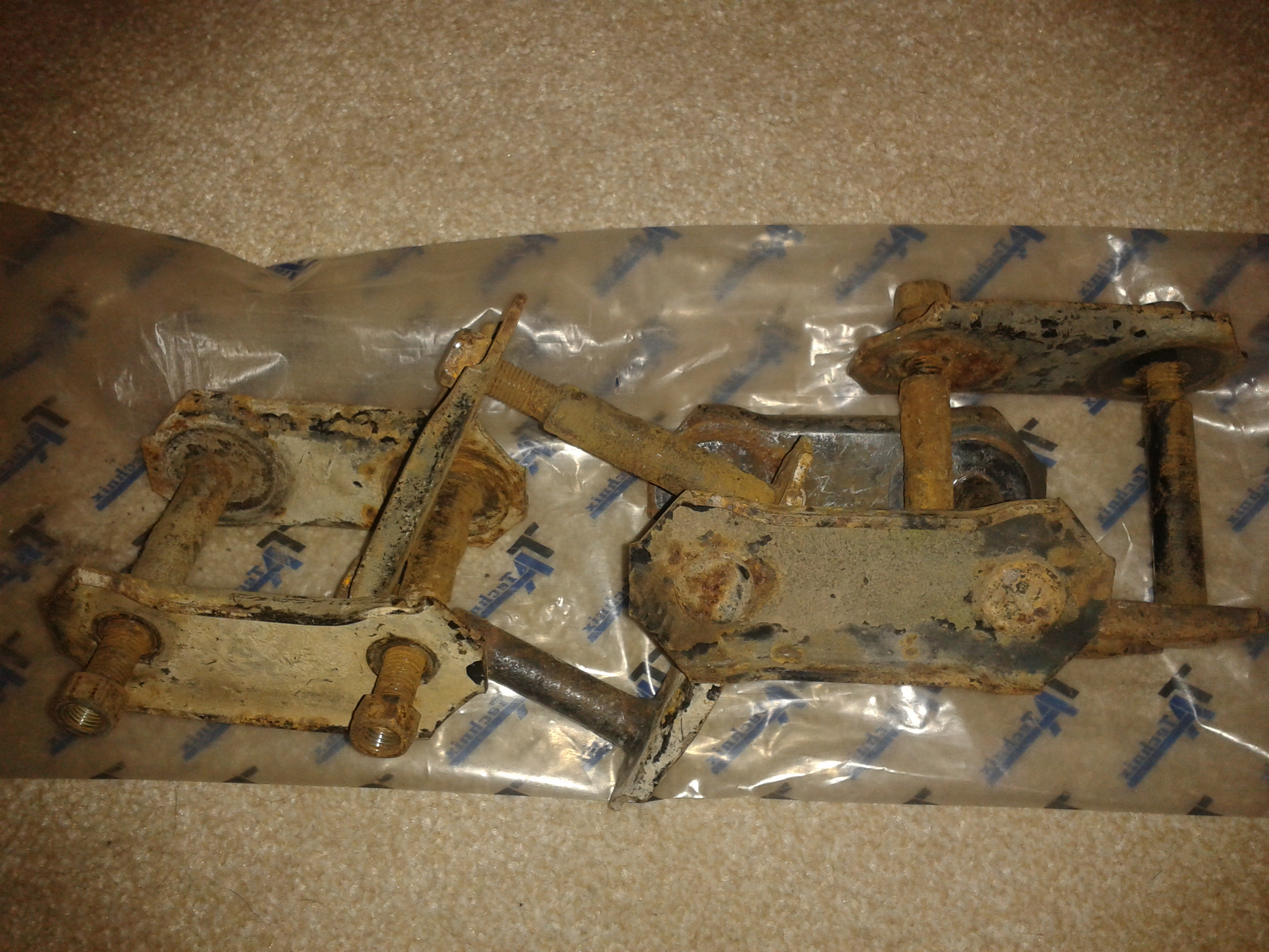

Post by lazy rambler » Fri Mar 16, 2012 5:59 pm
Just picked up a set of stock shackles that a mate had in his garage.
He didn't even want anything for them. :guns:
2012-03-16 17.54.46.jpg (1.53 MiB) Viewed 7873 times

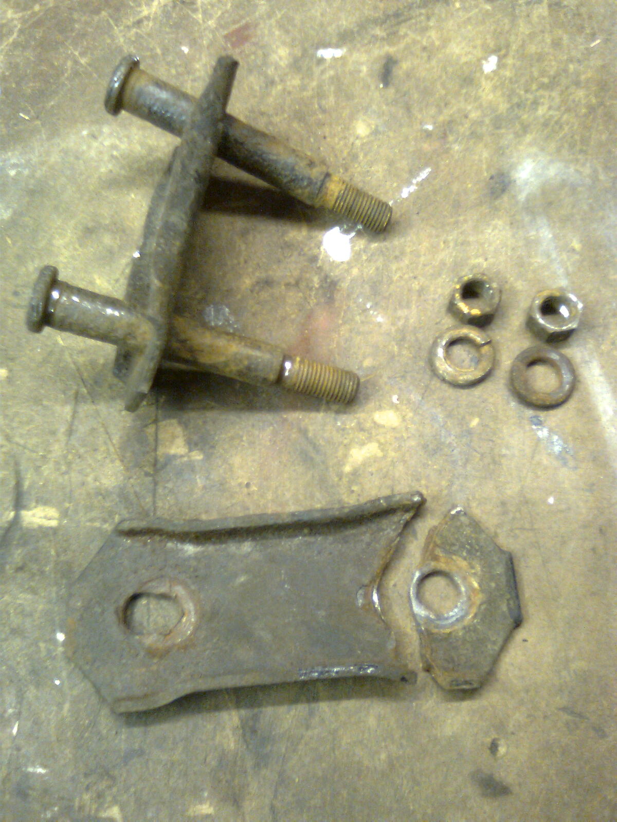

Re: Shackles
Post by Darrell » Sat Mar 31, 2012 11:59 pm
First time I've had one do this.........
Re: Shackles
Post by Darrell » Sun Apr 01, 2012 12:20 pm
Ok ,I know people make there own but the standard ones the bolt/pin is pressed into the side plate and therefore can't turn. The bushes have no sleeve so if you just use a normal bolt with a nylock nut what stops the bolt from turning in the shackle rather than the bush. I see the extended ones :yuk: also have a brace welded from side to side to keep things square. The original shackle pins are also stepped so you can do the nut up tight but not crush the bush. If you just use 2 bits of flat bar and some bolts everything will move about and soon wear out. :er:
I've been down the scappy and got a standard shackle of a bedford van so she's back on the road anyway. Both the springs are still on the van if anyone wants directions (south Oxfordshire)

Post by ianedwards » Sun Apr 01, 2012 12:49 pm
ah but if you make them the same as the originals with the same type of stepped bolts welded so they cant move, you wont have those problems. but you are right i cant see just 2 bits of plate doing it any good.
