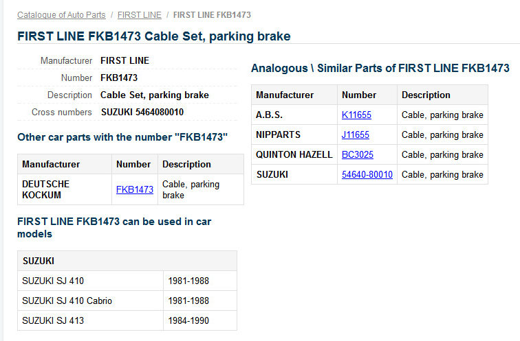

Re: Transfer box handbrake info.
Post by Darrell » Sun Dec 15, 2013 11:34 pm
Bit more cable info
FIRST-LINE-FKB1473-Cable-Set-parking-brake 2013-12-15 23-25-24.jpeg (104.79 KiB) Viewed 45475 times

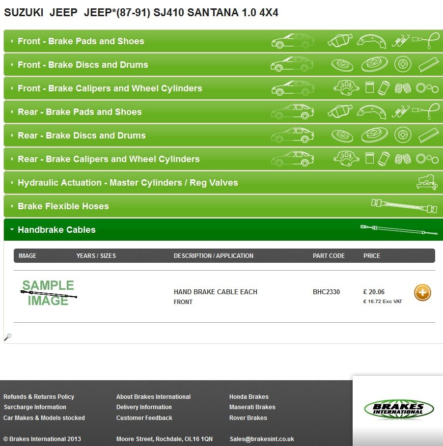

Post by Darrell » Wed Dec 18, 2013 7:34 pm
And .............
Brakeparts-co-uk-Car-Brakes-Calipers-Pads-Discs-Parts 2.jpg (117.16 KiB) Viewed 45733 times
