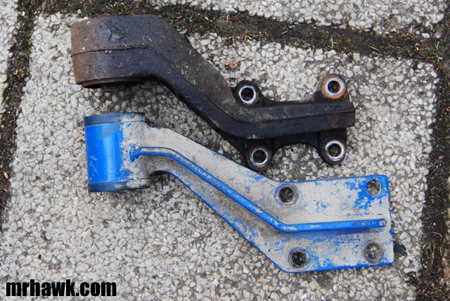

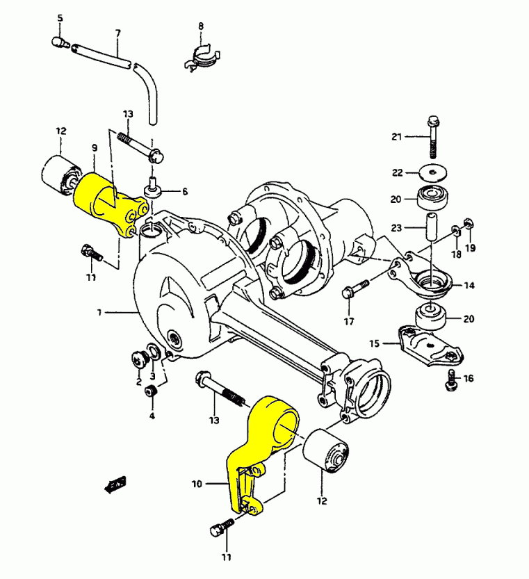

Original brackets shown in yellow on the diagram, dirty casting in the photo.
Calamini paint all there bits blue and you can see it's steel plate welded rather than cast.
