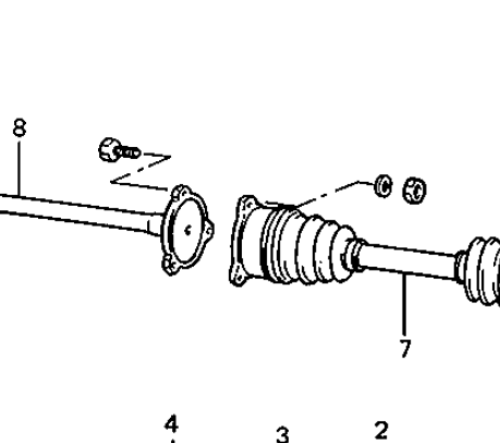

Hi i am fitting a bits4vits spacers on my springs i did back easy but got to the front and i cant get the half shaft 3 bolts undone seem to tight and tries to turn as i undo them any tips on this ??
Re: Half shaft prob when changing springs ??
Post by Darrell » Wed Dec 12, 2012 10:16 pm
2 spanners and give it some!!
http://www.bits4vits.co.uk/springspacerinstructions.pdf
Posts: 11709
Post by ScottieJ » Thu Dec 13, 2012 9:53 am
put it in 4wd and in gear to stop the driveshaft spinning as well ;)
