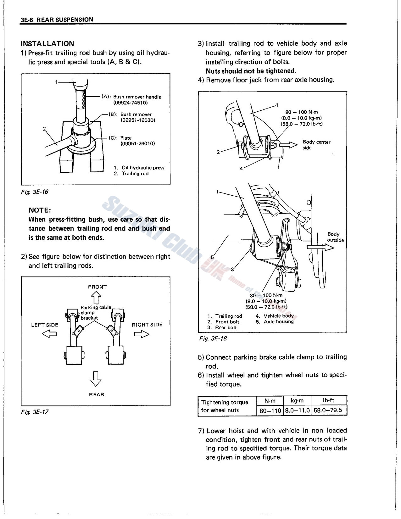

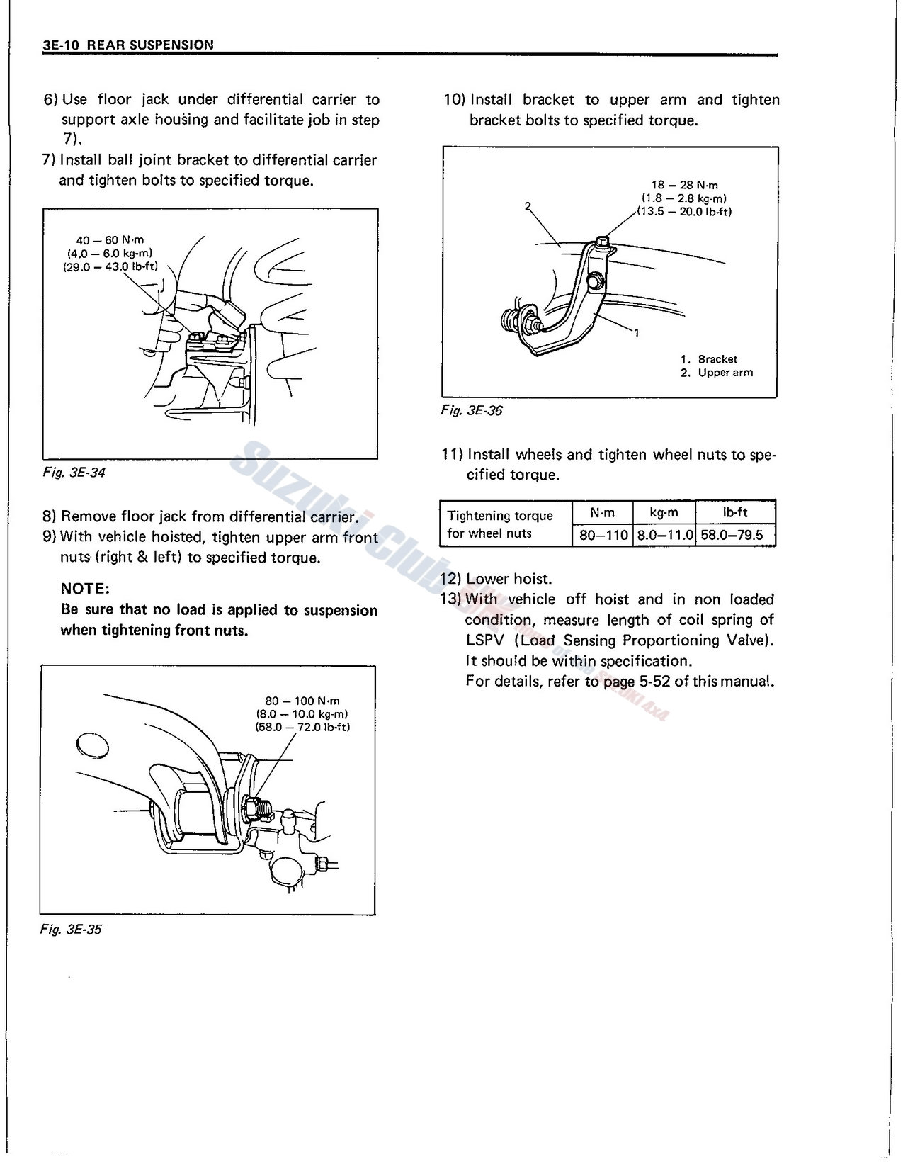

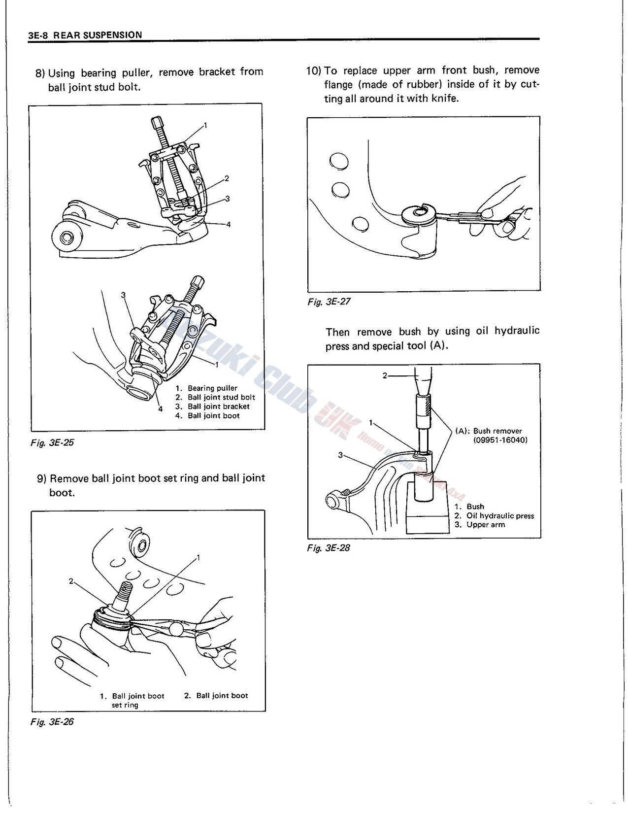

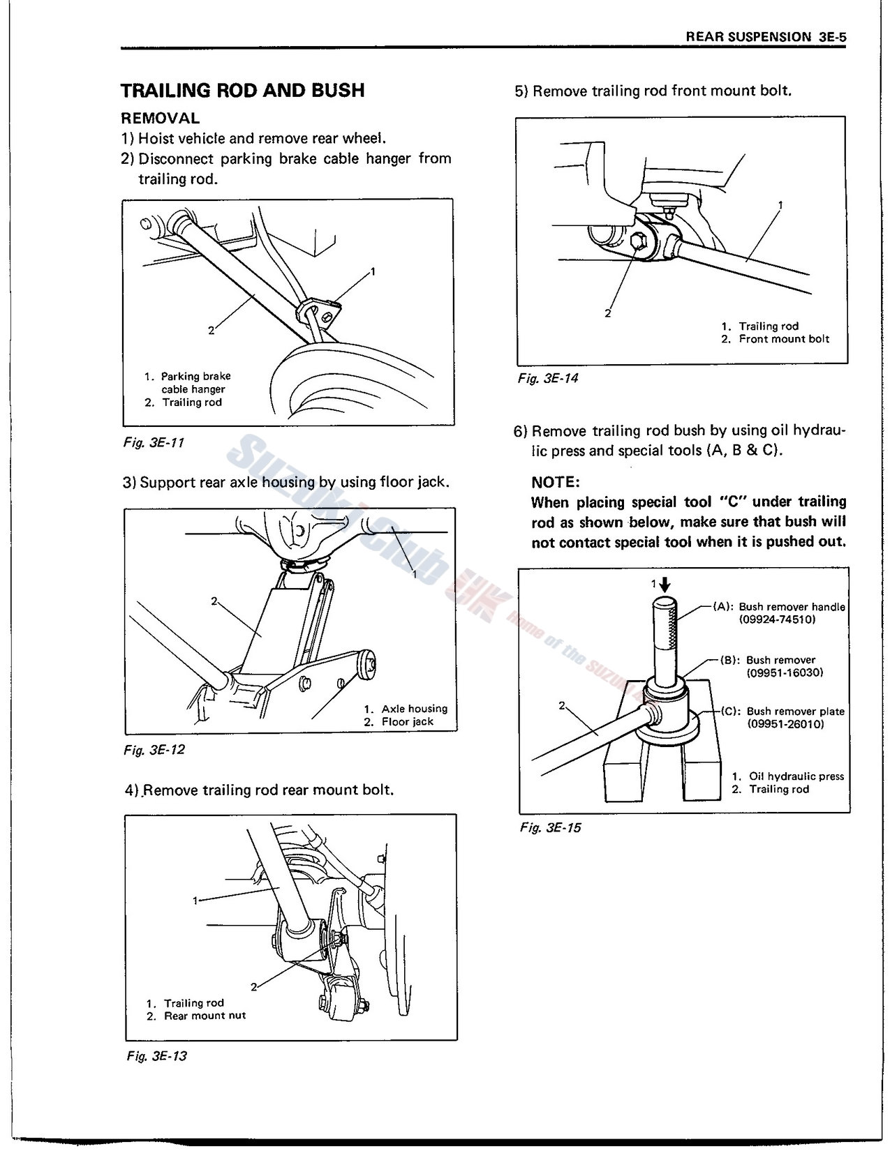

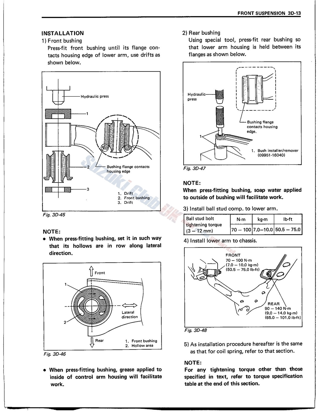

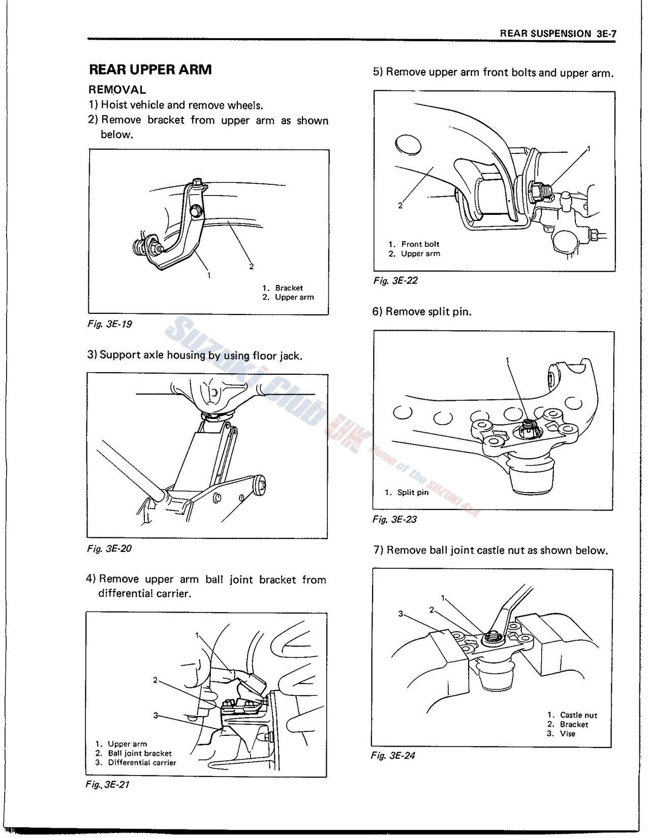

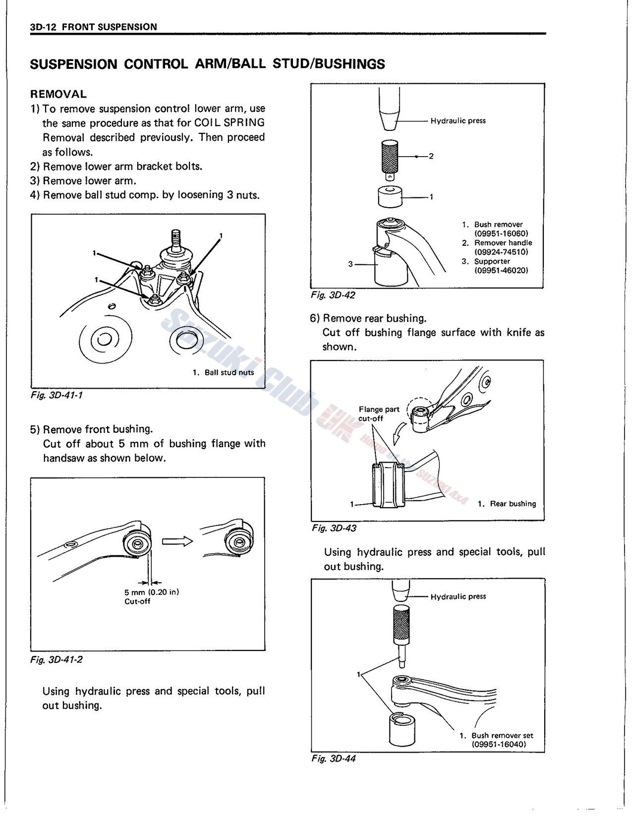

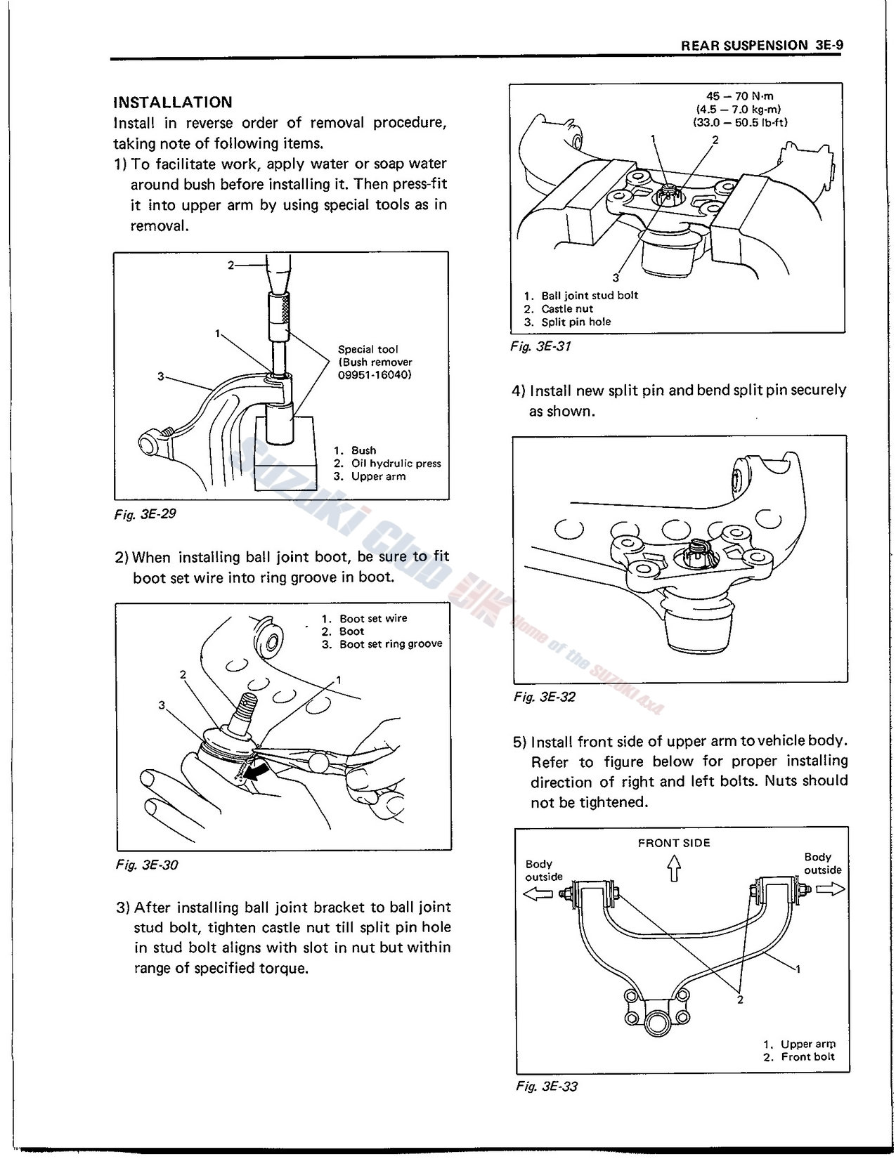

Post by Darrell » Sat May 11, 2013 8:21 pm
Section from the 1994 print workshop manual.
vit bushes 8.jpg (258.86 KiB) Viewed 28807 times
