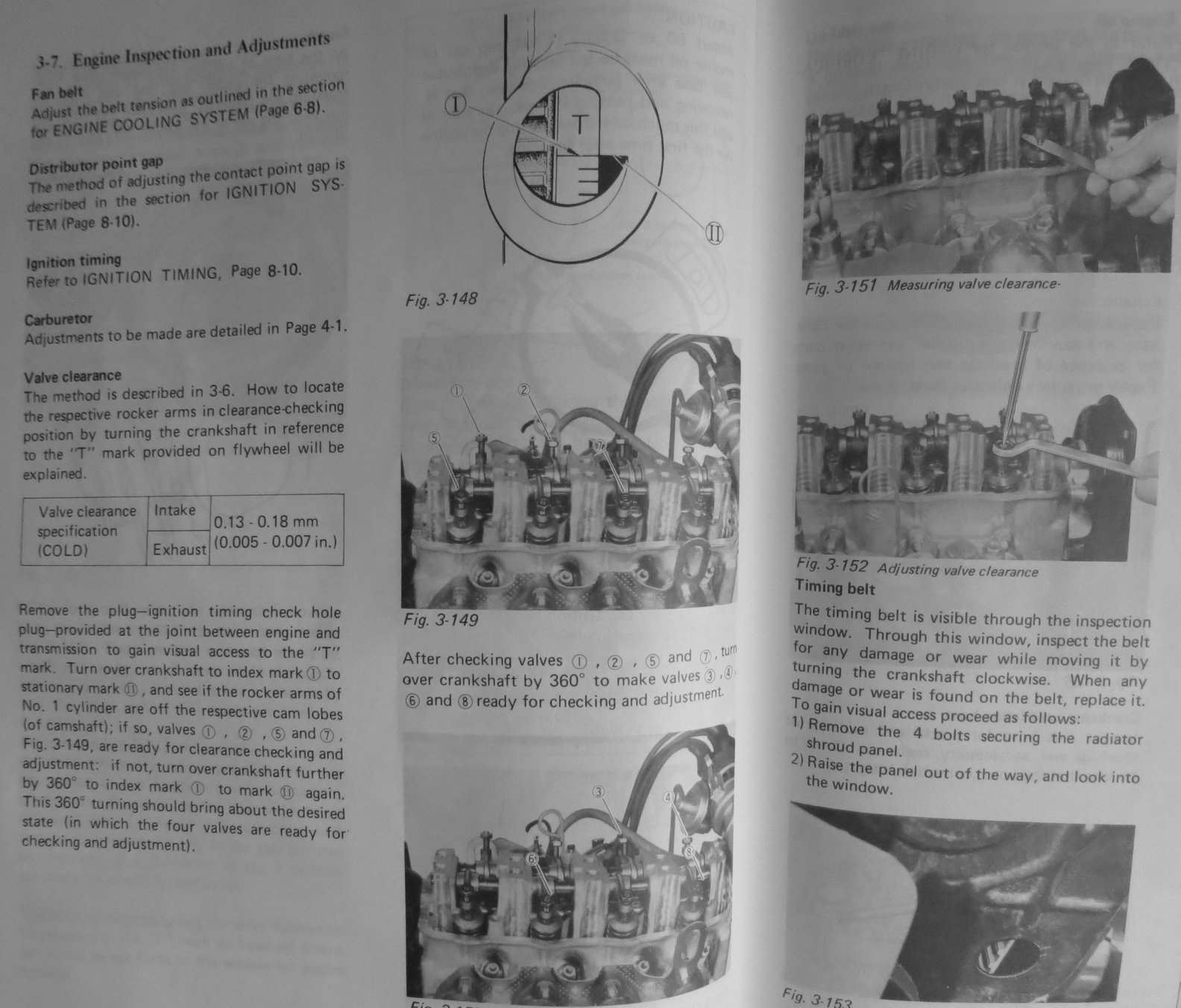

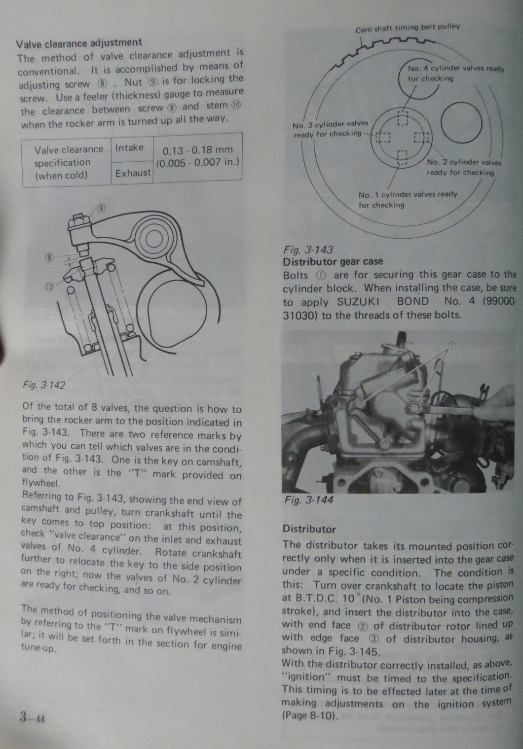

1. to set the tapet clearance, how is this done, anyone got a link, or can describe it please?

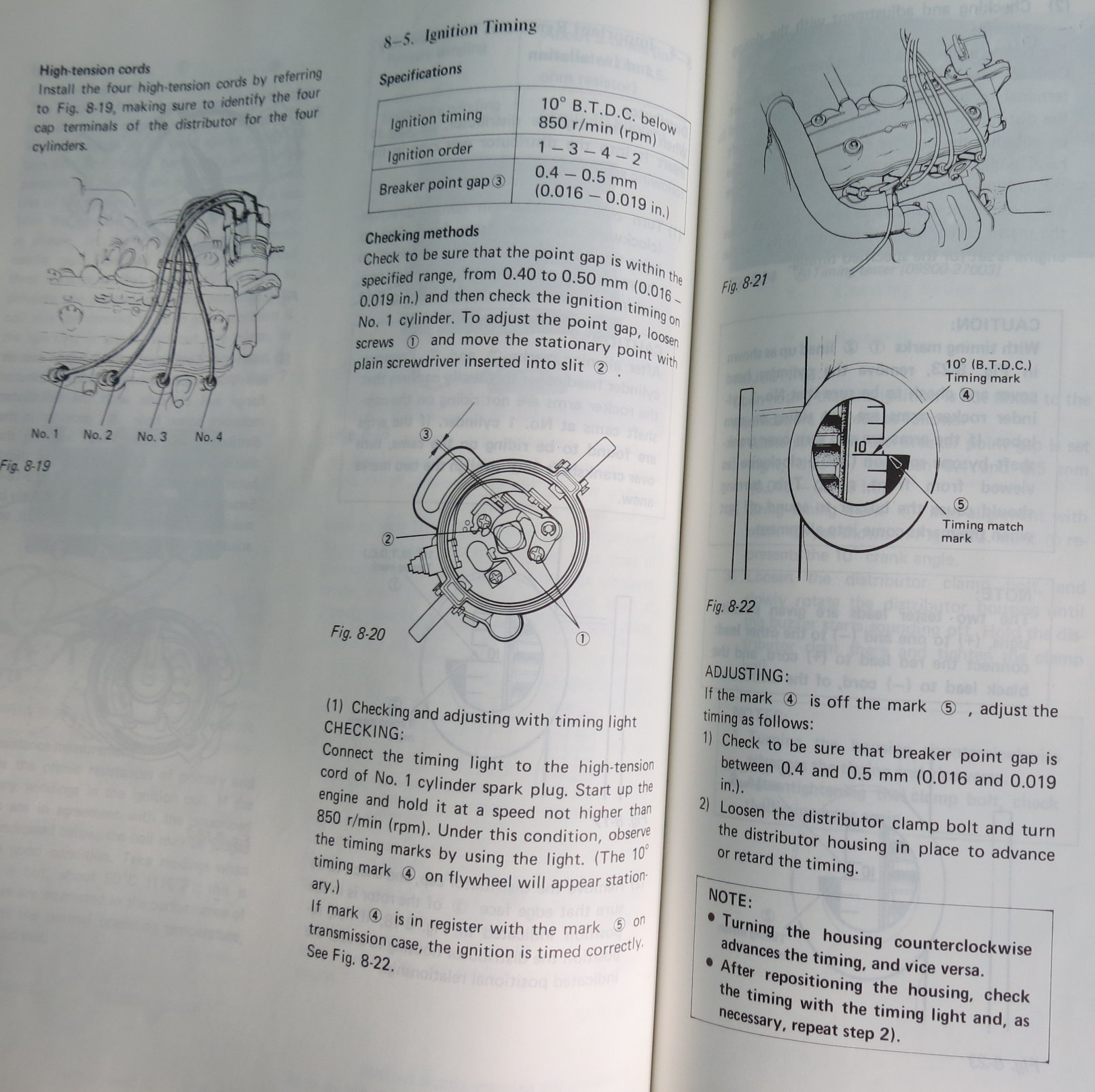

3. I got my numbers mixed up when labeling the leads, and as a result we have electrical timing set up to piston 4, when it should have been piston 1. can I just swap lead number (1 and 4),and (2 and 3), on the dizzy, effectively reversing the firing order?

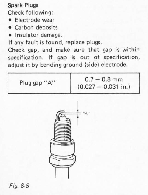

4. I bought new spark plugs, do they just plug in, or do I need to adjust the gap setting, it's 0.9 mm out of the packet

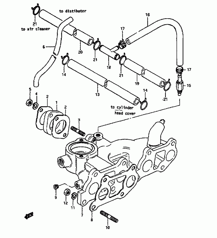

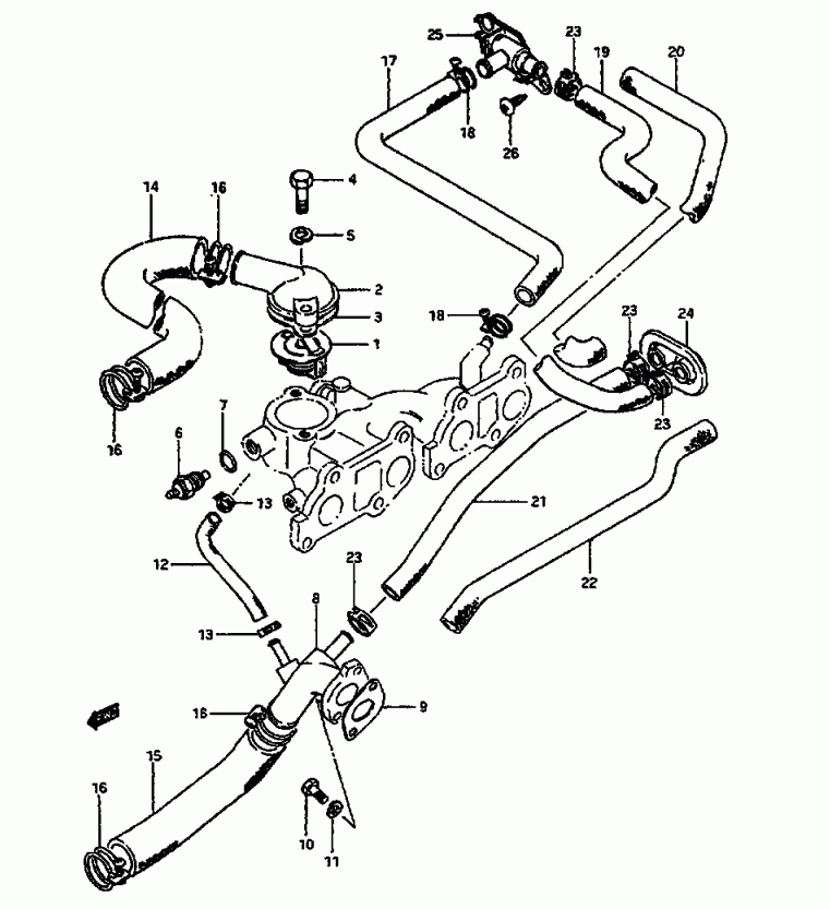

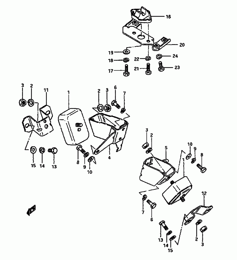

5. who has a built thread with a f10a engine, or sj410, so I can have a look at some pics regarding some of the plumbing up and orientation of engine mounts etc

seting the timing is easy. there is a window (hole) in the gearbox casing that you can see the flywheel and if you turn the engine over by hand you will find the timing marks. search on here for setting the timing. then its a case of removing the dizzy and putting it back in in the correct position. and setting the tappets is easy aswell. turn the engine over by hand and when the cam lobes are pointing skywards put a ring spanner on the nut and a flat blade screwdriver in the slot,crack off the nut while holding the screwdriver still. put the feeler gauge in the gap, wind the screw down til you can just about move the feeler gauge. tighten the nut back up. check the feeler gauge isn't stuck, it should be a bit tight in there. put a drop of oil in them n it makes it easier.

Hopefully that's 4 and 5 covered
- spark plugs 410.png (171.42 KiB) Viewed 6428 times
- engine mounts 410.gif (30.59 KiB) Viewed 6428 times
- engine breather hose 410.gif (40.49 KiB) Viewed 6428 times
- water hoses 410.gif (39.9 KiB) Viewed 6428 times

This is all is says in the workshop manual..

Dammed if I know3. I got my numbers mixed up when labeling the leads, and as a result we have electrical timing set up to piston 4, when it should have been piston 1. can I just swap lead number (1 and 4),and (2 and 3), on the dizzy, effectively reversing the firing order?
