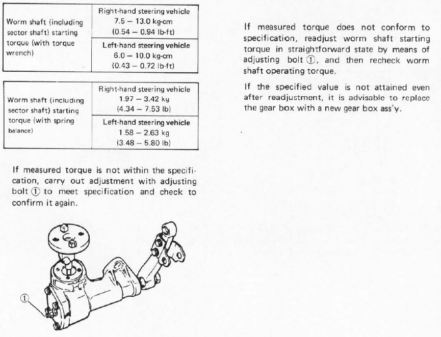

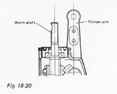

Post by Darrell » Thu Jun 23, 2011 9:07 pm
:suzuki:
st 1.jpg (45.65 KiB) Viewed 54863 times
st 3.jpg (86.47 KiB) Viewed 54863 times

Bit of a noob question.. But what will this fix? Will it fix a bit of play "deadzone" from dead ahead?

Post by Darrell » Sat Jul 05, 2014 11:29 am
Yes.

courior wrote:Bit of a noob question.. But what will this fix? Will it fix a bit of play "deadzone" from dead ahead?
Mine about 2 inches of play in straight ahead position and more on lock position
