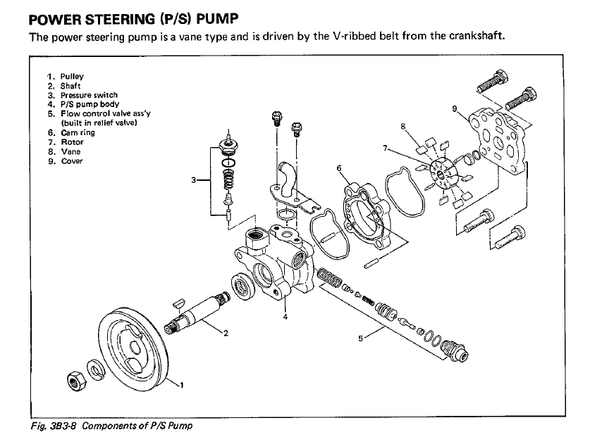

Hi guys, suddenly developed a leak from cap over pressure relief valve? Brass pin sticking out that appears to be broken off. Only just brought the vehicle so unsure as to what or how this operates. Its a vitara 1.6 8v engine and vitara power steering pump. it looks the same pump as used in the guide in the sticky section. can anybody shed some light on this. Thanks in advance Gaz

Sounds like it could be the pressure switch leaking. On an SJ this would be redundant.
A diagram to help point out leak...
