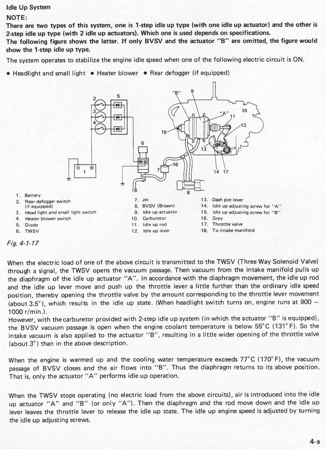

Hi guys just swapped engines on my sj knackered g13B to an ok g13A everything runs as it should,
except when i switch headlights on revs race upto 3000 rpm. any ideas? cheers mike

Sounds like the idle up system needs adjusting.
Re: revs racing
Post by Darrell » Thu Oct 30, 2014 7:38 pm
Welcome to the club :thumbup:
Needs adjusting.....................or just unplug the bugger.
Idle up SJ 413.jpg (256.4 KiB) Viewed 8401 times

cheers guys "removed the bugger" spot on everthing works. MOT tommrow fingers crissed sorry
