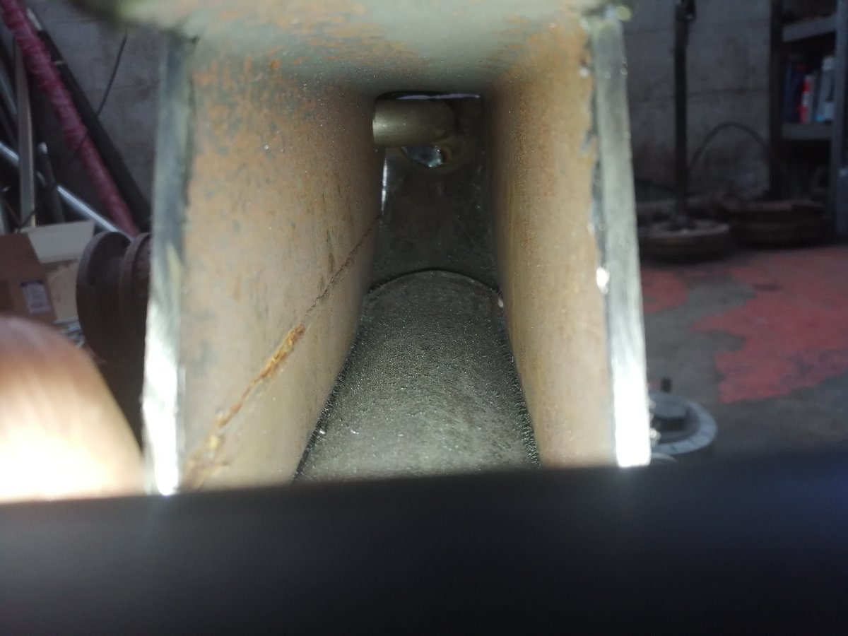

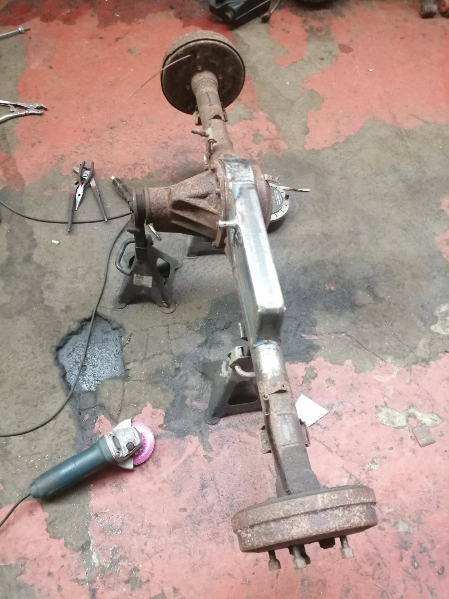

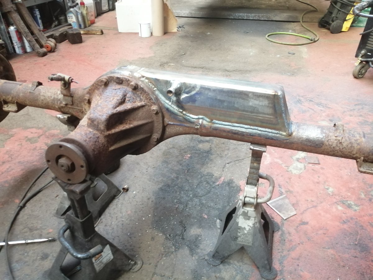

Abit more progress from this morning :weld:
Extended the original diff breather using a 45' and a 90' bends welded up, drilled a hole so it comes through the trussing, then welded it all up

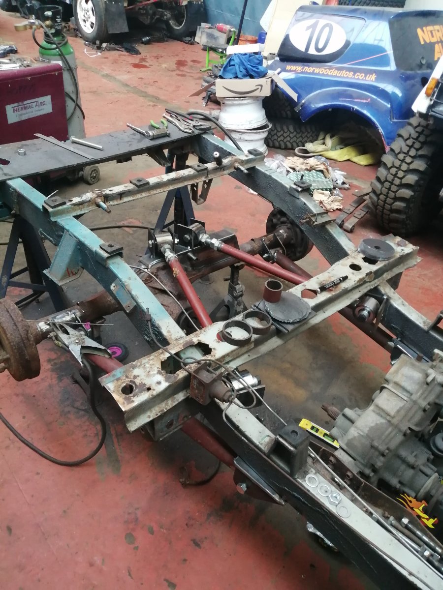

Post by d_r_1989 » Sat May 30, 2020 9:13 pm

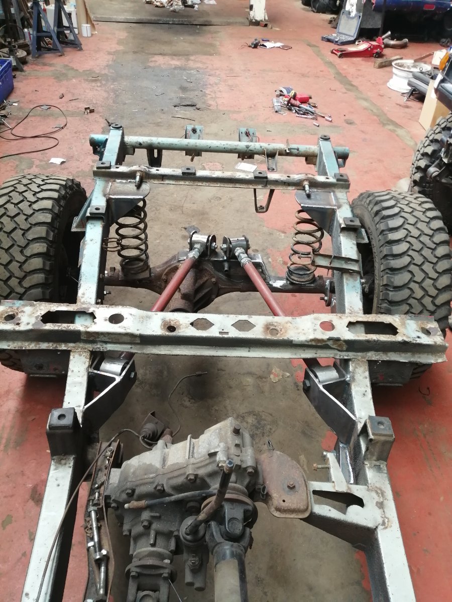

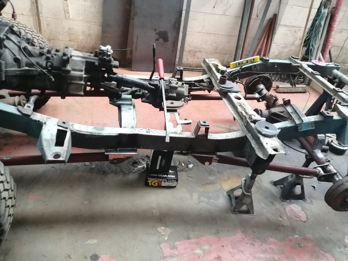

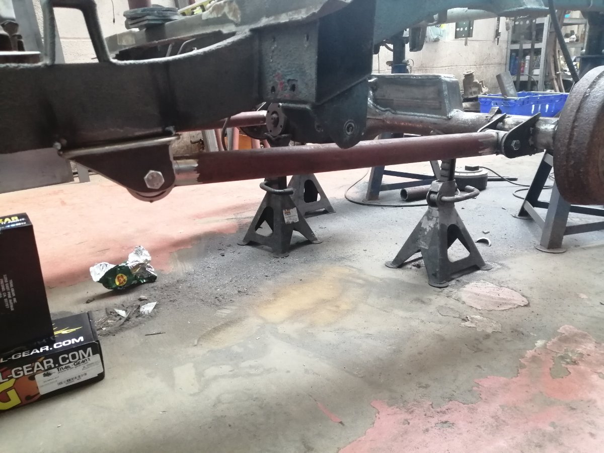

Little bit more of an update, had a busy day today, havent finished the mounts, just tacked in place :weld: Hoping to start on spring perches this week and get it sat back on some wheels

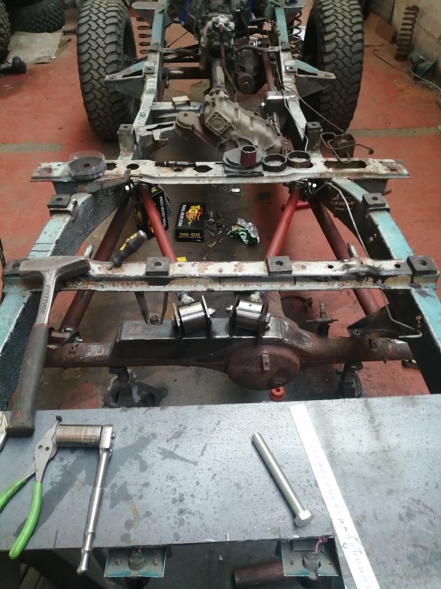

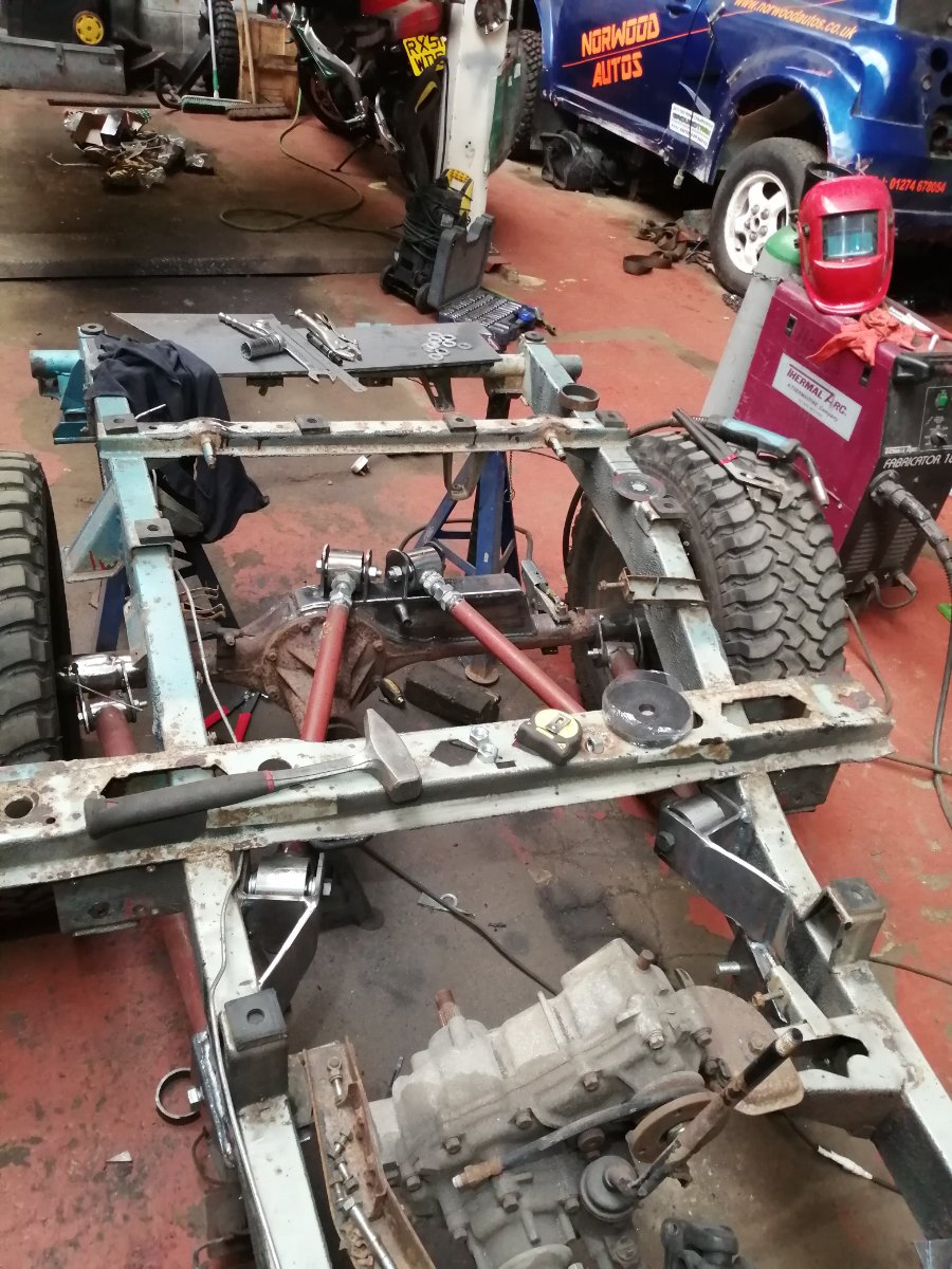

Post by d_r_1989 » Mon Jun 08, 2020 9:56 pm

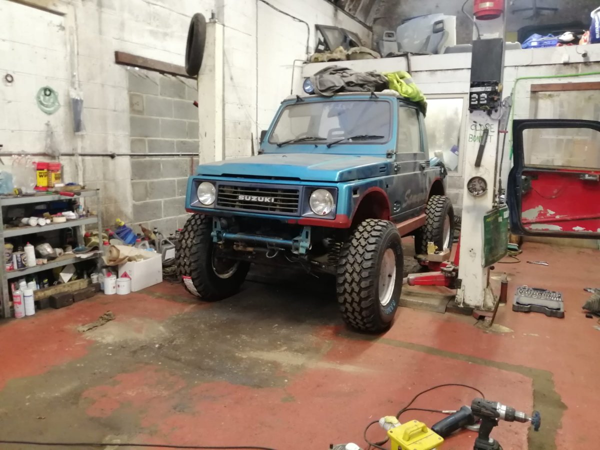

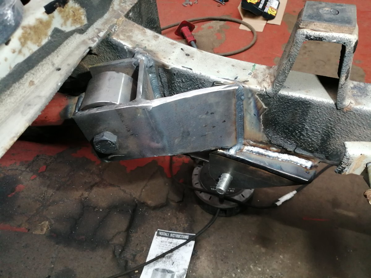

Anofher busy day finishing the mounts. Theyre welded in but still not 100%, need to tie the rear uppers in some more and do the bumpstops.
Getting there though, nice to be back on its wheels aswell. Measured my new wheel base and its nearly 84" now, iv tried ghe body on and it seems to fit ok

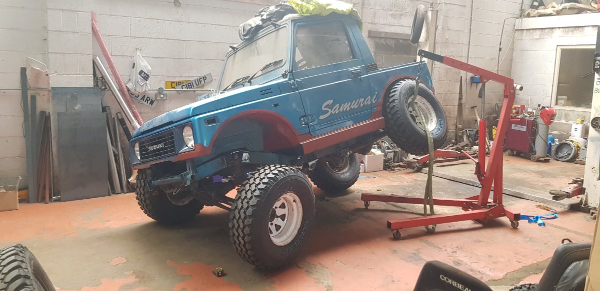

d_r_1989
Posts: 569
Re: Coiled turqoise samurai
Post by d_r_1989 » Sun Jun 21, 2020 12:04 am
Thanks

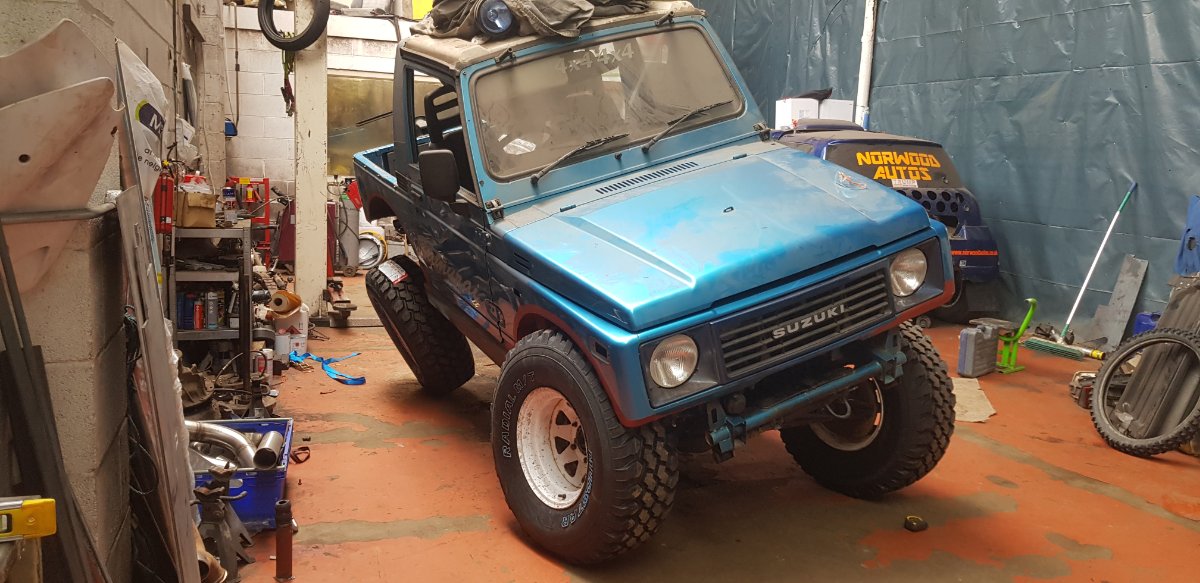

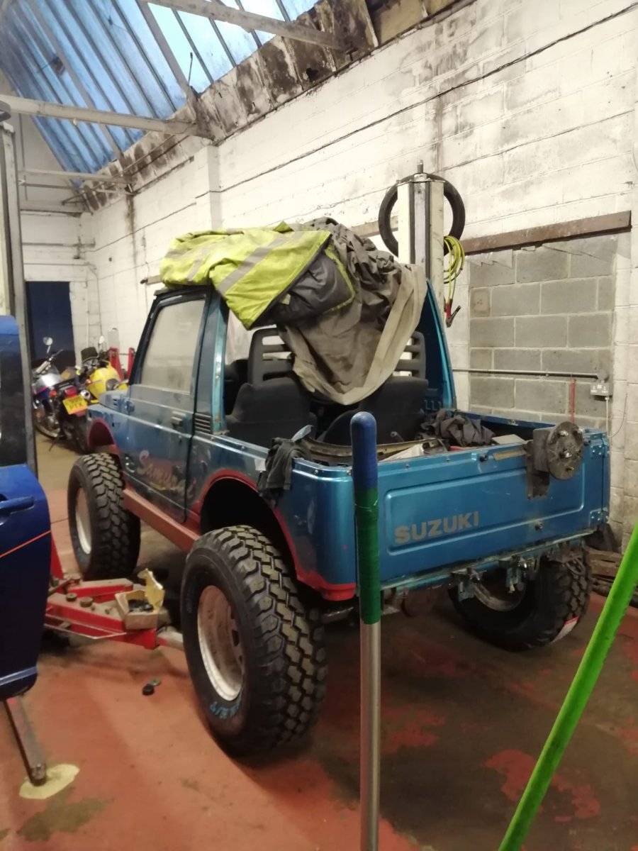

Yes the green sj maybe next inline with some toyota axles

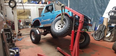

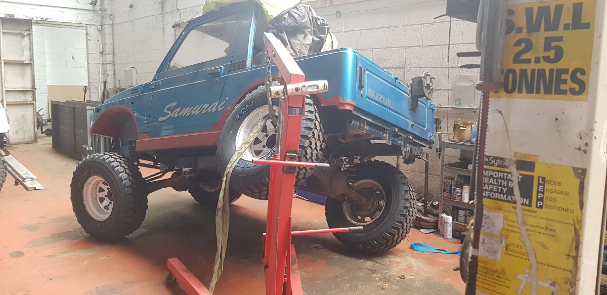

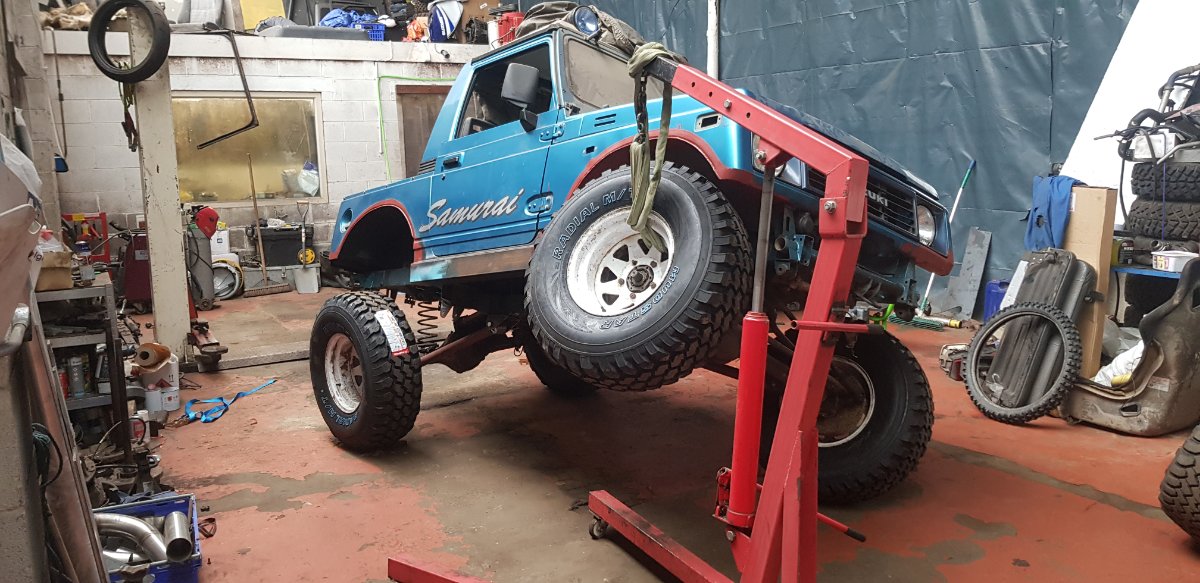

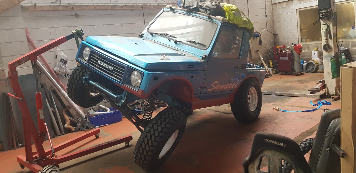

I broke my phone so theres abit of a skip in updates but the body is back on temporarily so i can measure and mock up for shocks. Also have its wheels and tyres on now too. The bumpstops should stop the wheels hitting the arches when the other wheel is on full droop but only just.
Both wheels are 30" (from the lowest part of tyre) off the ground with a little more left to give.

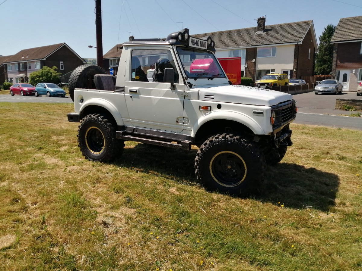

Sat on its 33s its 15mm lower than my white sj which is standard spoa
