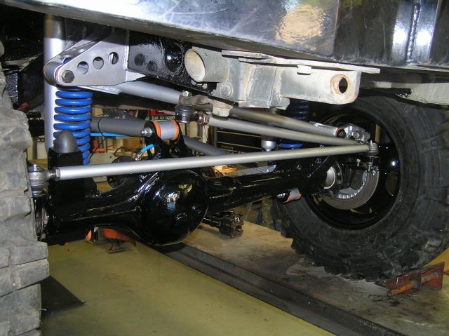

Here's a proper coil conversion.
This is how it's done.
http://forum.difflock.com/viewtopic.php?t=63086
Re: Springs vs coilovers swap
Post by mike harris » Tue Jan 22, 2013 8:42 pm
This is one of the best suzukis in the county.
This how to coil one.

Mike have u thought of doing coils on ur sammy
4” calmini lift kit :)
Post by mike harris » Tue Jan 22, 2013 8:53 pm
Yeh, if I could have it done by the same person who done Paul's, it's truly a work of art. There is no pitch in the diff at any point of articulation, there next to no axle steer either. Read through that build of the coil setup, it will blow you away.
