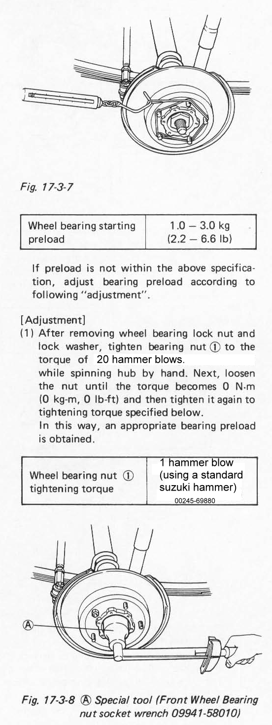

Post by Darrell » Fri Nov 08, 2013 9:20 pm
Re: Front Axle Seals/Wheel & Kingpin Bearings Guide Needed
Post by Anton » Fri Nov 08, 2013 9:44 pm
Darrell wrote:;)
:hahaha:
