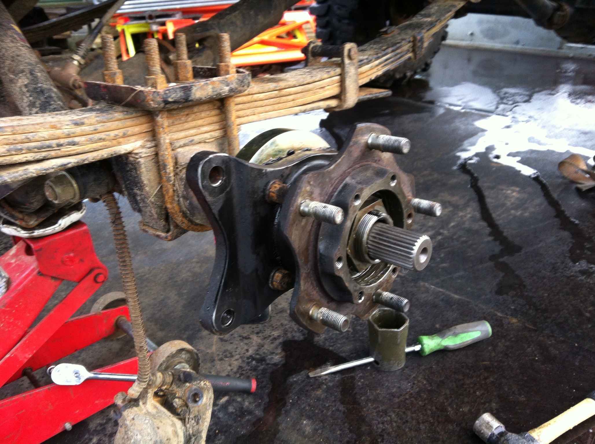

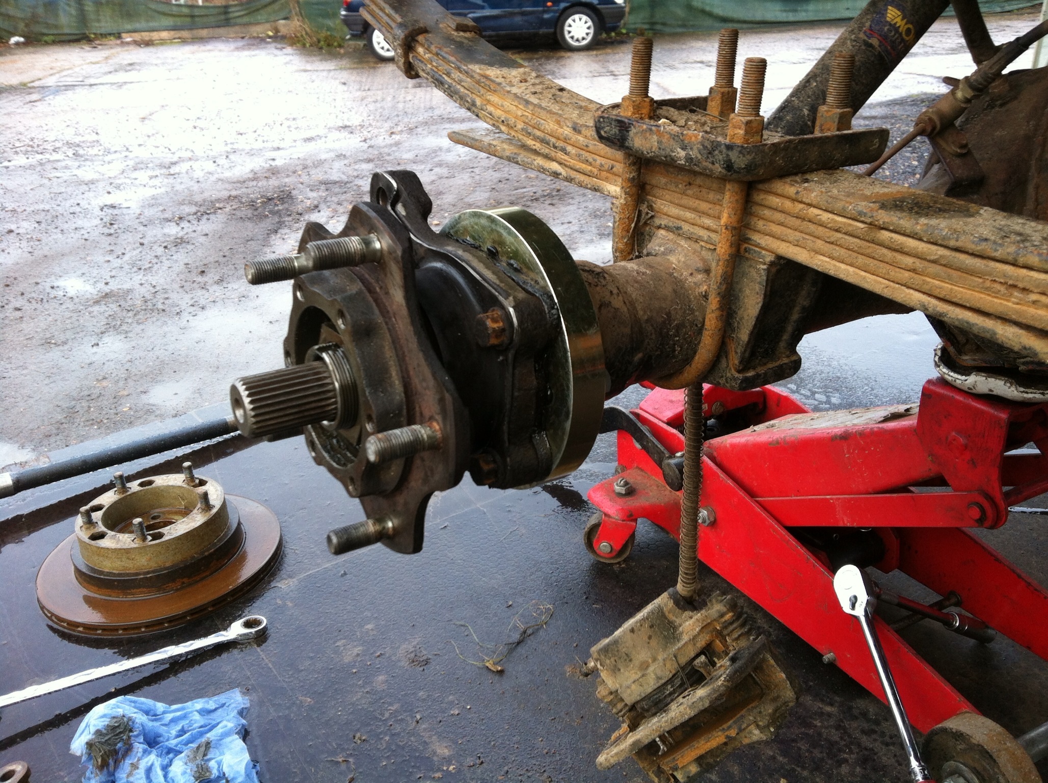

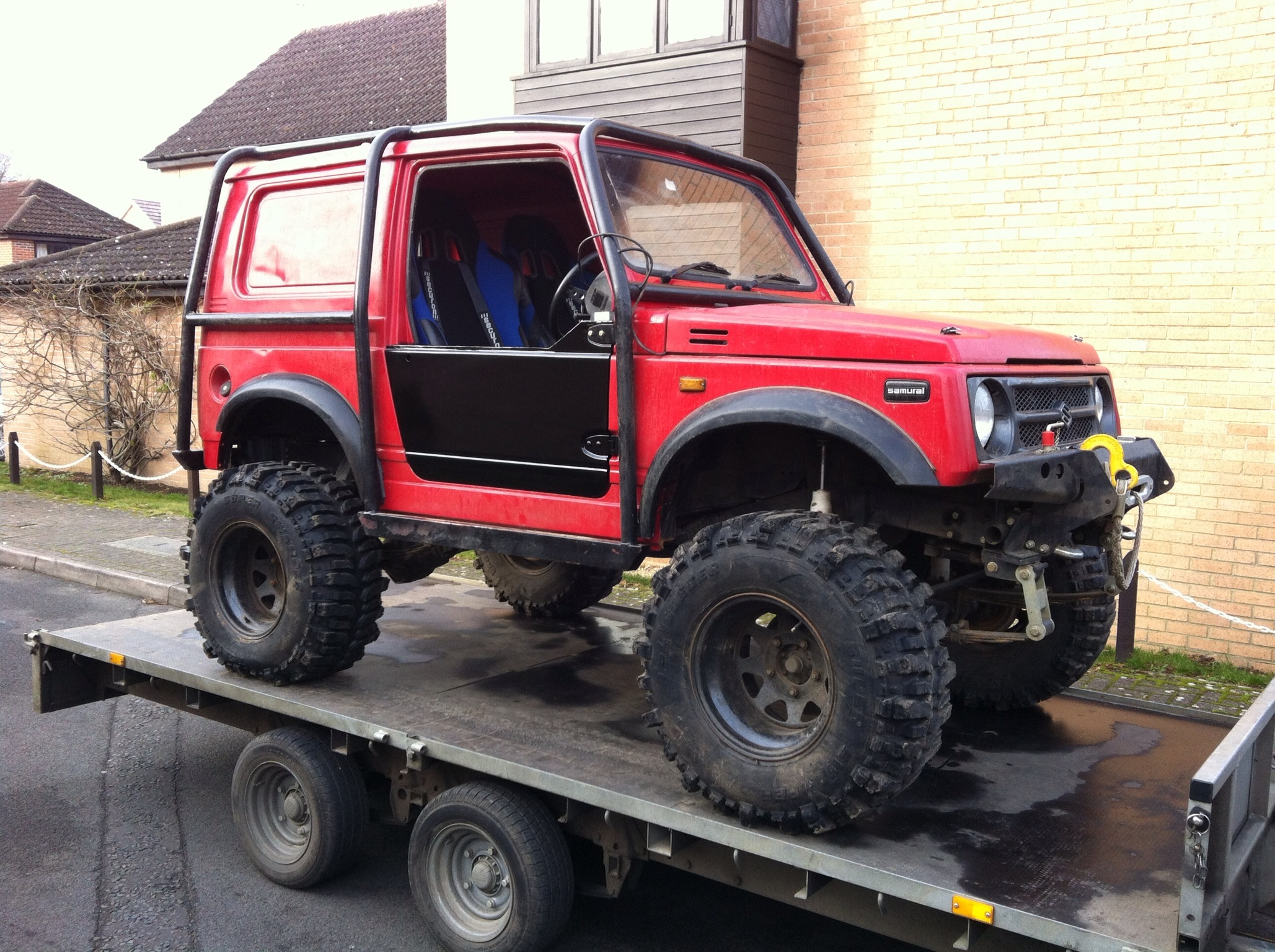

Bit done today
Another pic of the doors cut and some of the fully floating back axle kit :)

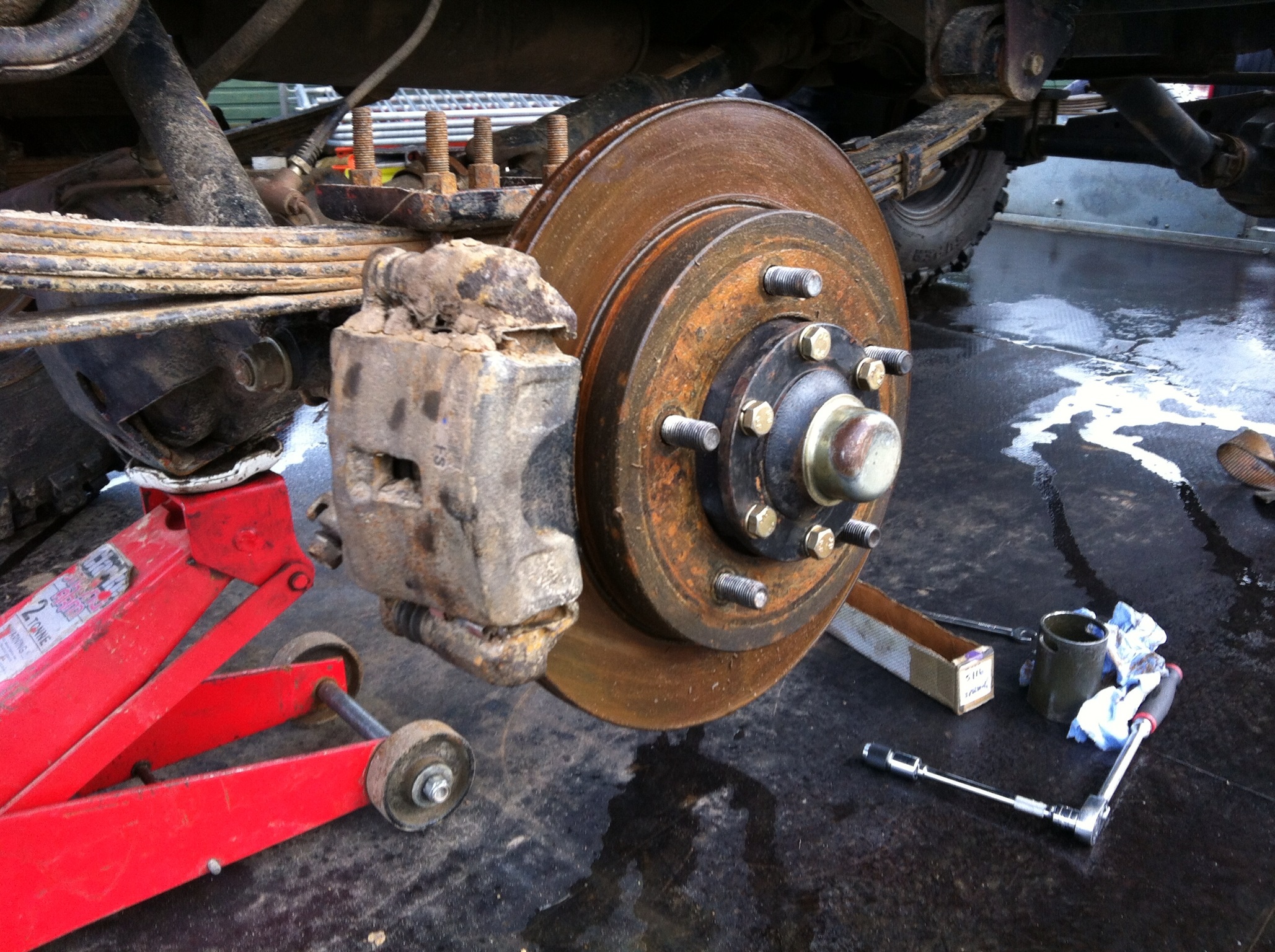

All I need to do now is un seize the brakes, and fit new front wheel bearings (done three events !!) and replace all the oils again and make the other half door.

Awesome! Did you loctite the adapters on? I personally would! Well actually I'd weld them on :lol: Tim pink had issues with the bolts coming loose. You can loose the rear wheel spacers now too and just run spacers on the front to keep the track width similar. Is that what you did?
Looking damn good with the half doors! Where is the drive around?

No I didn't lock tite them, there coming back off soon to re strengthen the back axle, and the speeds I do il just keep an eye on them, it only goes 10mph or so !!
And it's exactly the same width front and rear, the kit makes no difference what so ever. So there staying on to keep it all even :)

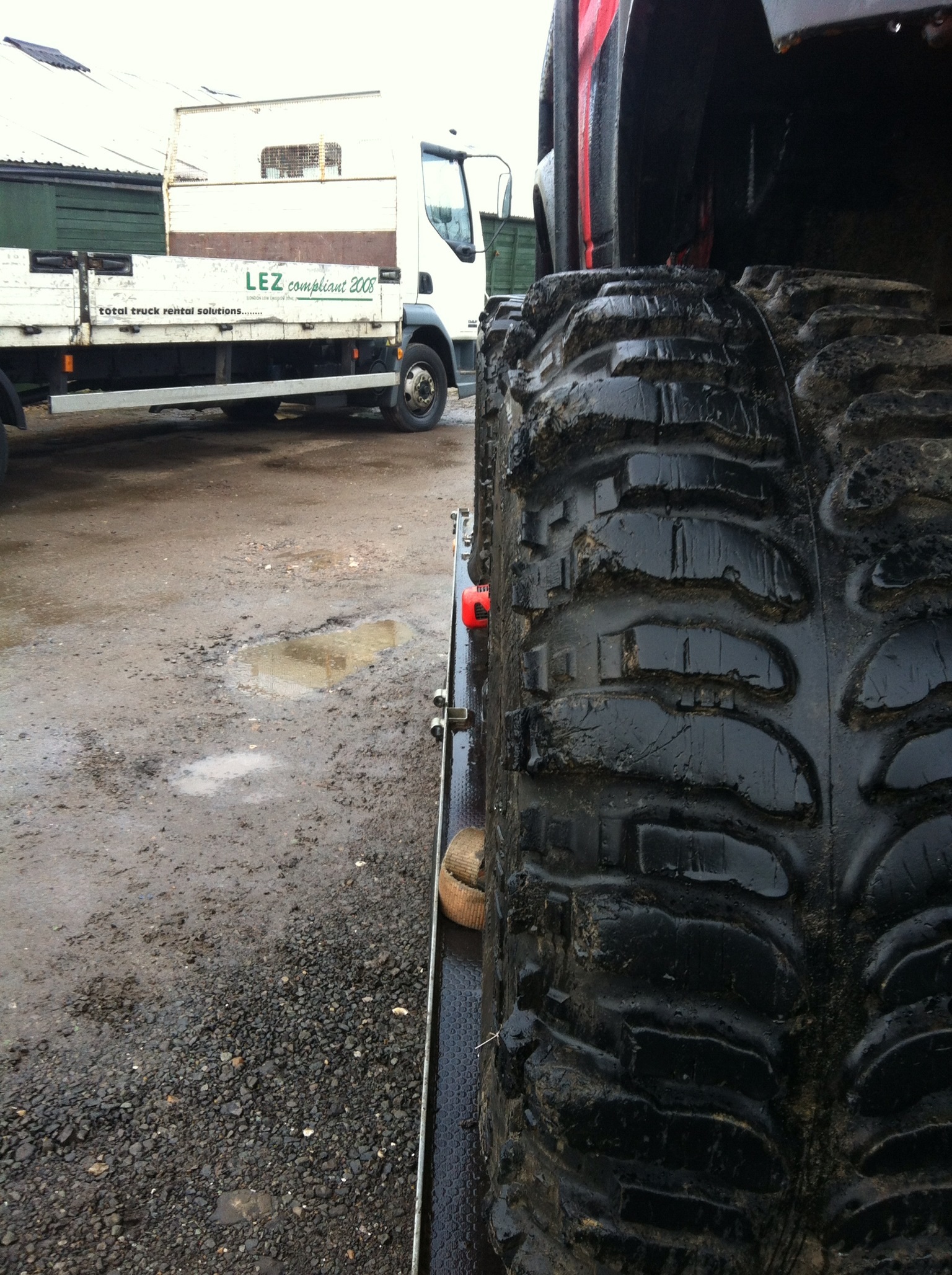

Post by mike harris » Thu Dec 06, 2012 9:44 pm
You can see here there in line, Spacers front and rear :)

Yeah will prob be ok at low speeds. You sure it's the same width? My kit is a rob stoor kit is exactly the same as yours and the rear axle ended up 3" wider than the front measured between the discs with no wheels on, will only be 1.5" each side so you'd probably need a tape measure on it to tell.

Trust me there equal. I was told the same thing but mine isn't. There was no difference at all that I could see. You can see from the pic, if I took the spacers off the rears would be 32mm in. And there certainly not 32mm out are they !! :)
