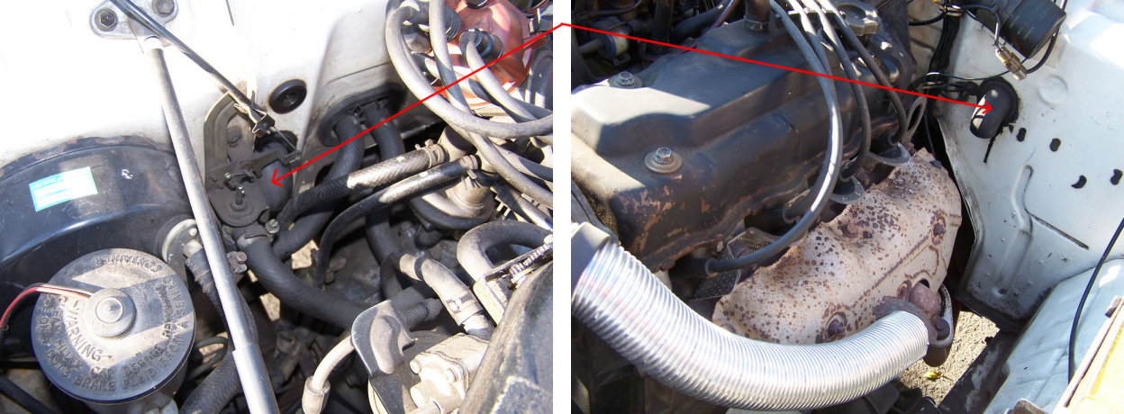

dan_2k_uk wrote:The wet foot well might be the air intake for the heater filling up. Try poking something up the two little right angle drain pipes in the engine bay to check its clear.
I'll second that :D
They have stupid little flaps that keep the shit in.
Well mine used too ;)
Heater drain points.jpg (154.06 KiB) Viewed 3415 times
