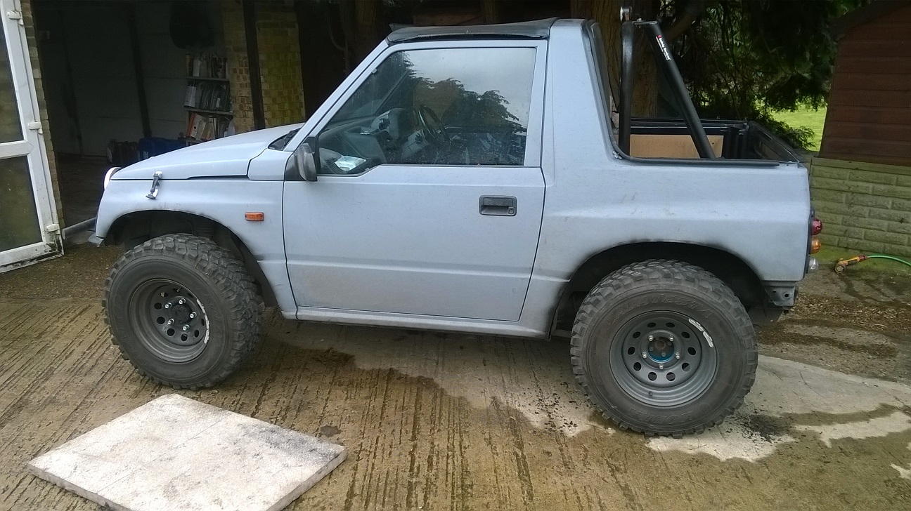

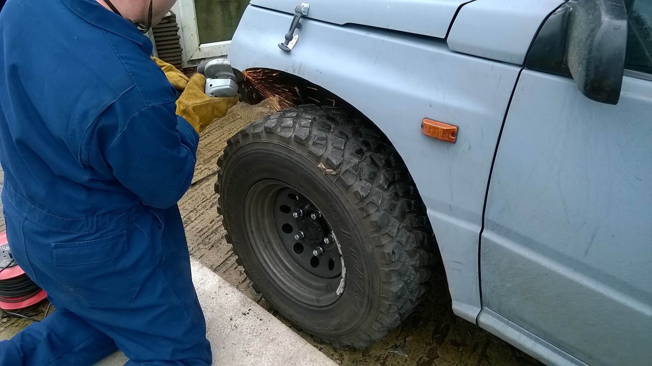

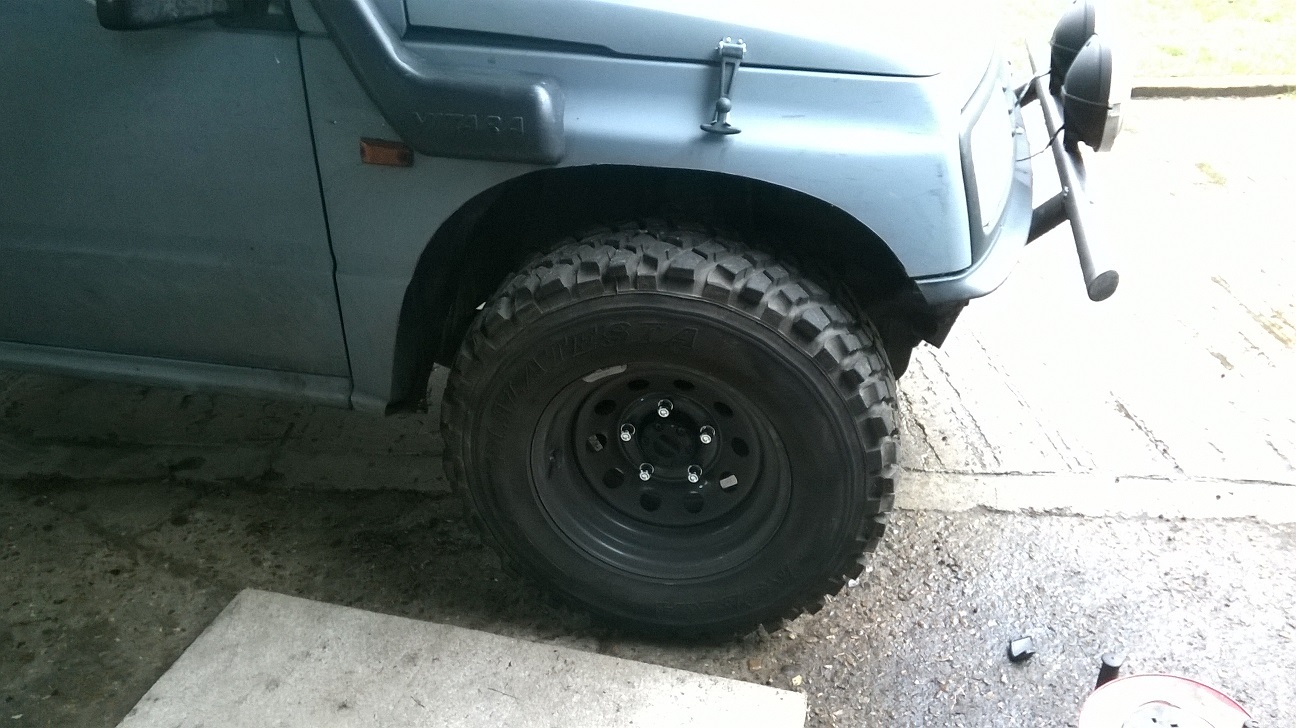

The virtual lift is done...all the tyres clear on full lock and max articulation. A little bit of fibreglassing is needed at the rear to finish it off. The new seats go in tomorrow as will the arches as they arrived today!
Re: the no dosh Vitara revamp

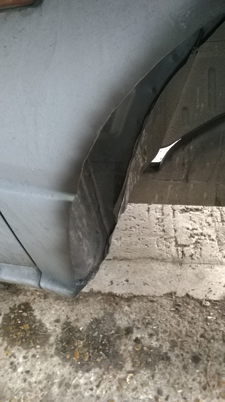

Post by donkeychomp » Fri Mar 27, 2015 9:34 pm

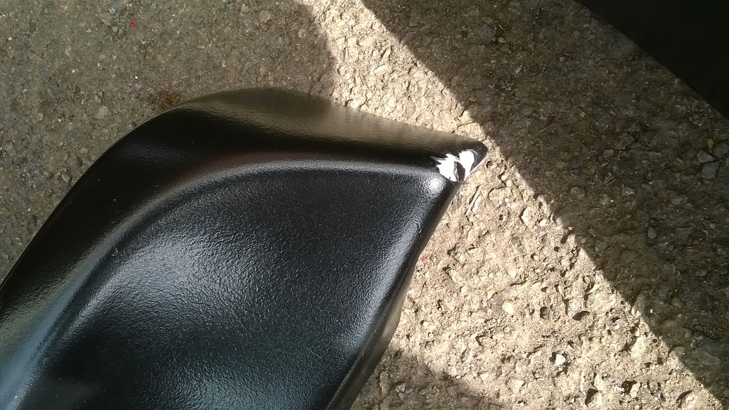

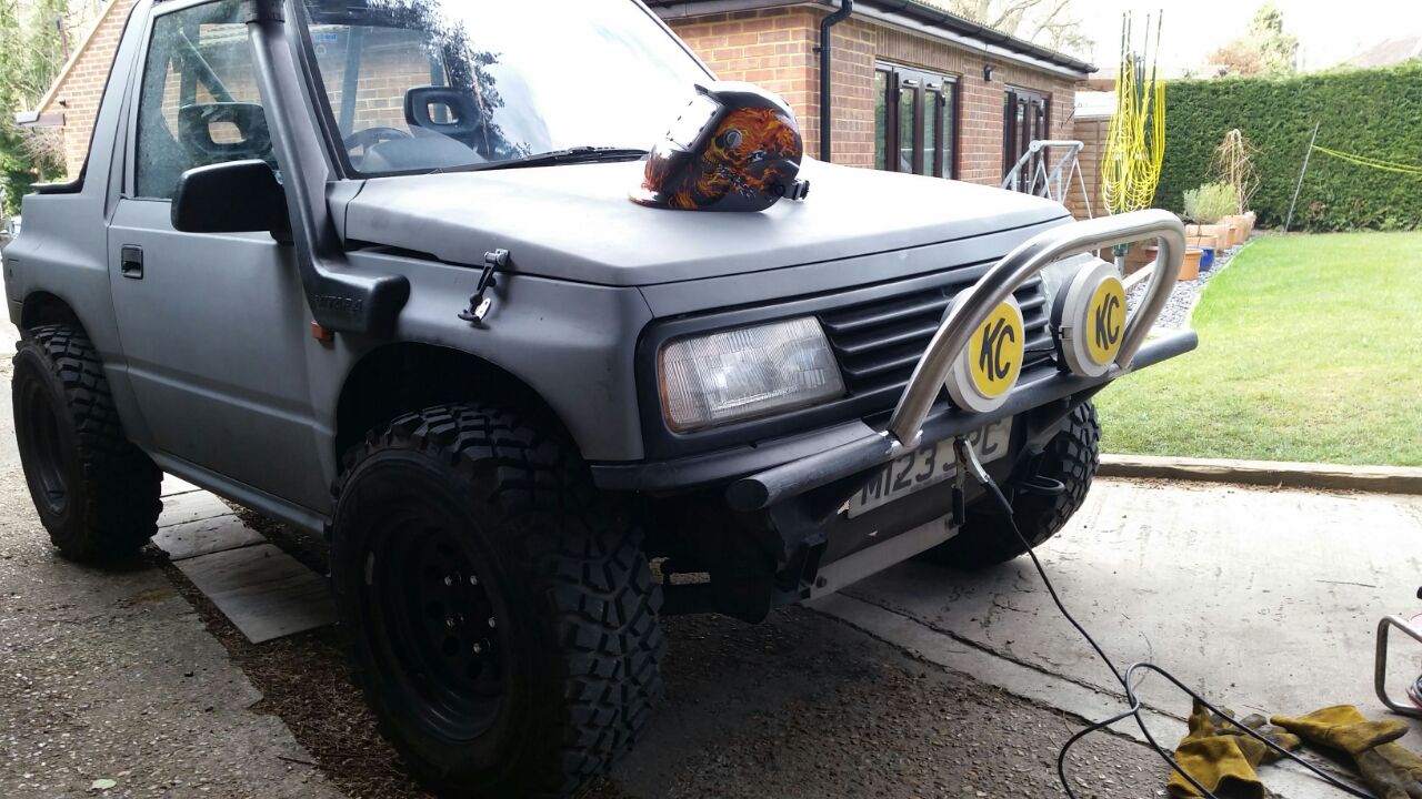

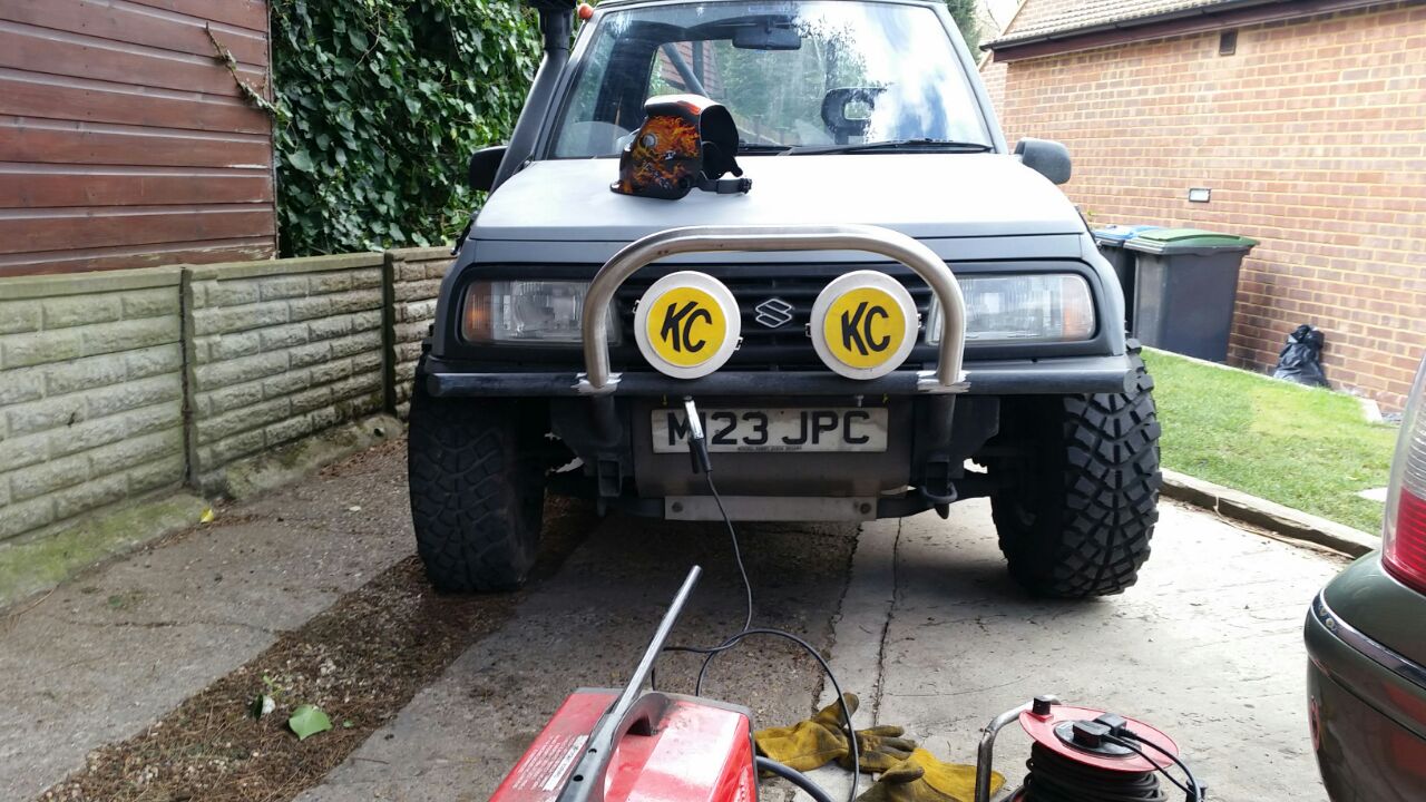

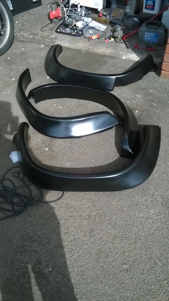

Woo...front bumper is finished and the new arches arrived from Cyprus...despite being well wrapped they all had damage, I have contacted the seller...
Post by adib » Sat Mar 28, 2015 7:20 pm
Looks good! Those hard plastic fenders will get ripped pretty fast if you are doing hard stuff, from what I have seen.
Post by turbo-tom » Sat Mar 28, 2015 8:36 pm
if them extentions are grp fibre glass be carefull not to damage them on trees as alot of defender drivers bought some on ebay and the slightest knock and they crumbled into dust

Those wheel arch extensions certainly do look the part,the old Vit is starting to looking good.
Post by donkeychomp » Sun Mar 29, 2015 12:26 am
Yep fibreglass but a doddle to fix if they get snagged on something. Need to get them fitted but after the VL there is nothing left to attach them to. I think I'll weld some small tabs on the inner wheel arches so I can put the self tapping screws it came with on.
Post by Rhinoman » Sun Mar 29, 2015 8:34 pm
I recall someone filling the flares with expanding foam to help prevent them from shattering on impact - at the very least it keeps all the pieces in place.
Post by donkeychomp » Sun Mar 29, 2015 9:32 pm
Good idea!

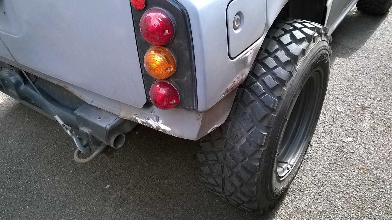

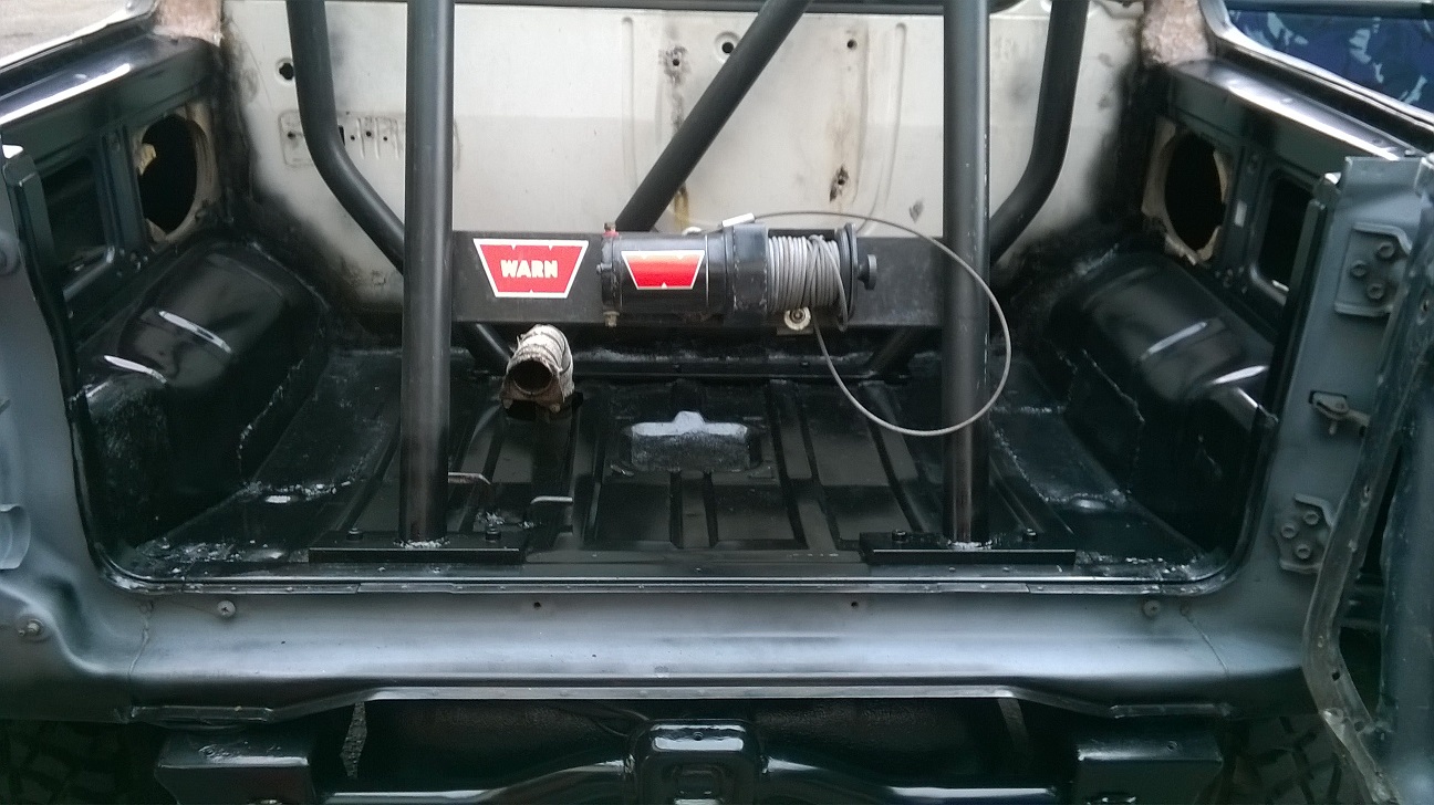

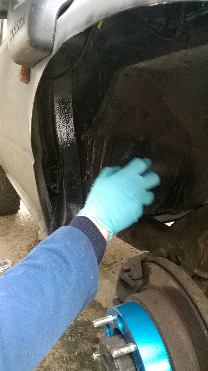

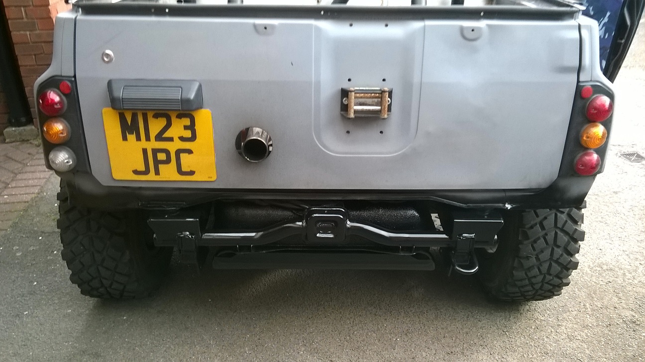

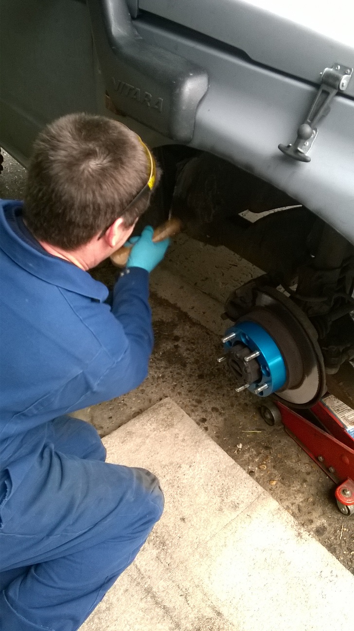

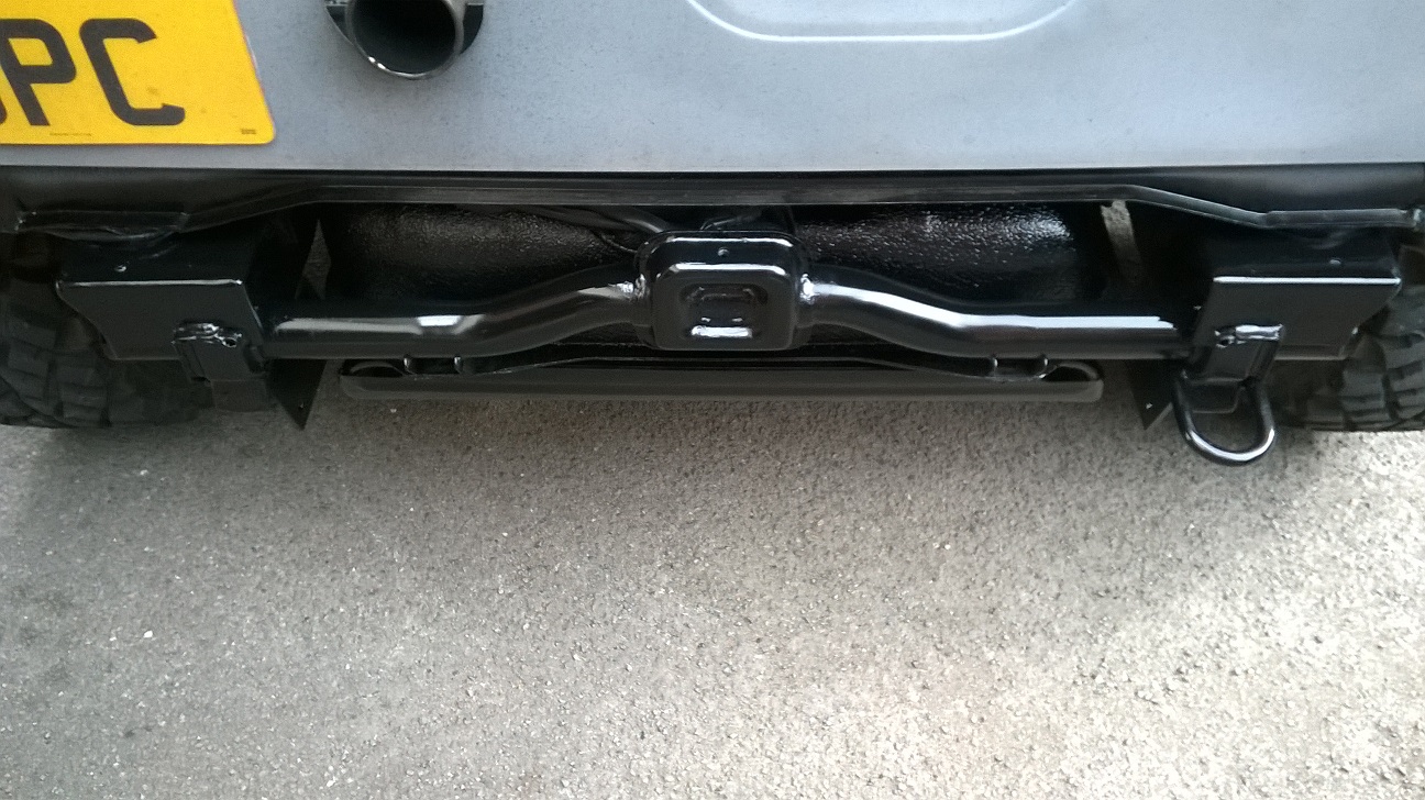

Post by donkeychomp » Wed Apr 01, 2015 10:07 pm

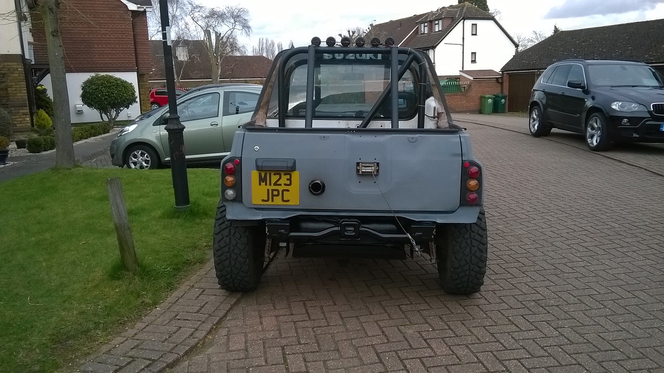

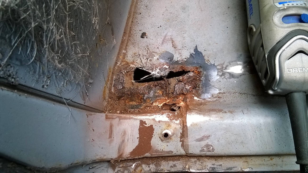

The MOT is due in a few days, I see no reason why she would fail but a tidy zook is a lot nicer...so I made a start, cleaned up the rear end and the pick up bed. I have often wondered why the rust I kill comes back and it dawned on me...primer is porous! So everything de-rusted (again), then gloss black and THEN primer!!
