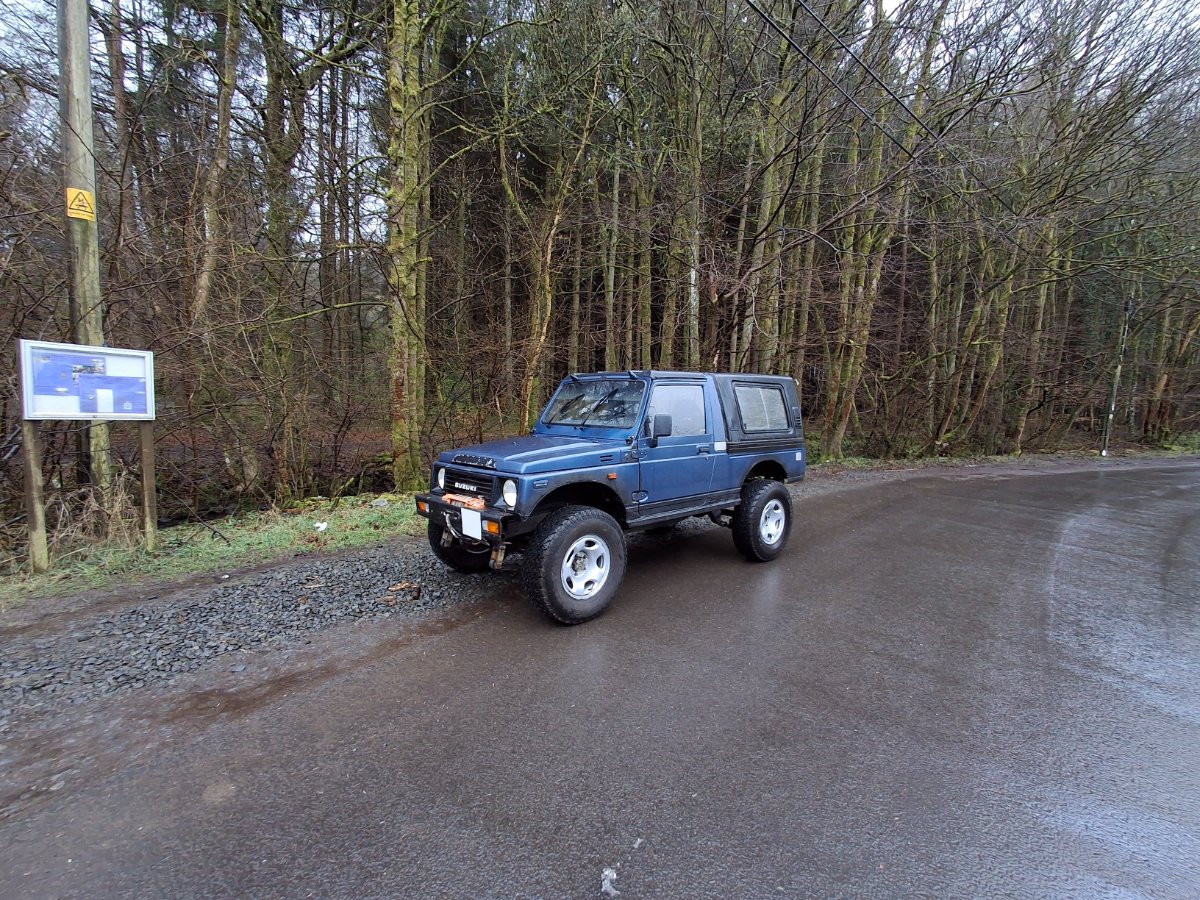

Today I managed to get the car out and stretch it's legs not far from my garage. There's a clay pigeon site but it's had offroaders before and there's a few routes. Would be ideal for a Scottish meet...
Stuck my mudzillas back on for it as it's usually quite slidey up there in parts, mix or grassy hills, boggy bits and rocks covered in moss.
The lwb handled nearly every obstacle I flung it at. Two I didn't but they were pretty much vertical sections of rock that I didn't think I'd get near without a locker. Managed some parts that my previous swb didn't get up with it's locker.
It was so smooth on the bumps and hills. Well smooth for a sj. Still shook about abit on springs but was a totally different experience. Definitely glad I made the switch, it's well suited for these kinds of places and days.
All in all a great day with no breakages.
