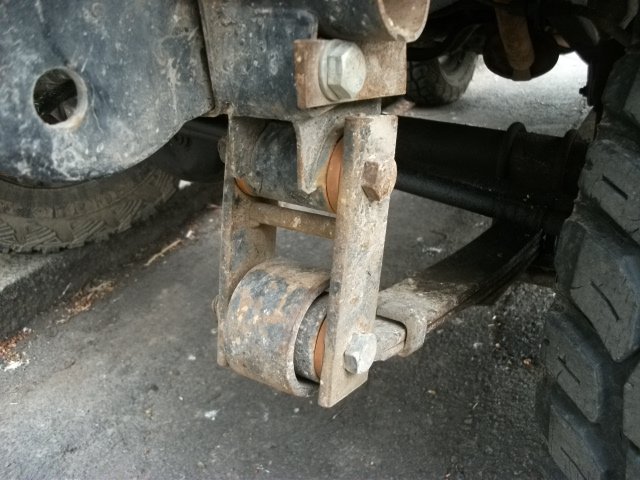

heres the front two parts of the suspension.
- 20140719_074955.jpg (2.11 MiB) Viewed 6544 times
- 20140719_074950.jpg (1.84 MiB) Viewed 6544 times

Does anyone know by looking at those photos what will need replacing?. I've got new springs and bushes but no shackles which I will probably need and I also have the u bolts that let it go over the axle.

Well the bushes dont look too healthy, that would be fun, changing all the bushes lol
The shackles might be broken as well, but hard to tell from pictures..
I hate to say it as you've already got spring over but it might be worth making some different shackles, something like mine with a bolt in the middle to keep them straight-ish
But you would want to make the gaps between the centre bolt and the spring eye as small as possible (you really dont want any more lift), like the top half of my shackle in the picture. Might be worth a try but could make your handling terrible with the spring over
Might be worth checking out the spring mounting plates on the axle... maybe send a pic of them?
Some conversions can be done really badly so worth checking
