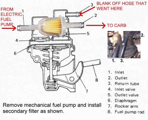

Re: Changed the fuel pump but theres something wrong
"Diagram Darrell" has been at it again
- fuel pump.JPG (63.39 KiB) Viewed 6841 times
- Edweird
- Posts: 2531
Don't forget to blank the hole. Oil makes a mess.

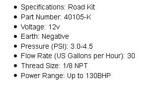

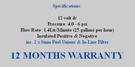

Thanks Darrell..The plumbing looks easy enough it's just the type of pump.
I think it was Henry that said earlier in this thread that a Facet solid state 3-5psi pump would be best.. The pump item number above is for a 3-4.5psi and others I'm looking at are 4-6psi.
Which is best?

Sorry about the diagram, it's a bit much really. It's simply enough but it looked like "smalljeep" connected the supply from the pump straight back to the fuel tank

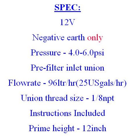

I would think any of those would be suitable, even the cheap one. Though the genuine Facet pump Twiss used may be worth the extra money.
- £45.JPG (15.42 KiB) Viewed 6800 times
- £19.JPG (20.33 KiB) Viewed 6800 times
- £28.JPG (40.01 KiB) Viewed 6800 times
