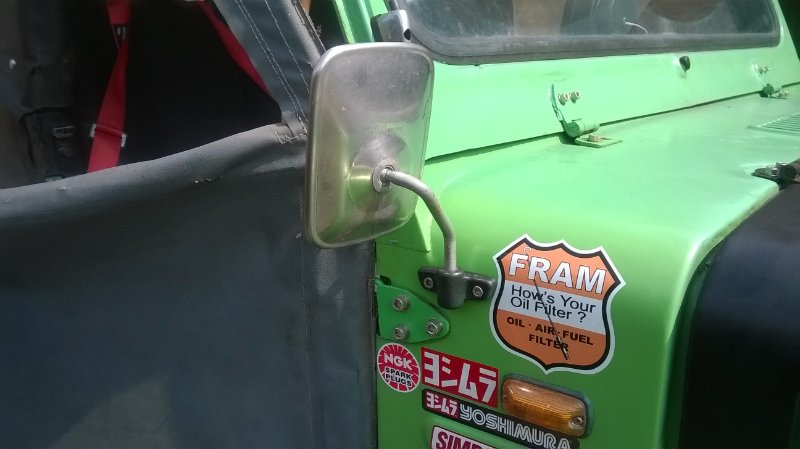

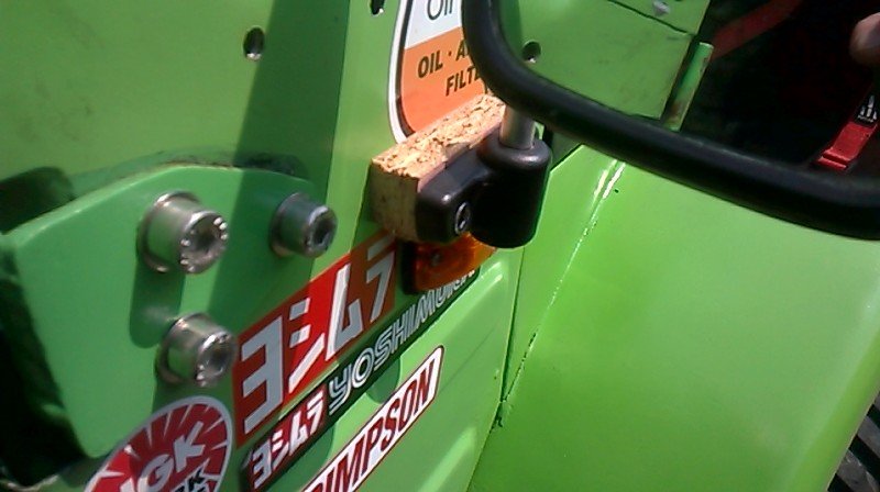

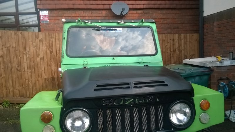

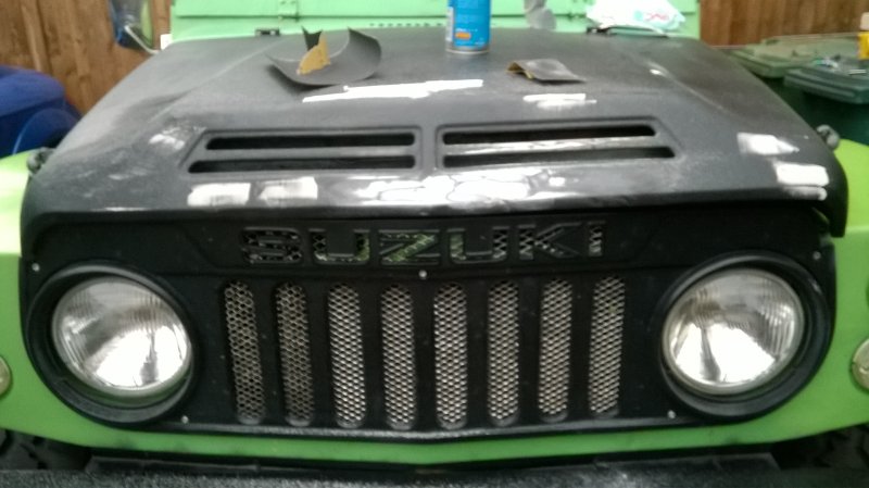

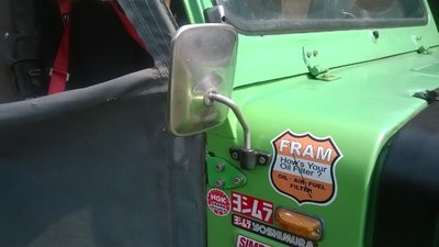

Cheers Robbie, bonnet still needs work and after last night so did the rest of her. New (again) wiper on and both stuck on with Gorilla Glue. Yes I can get them off ok with the little pin. Then the spare mirror got bolted to the wing, after drilling holes in the wrong place!
wiperless
wiperless
mirrorless
mirrorless
in wrong place!
in wrong place!
home made spacer to soak up rain

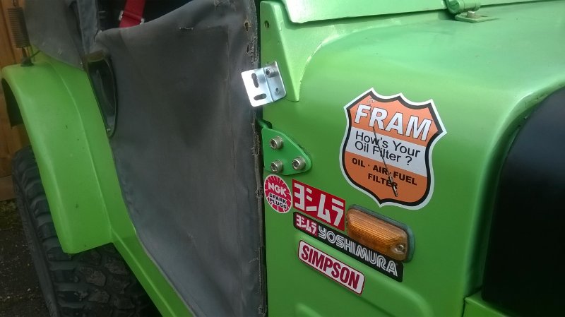

Just shown some pics to the mrs and she has ruined the soft door look
Re: the no dosh LJ revamp
Post by donkeychomp » Tue May 29, 2018 8:37 pm
She doesn't like the look? Take 'em off lol

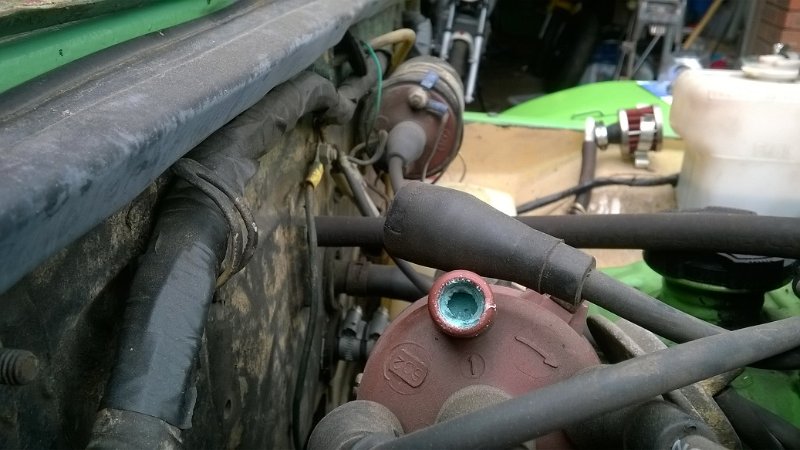

So the old girl has been a little 'off' recently. I changed the air filter for a Fram one and what a difference that made but she still didn't feel right. Checked the plugs, all the perfect colour and gaps, then noticed one of the HT leads going to the dizzy was only half on, aha I thought, pulled it off to see this...
Jordi says it looks like an ally version of copper slip, it's all furry like a build up on a battery. Why it's blue and how it got there is a mystery as I put that cap on when I got the car. Anyway, cleaned it out then the HT lead fell apart. Got one from the motor factors and have ordered a new set and dizzy.

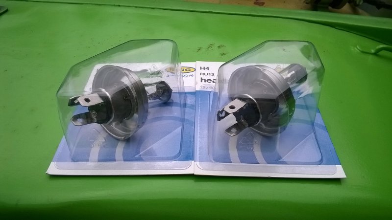

Got my halogen bulbs too but how the hell do I fit them?

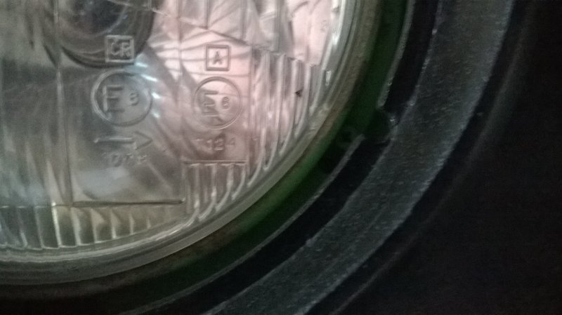

Are they sealed units? If not you will need to remove the grill and then get the glass out of the bowl.

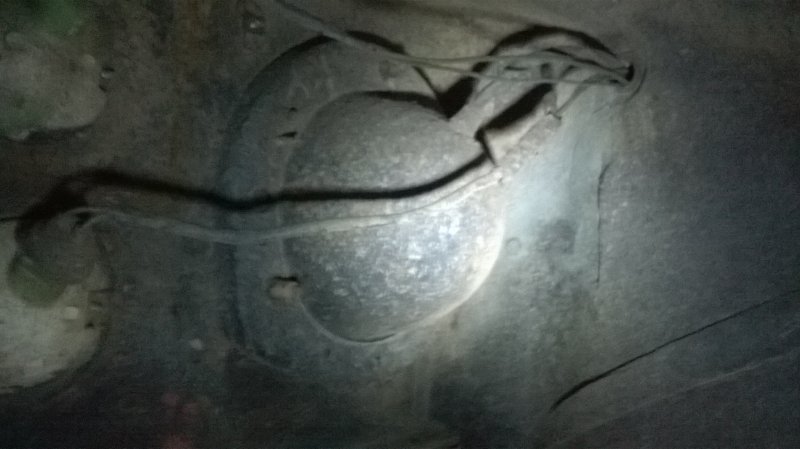

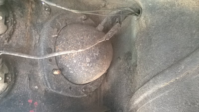

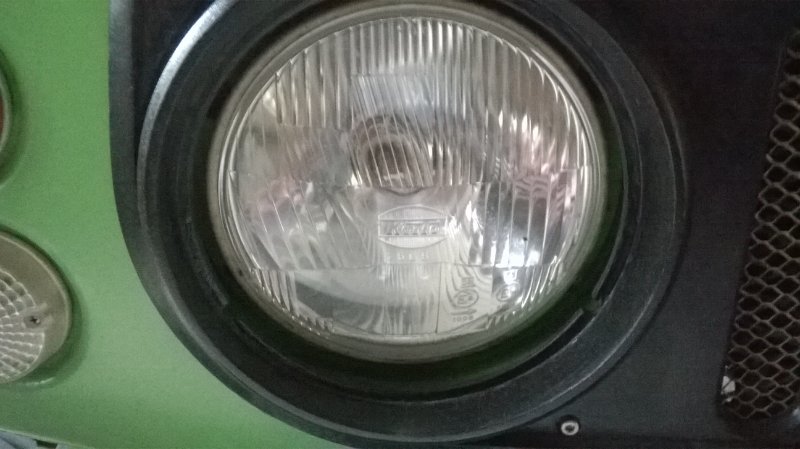

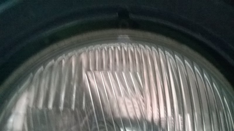

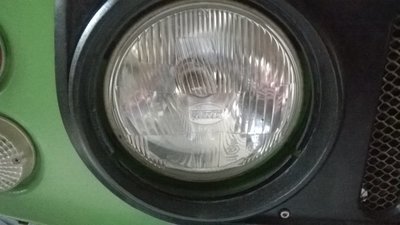

Post a close up pic from the front
Post by donkeychomp » Fri Jun 01, 2018 3:12 pm
Here you go!

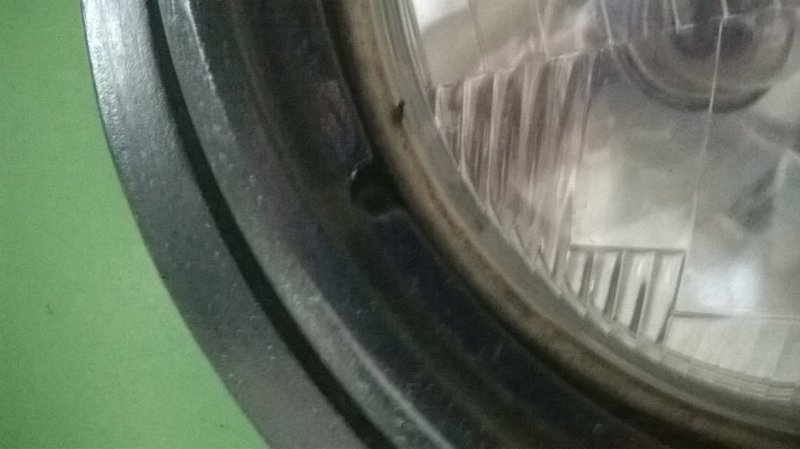

Post by donkeychomp » Fri Jun 01, 2018 5:04 pm
Better ones...

Take the grill off, then you should see the screws that are used to adjust the beam. From memory you should be able to push the light and twist the lense unit out and get to the bulb.
I can look at mine in the morning and get some pics, the grill is already off and in the house, for protection of course :lol:
Post by donkeychomp » Fri Jun 01, 2018 11:26 pm
Of course! (slaps head Homer fashion). Thanks Robbie for reminding me!
