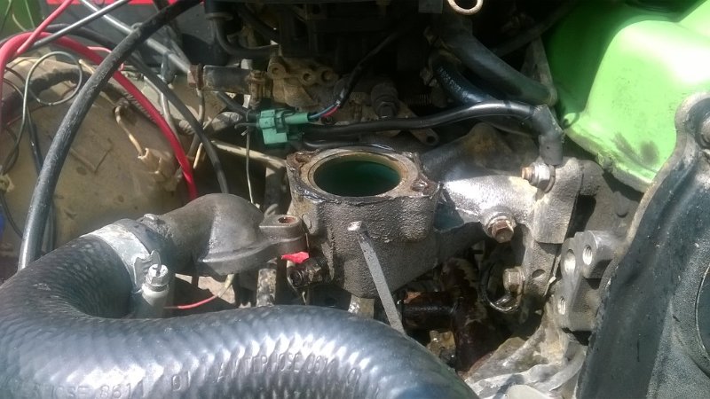

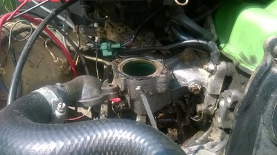

I'd whip the stat out and see if that helps with the cooling.
If it does , i could have a look in the book at work for you and see if there's a suitable replacement that opens up at a lower temp, thus dropping the heat earlier.
Re: the no dosh LJ revamp
Post by donkeychomp » Thu Jul 26, 2018 9:17 pm
Good idea mate I'll take it out now. I remember when I first got her she ran cold and the heater was non existent...no thermostat!
Post by donkeychomp » Fri Jul 27, 2018 9:49 pm
That worked! Stat out, new sealant and a top up in the rad and running perfectly. I might just leave it as is until winter.
