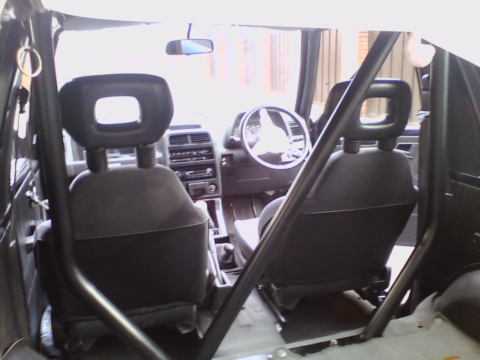

After a bit of drilling and swearing it's in! Looks like it was made to fit even though it was for an SJ. I'm well chuffed.

It's my only vehicle so I do look after it. The roll bar will be extended soon enough to make a roll cage, should look good and give me a bit of protection...I rolled my old SJ and don't fancy doing the same in the Vit!

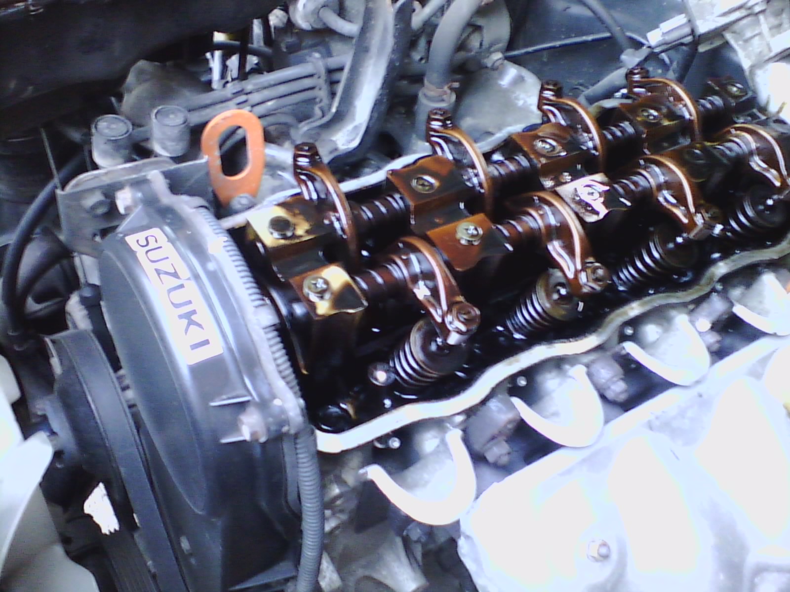

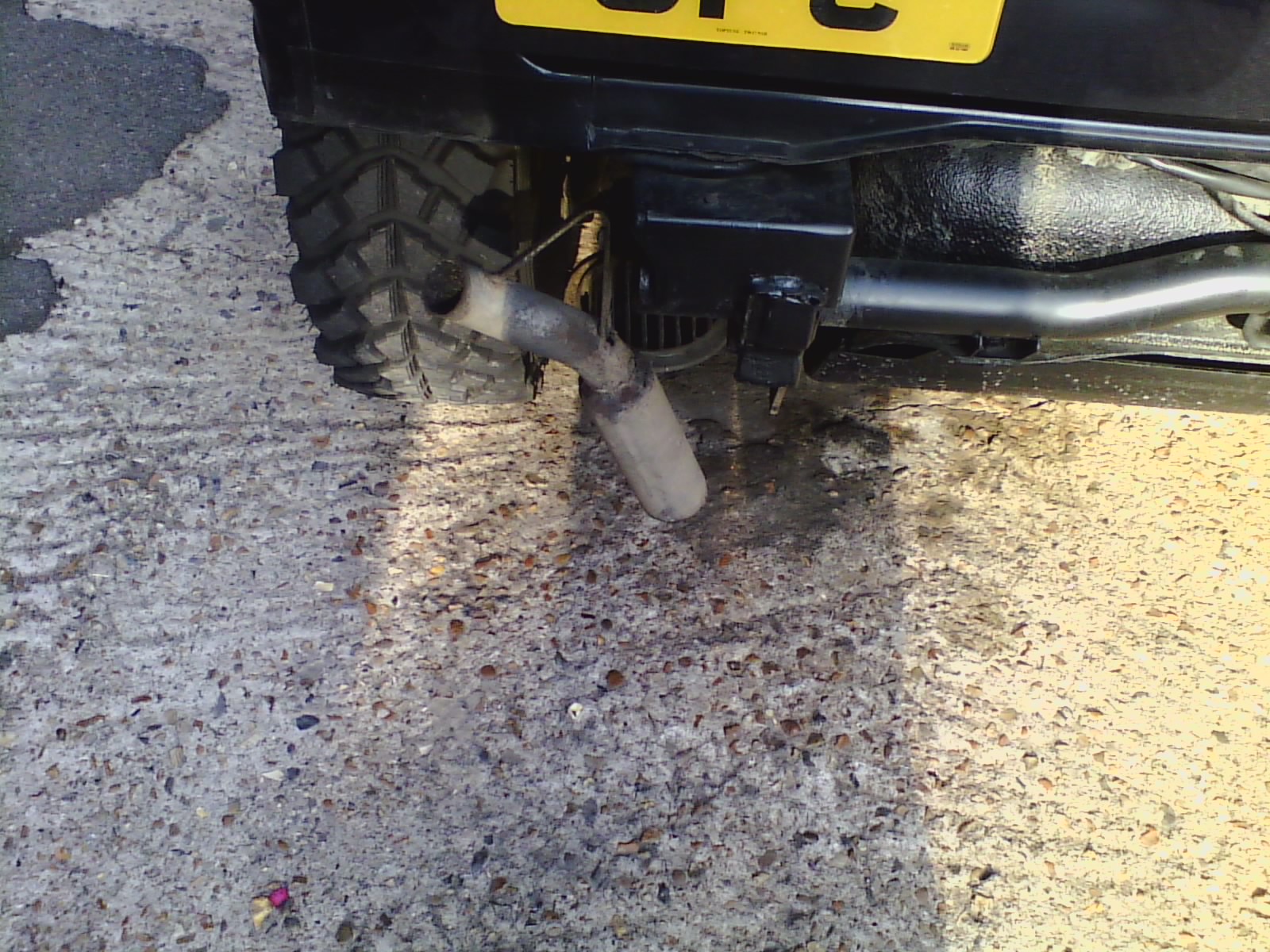

Had a bit of a problem today, popped over to a mates house and the exhaust was hanging off! So a new one is being built, going to dump the second silencer and run it straight through with a cherry bomb.
Also changed the leaking rocker box gasket to find 3 valve screws were just about on! I had the same problem with my SJ410, not the best design in the world, a drop of Loctite and the job's a good 'un!

Anything more than one cherry bomb is over kill bud :guns:
