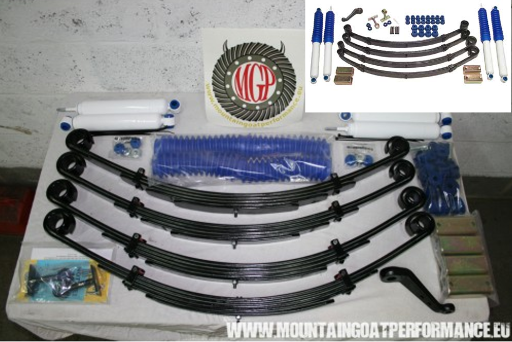

If these springs are longer and the spring pack bolt is in the centre does this mean the front axle has been moved forward ?????????
Looking at the rear spring pack it doesn't look like it would even compress, let alone reach the bump stops (how many leafs !!) :er:
Pics to show the calami kit along side MGP one.

Darrell wrote:If these springs are longer and the spring pack bolt is in the centre does this mean the front axle has been moved forward ?????????
Think Dans ironmans are 5 leaf.
Good point I never noticed that, it would of only moved it by about 1/2" thought wouldn't it?
If theory the axle has not been moved forward. The springs are only longer to allow a greater curve. If you sat the spring side by side with a standard spring the bush centres should line up. The lift spring will just have a bigger curve.
It does mean under articulation as the spring flattens the axles will move further forward. This can be worked out by halfing the distance of the difference in length between the old spring and new spring.
