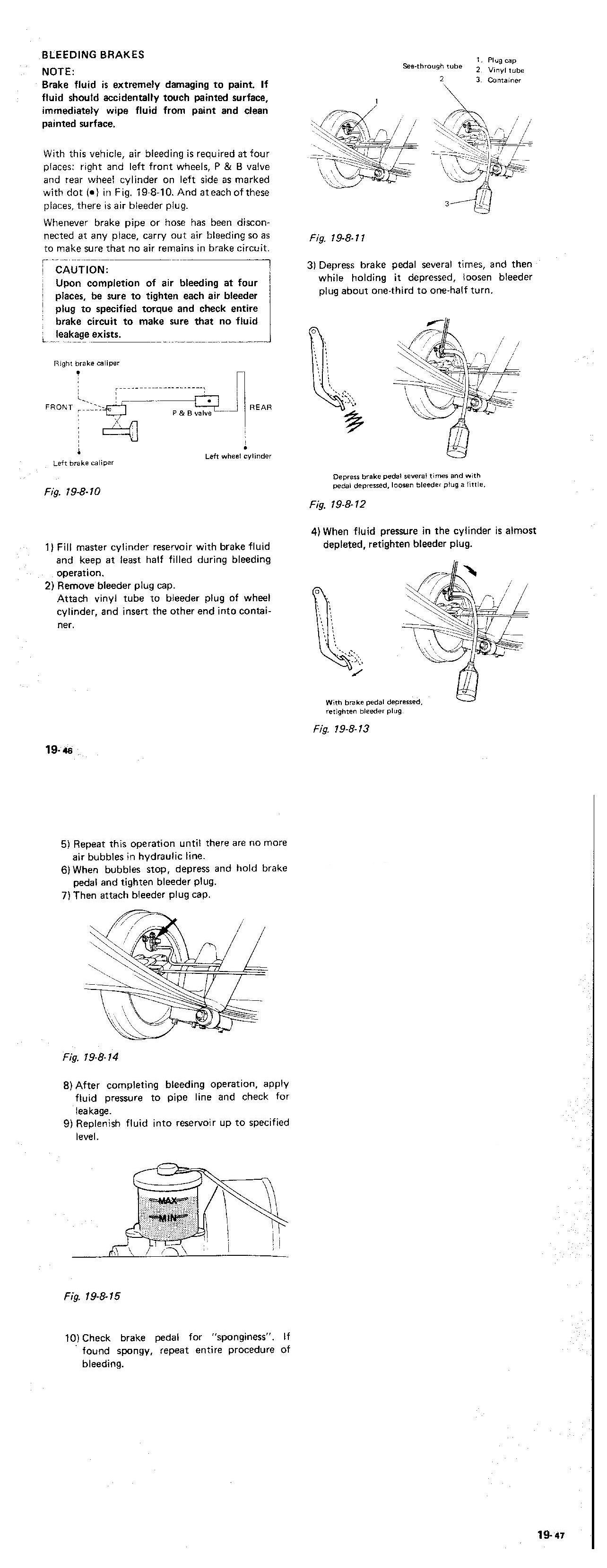

Post by Darrell » Thu Aug 13, 2015 8:00 pm
Is it possible the P & B valve needs bleeding to get fluid to the rear cylinders ?
Just thinking out loud, I have no idea really..
