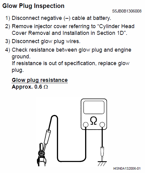

Hmmm thanks for those, looks like an ohms test might be worthwhile before buying new glowplugs... And it does sound a bit of a tricky job to replace these, especially the back one. I think I'll take a look and strip down so far until I can see whats involved.
Apart from the post you gave which refers to the meter giving a "beep" during the ohms test, is there a reading on the meter I should be looking for ? 0.5 ohms or whatever ( my meter doesnt beep )

Re: Glow plug replacement how to
Post by Darrell » Mon May 23, 2016 7:49 pm
I would check them first..

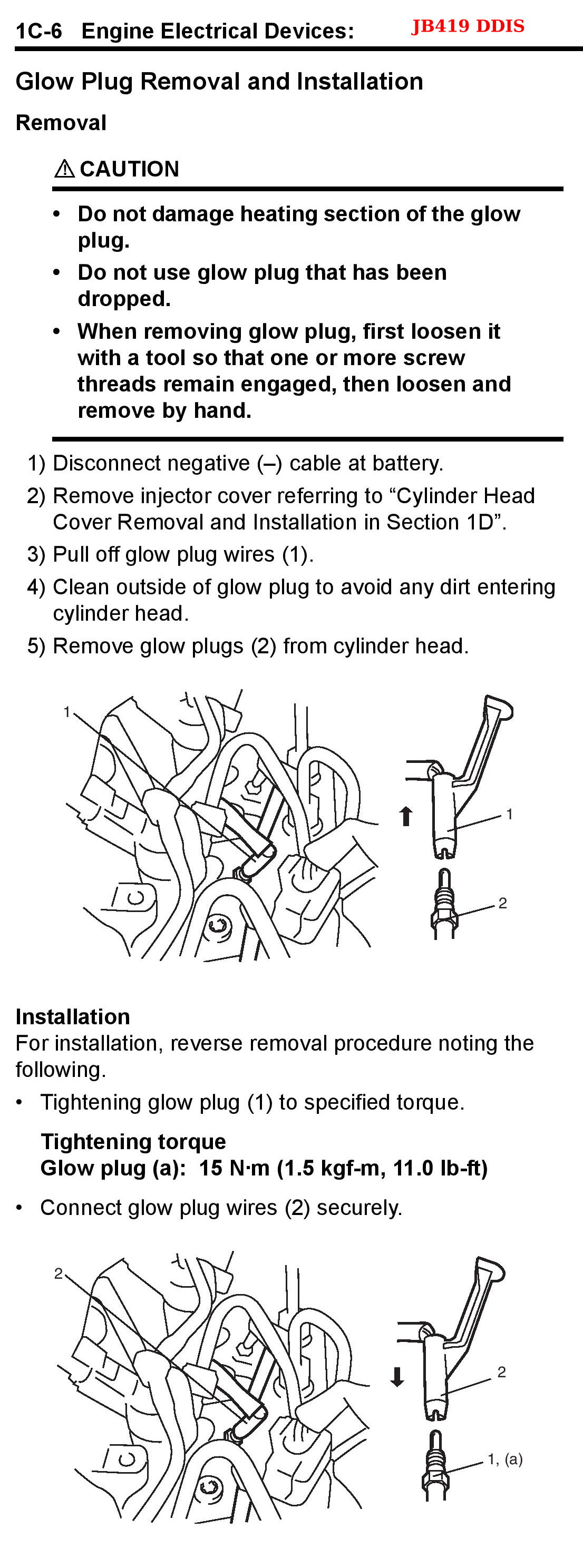

Post by Darrell » Mon May 23, 2016 10:27 pm
I've put this together. I had no idea they are such a pain to get to just for testing. All because of that dam cover :argh: .
To be honest you need to know somebody who stocks the glow plugs and somebody who's willing to go get them if needed, either that or your have to pull it apart twice.
Just be careful you don't snap any plugs off :bawling:
Post by Darrell » Mon May 23, 2016 10:48 pm
And if needed...........
