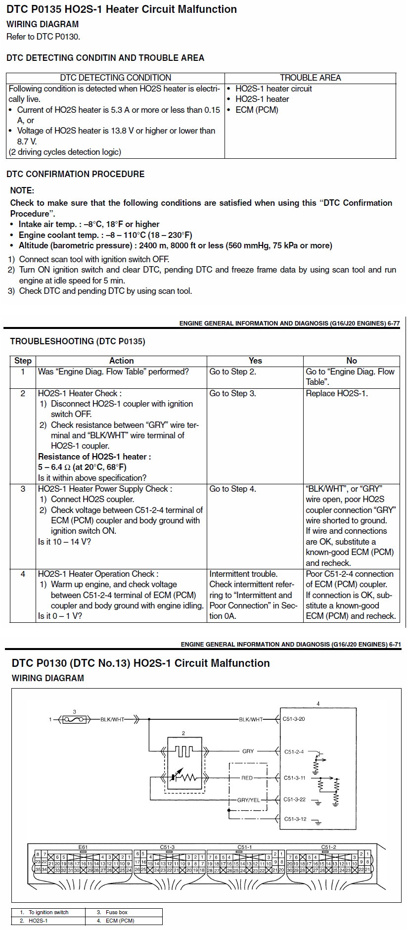

Even cheap readers would normally give a full code but I am assuming it's "O2 sensor heater control malfunction" sensor 1. This would normally be shown as P0135. The most common reason for this is when the heater coil within the sensor has failed (open circuit). It's quite easy to unplug the sensor and check the resistance of the heater coil so I've copied the workshop manual pages if you wish to have a go. I wouldn't worry about clearing the code as if there is a fault it should come back straight away. Below is for the 2.0L engine, hope yours is not the V6 and if it is sensor 2 I'll re-do below.Dave09 wrote:
Full code, 02 ht crt malf (bank1-sen2) does that make any sense to you. ? Sensor 1 in your first post ?
There again a 40 quid diagnostic reader aint going to give all the answers.
Dave
- GV 416 420 DTC P0135.jpg (358.5 KiB) Viewed 11377 times

Resistance checked out, and open circuit. not going to worry about that one. will change the sensor at some point. quick cure done, a bit of insulating tape over warning light?.. easy fix (temporary ish)
