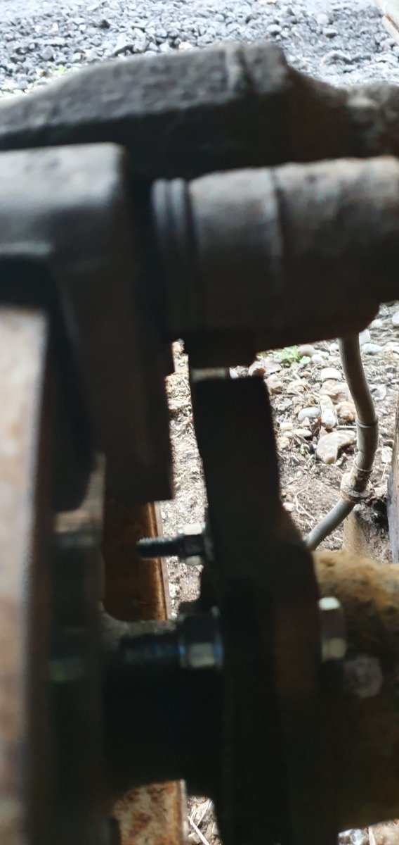

Has anyone else had this problem

Have to ask the silly questions first, sure thats as far in as it will go? Might have just not lined up the teeth properly. Is the bearing pressed on as far as it can go? Some bearings come with a little collar in which case you don't need the little spacer, if your bearings have the collar AND you fitted the little spacer it would cause it to stick out far enough.
Did you cut the spacer from the original backing plate? Looks like that might be the missing piece. Check point 7 from this guide: https://www.suzukiclubuk.co.uk/how-to-t ... conversion

Looked a bit harder at the picture you sent and it looks like the backplate spacer is missing?
