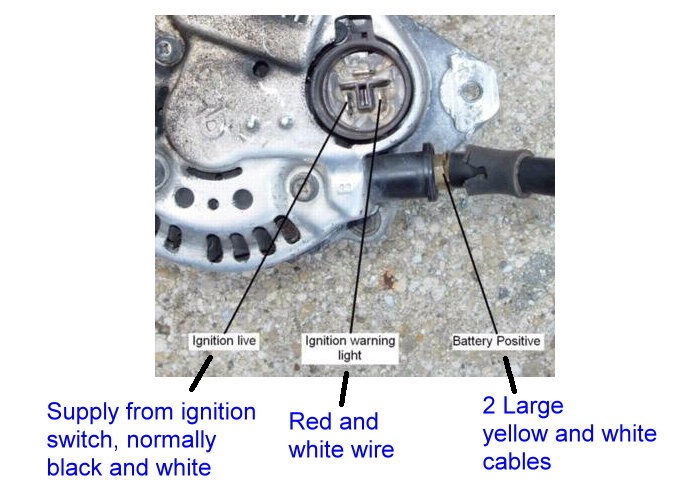

This was my original alternator
And its plug

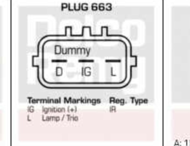

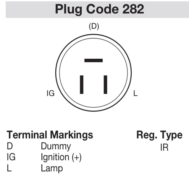

This is the wiring diagram for my Suzuki
And the wiring diagram for the new alternator

So my original alternator had x2 white with yellow striped wires going to the plug, these were joined in the plug, for this new GM alternator I cut both cables & soldered them together & to a 4mm cable with a ring crimp which I attached to the bolted connection on the back of the alternator. The red cable on the alternator pig tail I put a ring crimp on and attached to the same bolted connection. The white cable from the alternator pigtail was soldered to the white cable with red striped wires which is the ignition light.
