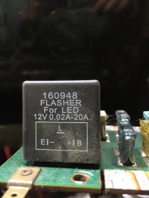

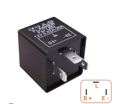

Post by ScottieJ » Thu Dec 05, 2024 4:32 pm
Easiest way to get your indicators flashing at the correct rate with LED indicators is a new LED specific flasher relay.
If your SJ is Spanish with the early PCB style fuse board you need this polarity
CF14 JL-02
If your SJ is Japanese built (or a late Spanish with round stalks and a plastic fuse box)
You need this polarity
CF13 JL-02
