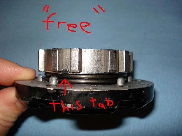

you might have assembled the freewheeling hub slightly wrong, whip the outer section off and check it is all ok.
there is a clip that overlaps one of the splines, you need to make sure that this sits in one of the 'Wide' splines on the hub body.
you'll see what I mean when you take it apart, there are 2 splines that are wider than all the rest :thumbup:

Post by ScottieJ » Tue May 24, 2011 9:16 pm
This is the tab I was talking about and the 'splines' are the large grooves inside the hub body.
Perhaps I shouldn't call them splines? But in my eyes they're just big splines :lol:
Thats a good guide there Darrel :doublethumbs: I'm sure its something simple Hugh, follow the guide and I'm sure it'll sort it out, something is probably just in the wrong place like one of springs stopping you from turning it :er:
