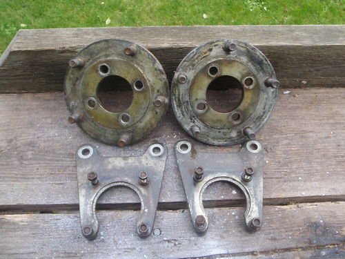

Hi, I'm going to have a go at fitting rear disc brakes to my sj and I've just got hold of these brake caliper mountings. = No hand brake on the rear wheels so do I fit a 410 transfer box with a centre brake? 31 inch special tracks = Rock lobster gears while I'm at it? Is there any particular year of 410 transfer box needed?
Silly Questions but I am new to SJ's. Thanks in advance for any advice. :thumbup:

What calipers are you going to use? I have read that rover 600 calipers fit and have the handbrake built in, though i think the cables need to be swaped as well.

I've got my eye on some original sj calipers. ( Is this good? )

Post by Darrell » Sun Jun 12, 2011 4:17 pm
They should be fine if your going to get a transferbox handbrake. :thumbup:

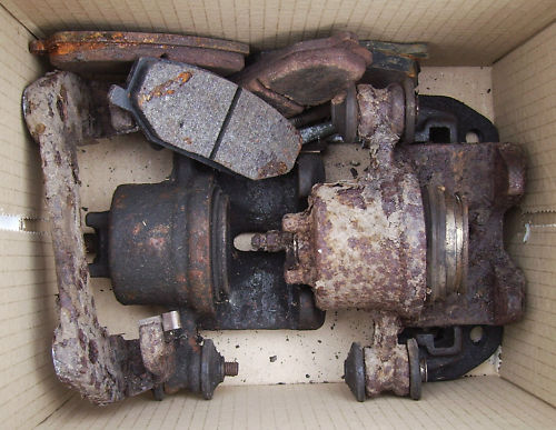

Newtomud
Posts: 478
Location: wolverhampton
Re: Rear disc conversion/Transfer brake
Post by Newtomud » Mon Jun 13, 2011 6:38 pm
I have the calipers now.. They'll need rebuilding first as the're a bit manky.
