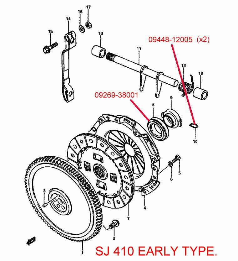

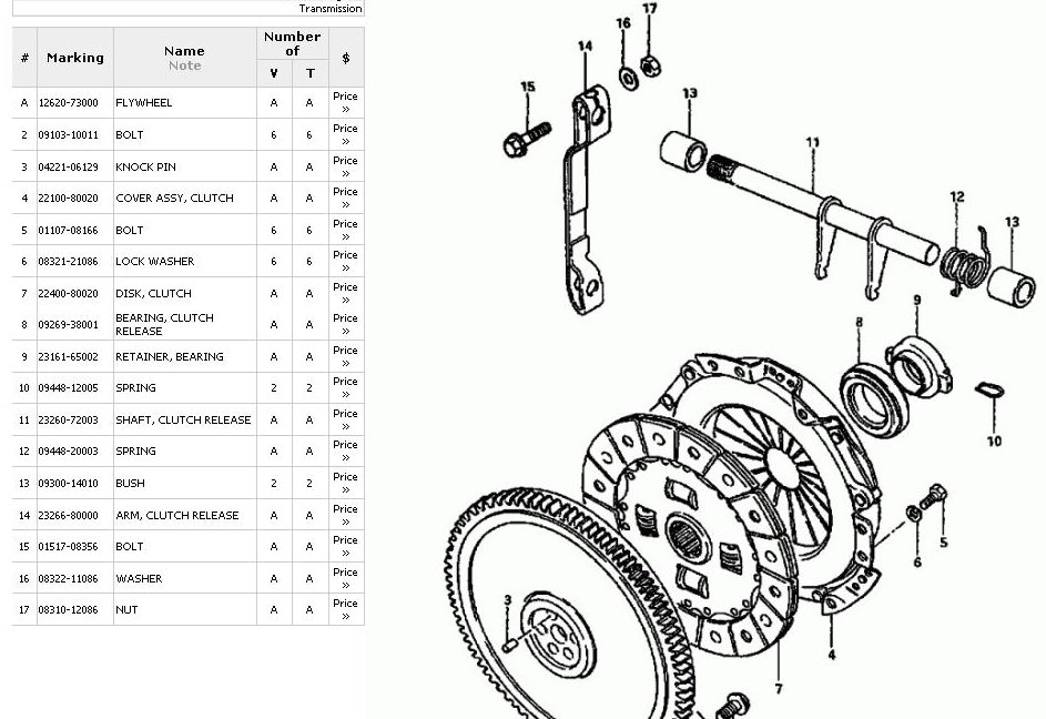

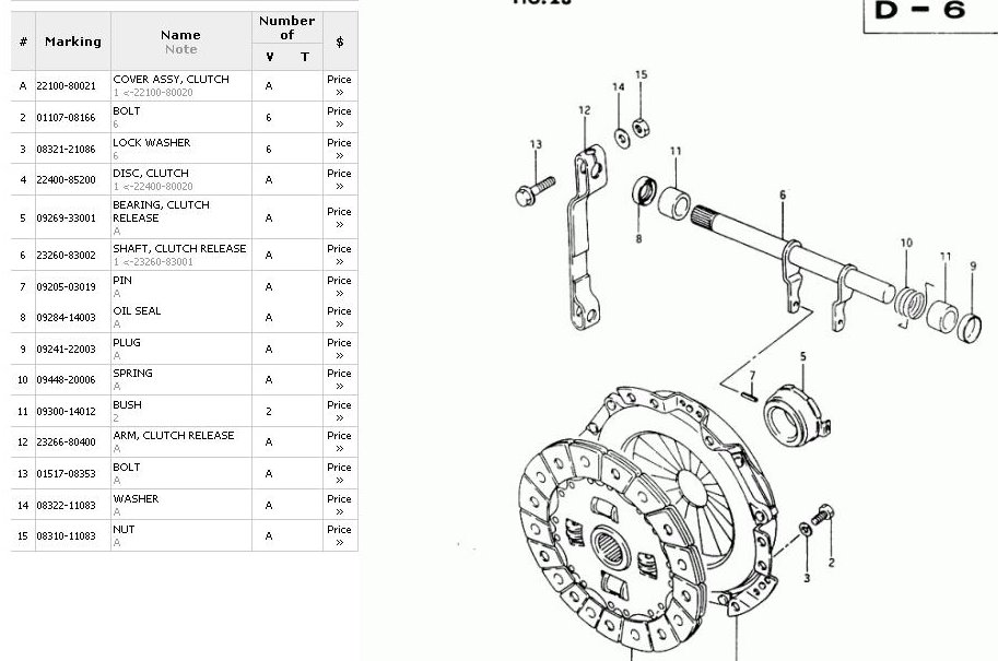

Been having a look round to see what info I could find and have saved these diagrams (yay, more diagrams :D )
It appears the early 410 has a different shaft and release bearing.
410 normal.JPG (87.58 KiB) Viewed 4865 times
410 82-84.JPG (122.48 KiB) Viewed 4811 times

Re: thrust bearings
Post by Darrell » Fri Oct 21, 2011 10:21 pm
Suzuki only for the springs I guess.
410 82-84.jpgdr.jpg (109.73 KiB) Viewed 4859 times

That's ace lads mines deffo an early type looks like a trip to zooki for some clips later and whack it all back on the old bearings fine do I'll just use that then I've got a new bearing if I ever change box
