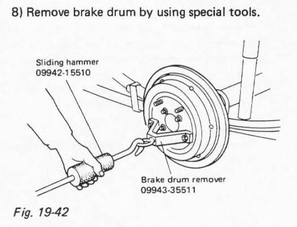

Re: quick drum question
Post by Darrell » Fri Mar 02, 2012 10:21 pm
From the workshop manual. I made my own though.
drum puller.JPG (42.34 KiB) Viewed 6519 times
