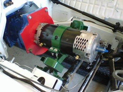

I'm planning on using a Warp 11" motor. It is about the same weight as the standard engine so the suspension should deal with it just fine.
As for the specs, at 144v it produces 44hp and 130ft/lbs of torque. So less horsepower than a 410 engine, but more torque than a 16v vit engine!
The motor requires a minimum voltage of 73v and constant 190a for it to run.
If I get a 230v genny I will make it output at 144v, if I get a (cheap) 120v generator, I will just run in at that voltage instead!
There is an issue with the max RPM though, because it's an electric motor, its recommended running speed is quite low.... 2,500rpm. The torque delivery band is amazing though.
100% of torque delivered 0rpm. No problems towing stuff then
I will need to compensate by gearing UP the car. I will probably just go a slacky way about it and stick it on 31" tyres, that should make 2500rpm about 50mph I hope, but for the fuel cost benefit, I would be happy with 45mph!
As for the coupling between the engine and box, I have found a company in canada that supposedly do a converter for a suzuki G10 engine! The are pretty pricey, but I dont think it would cost that much to get one made up over here.
I would like to keep the SJ gearbox really, but I may end up using an auto box instead just so I don't need to put the clutch in it!
