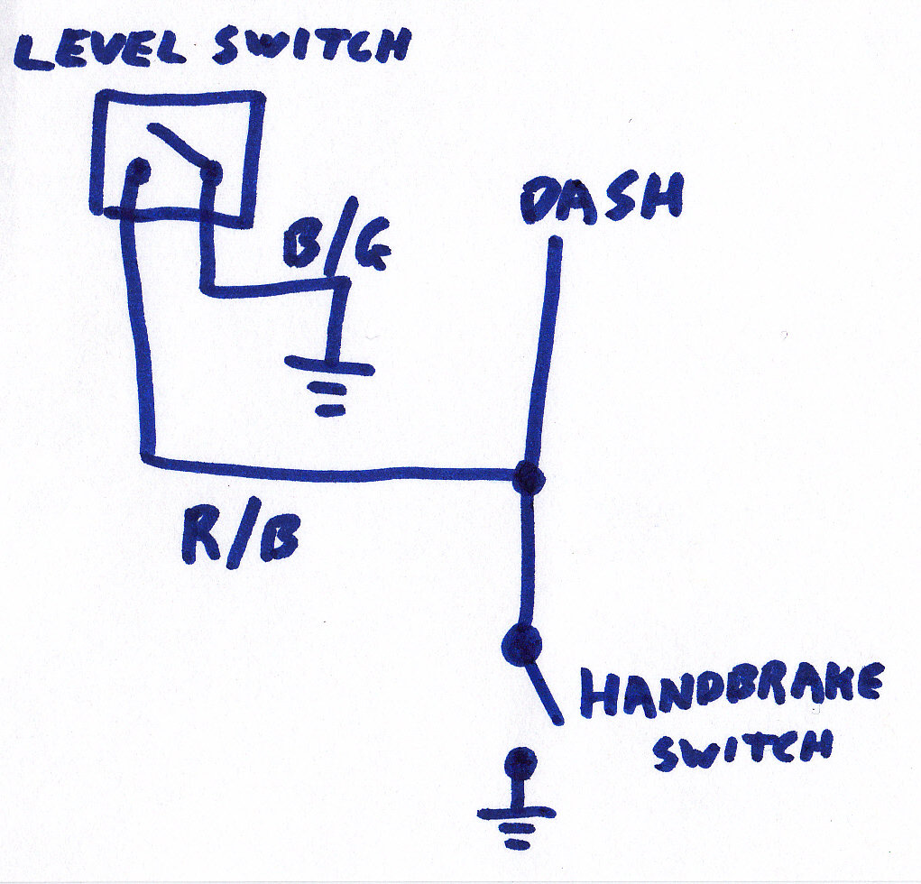

I don't think it matters, as it's just a wire to the switch then earth.
Done this from a 1990 Tracker wiring diagram.
level switch.jpg (175.54 KiB) Viewed 10066 times
And the SJ
sj level.jpg (10.03 KiB) Viewed 10063 times

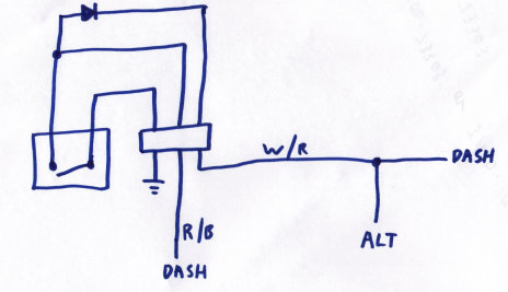

I can't find any vitara diagrams showing this wiring, sorry. The only diagram I can find showing 3 wires is the one in the stickies (none of my diagrams).
I can't understand why the hell it's wired like this :er: :screwy:
WTF level switch.jpg (24.02 KiB) Viewed 10049 times

Darrell wrote:I can't find any vitara diagrams showing this wiring, sorry. The only diagram I can find showing 3 wires is the one in the stickies (none of my diagrams).
Worked it out :oops:
The alternator connection is there because the fluid level light comes on with ignition and reverts to the fluid level switch when engine running.
Checked various SJ diagrams and the 2 wire fluid switch type have the diode built into the combination meter.
None of the diagrams on my PC showed 3 wires to the fluid level switch but my workshop manual does :oops:
It's taken me bloomin ages to work this out and it's still no bloody help to you.
You could work it out with a multimeter but a photo of a vit with 3 wires would save the bother.
