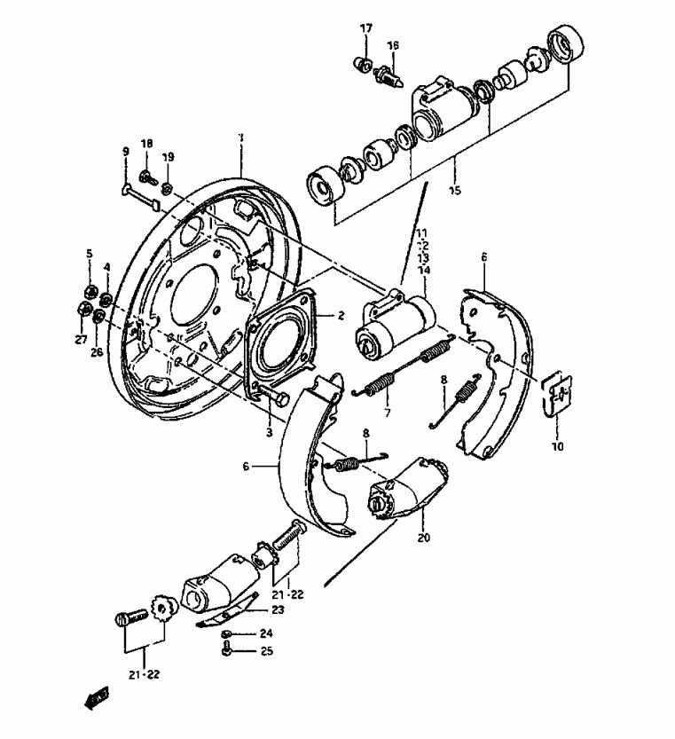

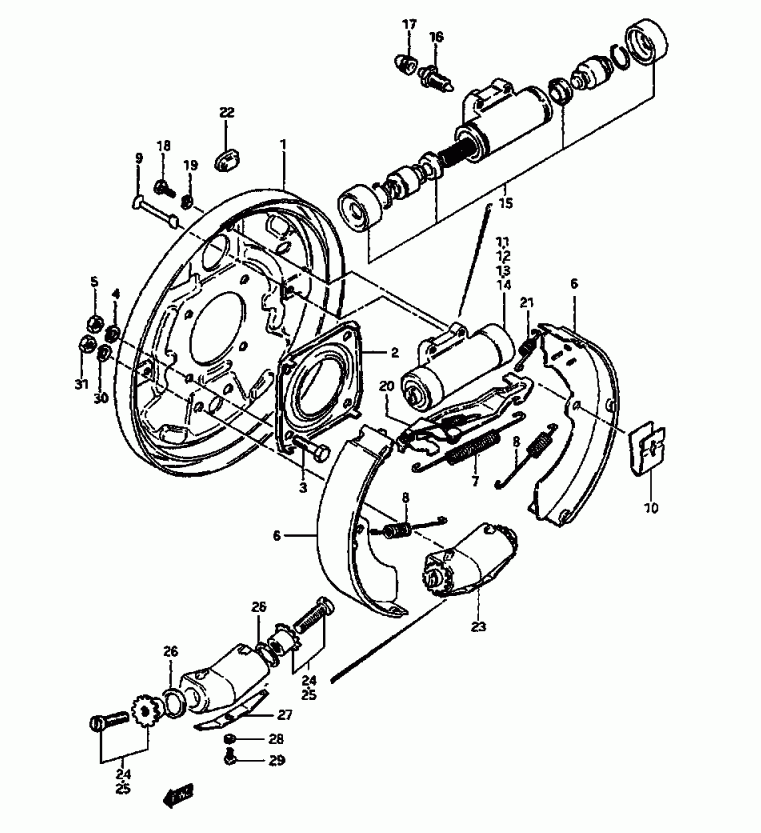

Full service manual can be found here - http://www.4x4.in.th/manual_sj413/
OK a 413 manual but a 410 running gear is much the same.
But after having a look, Scott is correct that the early models are not the same.
So had a shifty and have found these........
looks like the 83/84 model has the self adjusting mechanism (20) and adjustment on the bottom anchor assembly (23)
