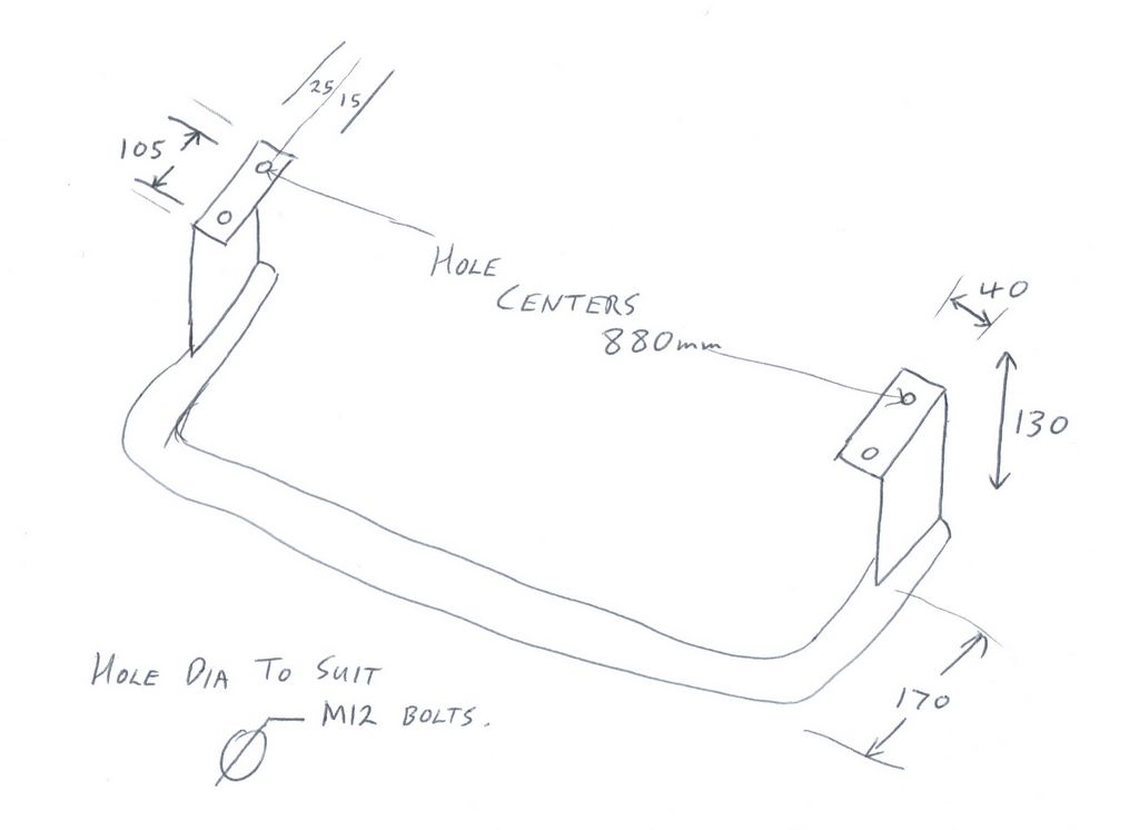

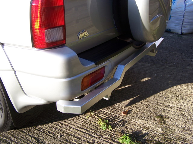

Post by Darrell » Thu Jan 10, 2013 10:01 pm
I've got a 2005 Grand vitara 1600. It had a chrome bar on it when I brought it, but I replaced that with a home made jobbie so the customers at work could hit it like they do on my SJ :evil:
Here's the measurements I took from that bar :thumbup:
rear bar.jpg (36.81 KiB) Viewed 8827 times

Re: vit tow bar
Post by plugspanner » Thu Jan 10, 2013 10:11 pm
thanks
very usefull
