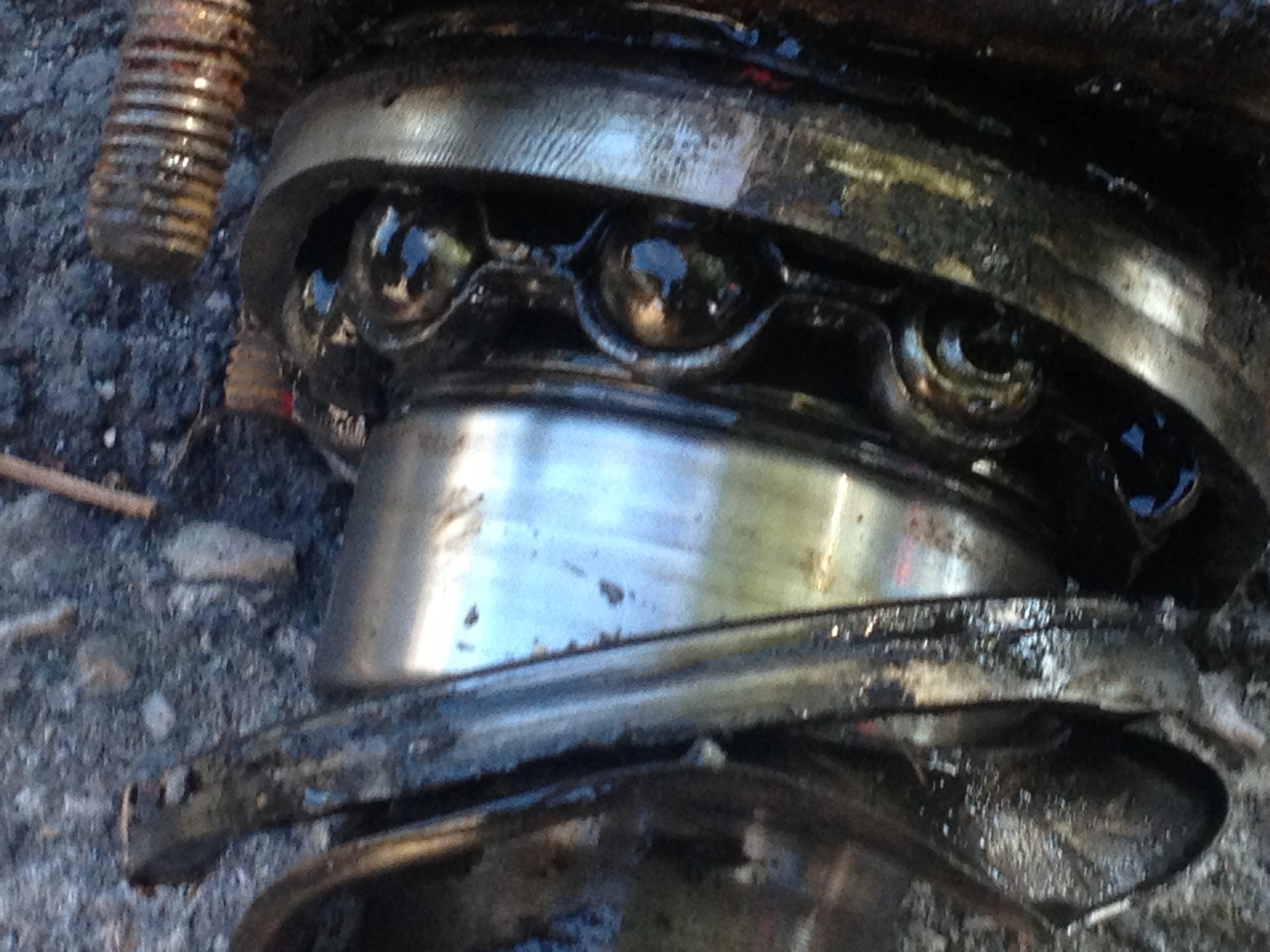

Could be a bearing. I had one crack all the way round the outer race, felt fine when I checked it but pulled it all apart to find what was making the hideous noise and got a surprise :S
