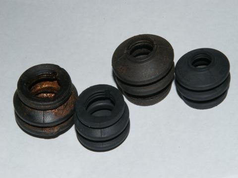

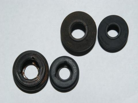

When my front left was sticking to the point of being up drivable I stripped it down, used wire wool to clean up the piston then copper greased it an haven't had any issues since. Rebuild kit sounds like a good idea but not always nessecary .
Re: Steering problem
Not to worry now you have done it, but don't use coppergrease as it makes the rubber swell.
Only use rubber grease on the sliders and don't grease nowt else.
look what it does to he boots given time
