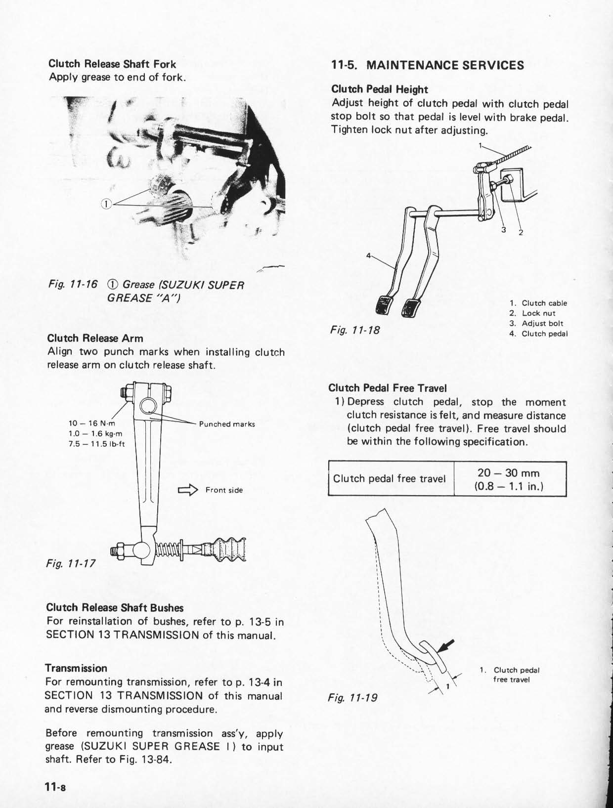

This any help
- Pedals.jpg (276.7 KiB) Viewed 5424 times

Nice one, that adjustment bolt bracket behind the clutch PEDAL was bent all over the place, which was fixed when it was out, probably needs setting correctly. cheers.
ill loosen the cable off, correct the pedal and set the cable again. see how that goes.
