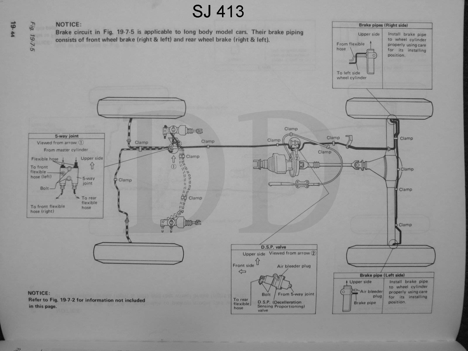

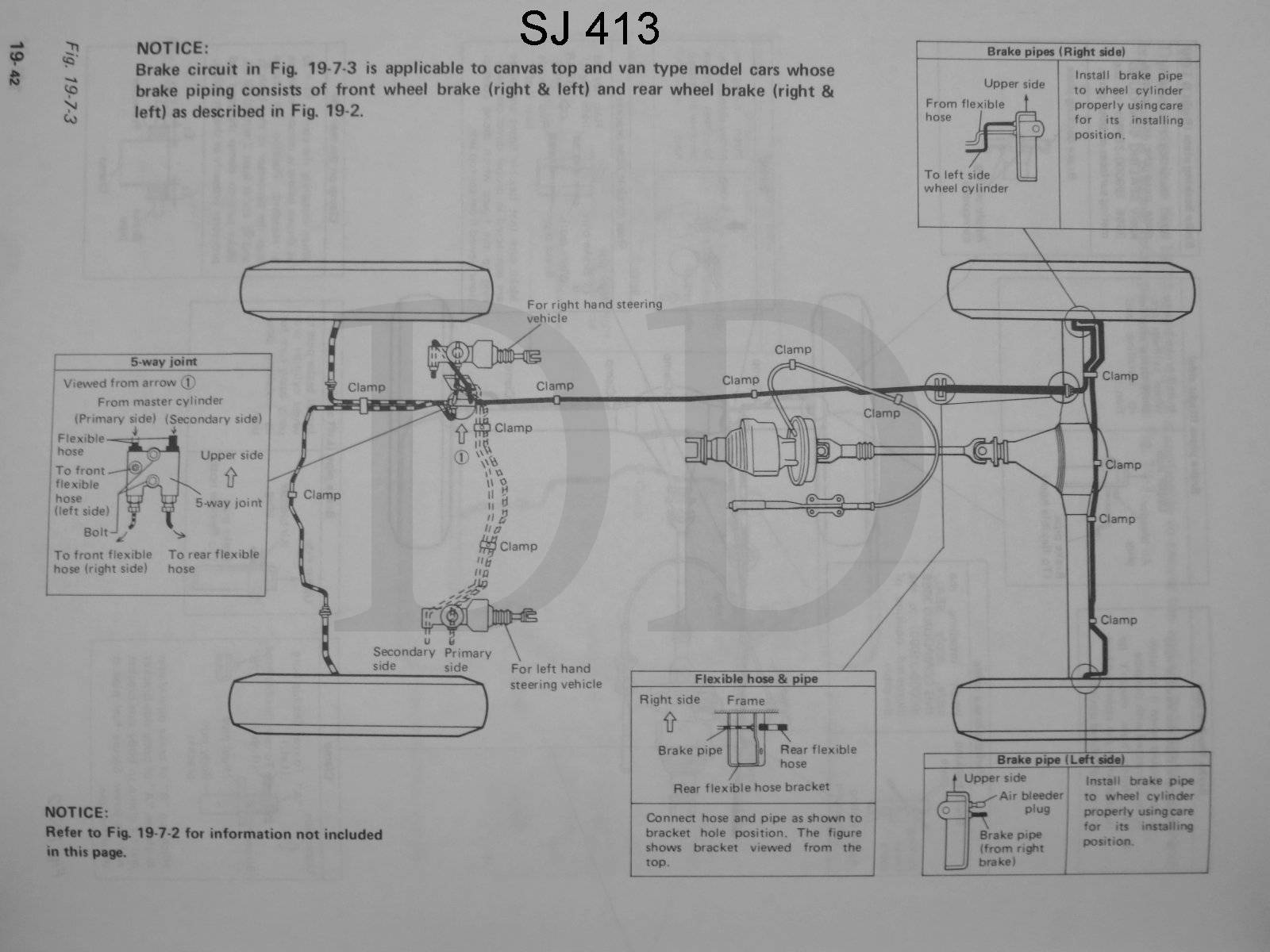

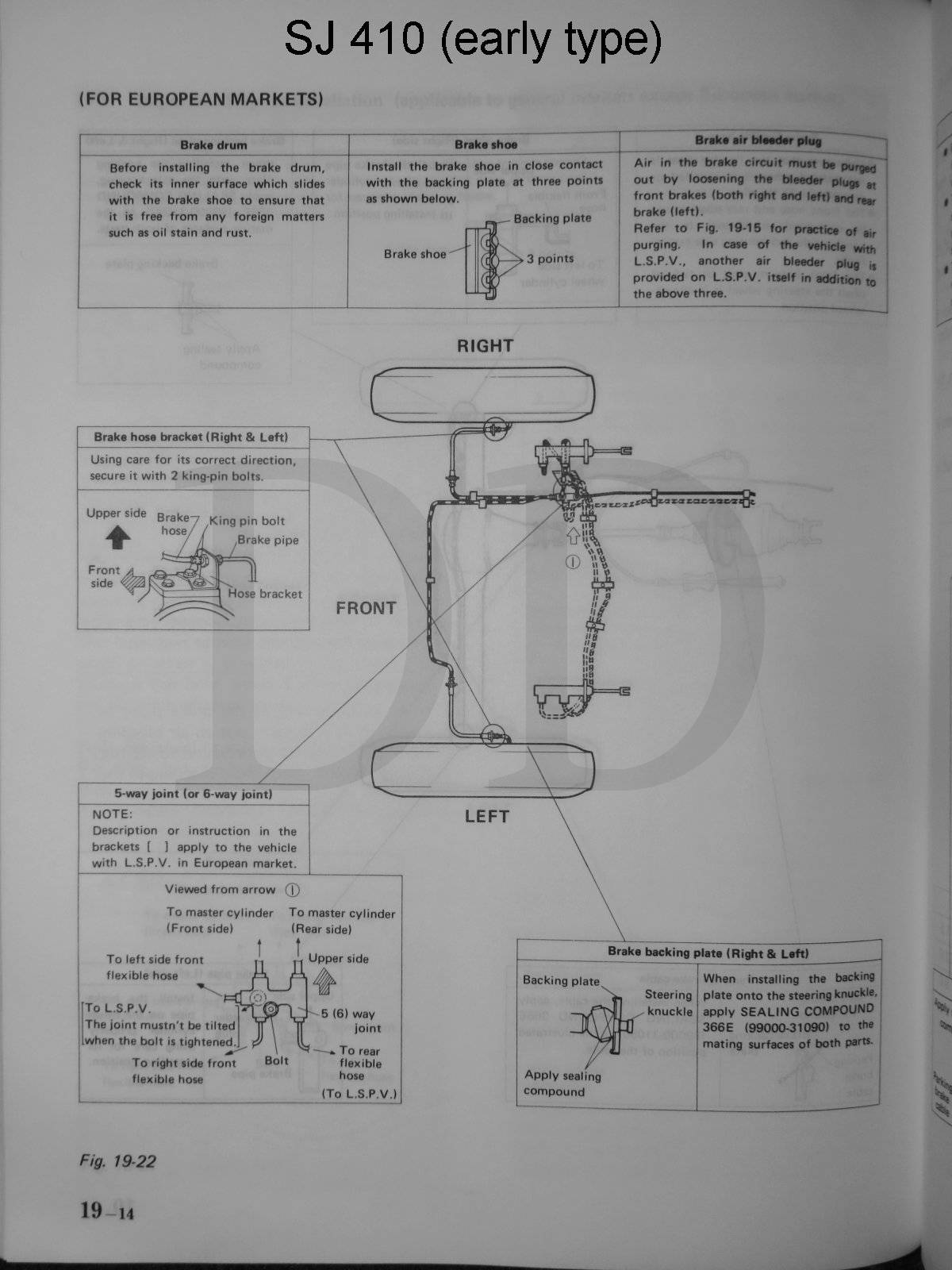

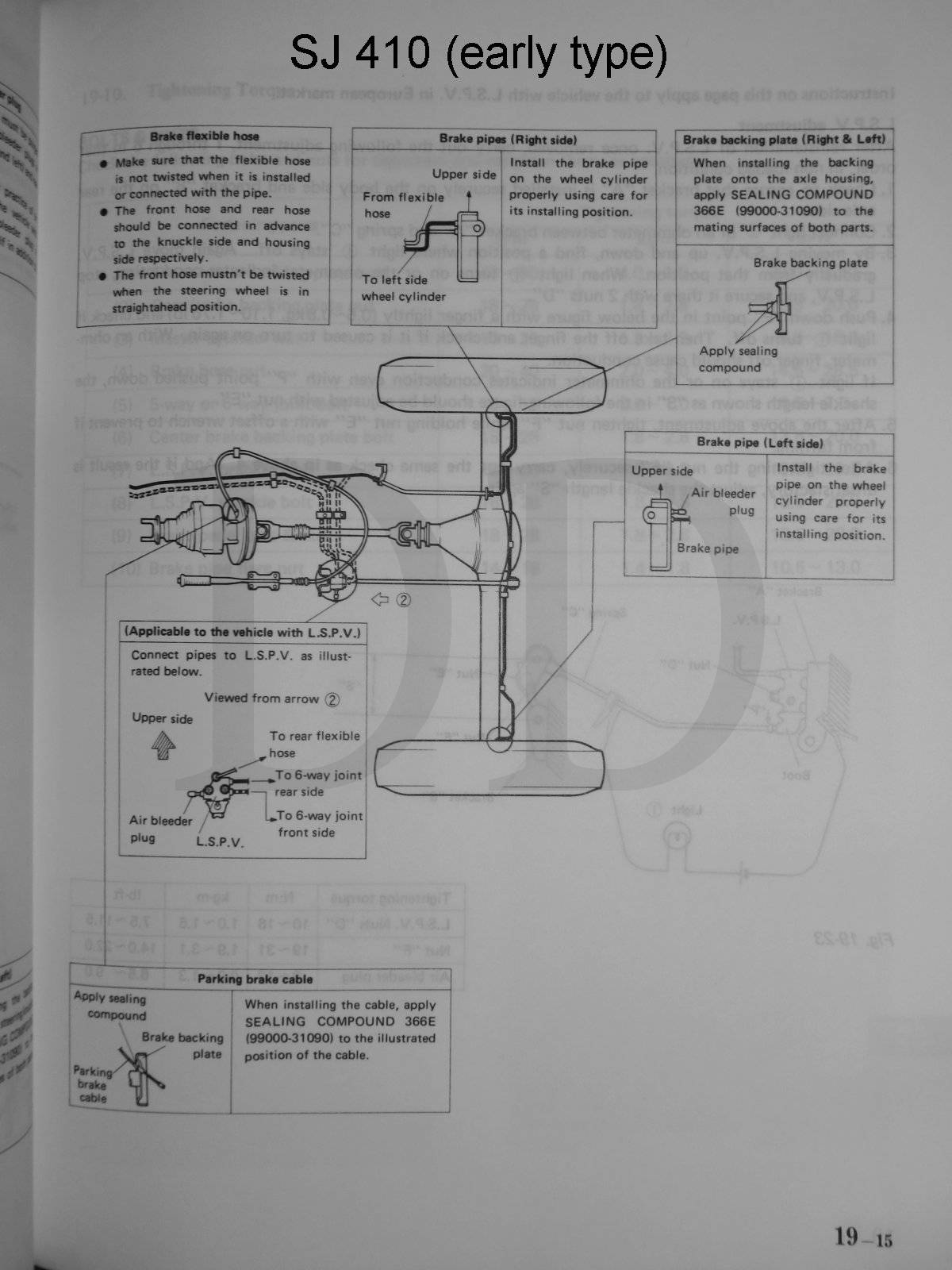

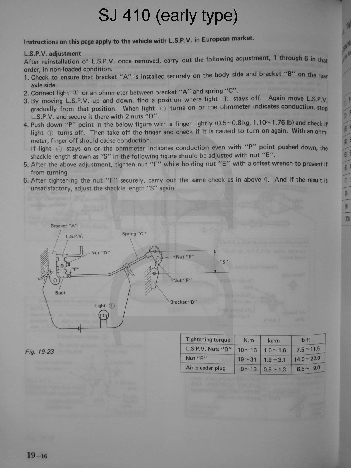

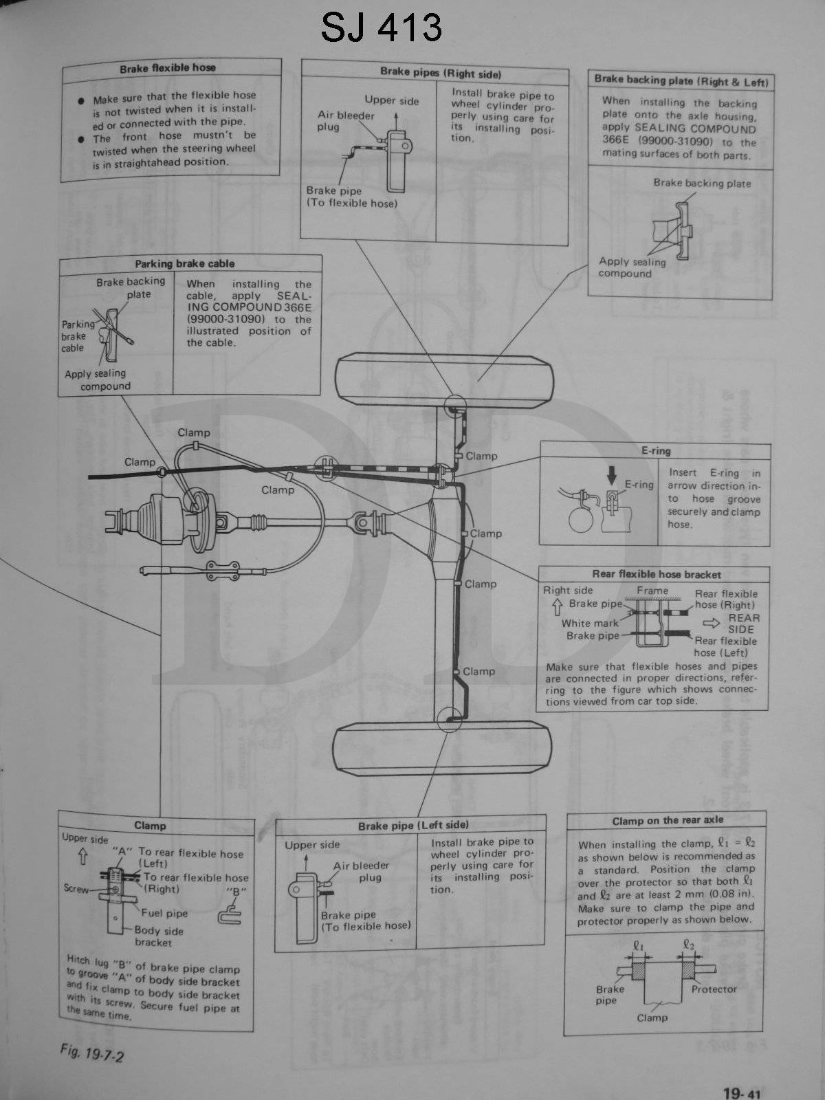

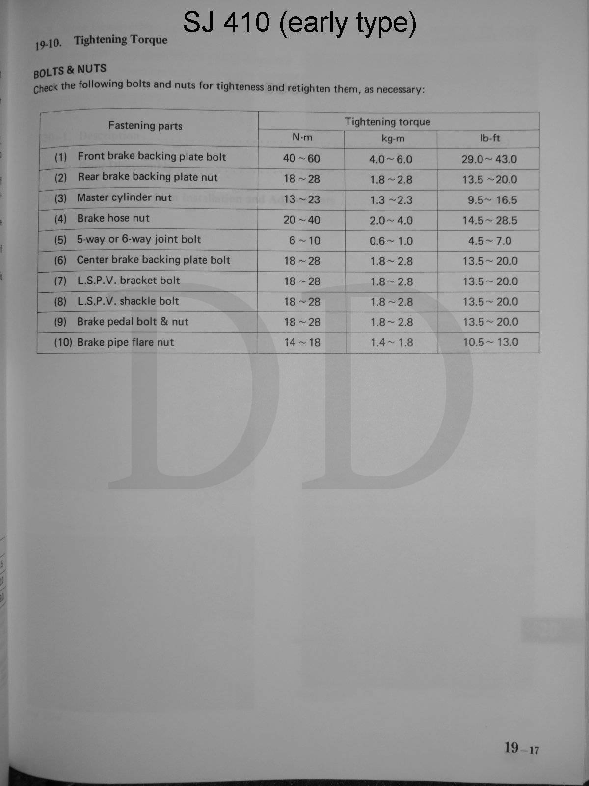

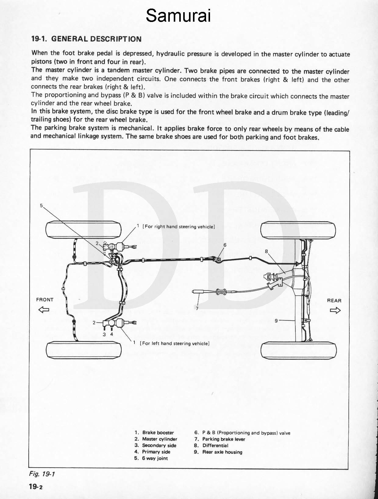

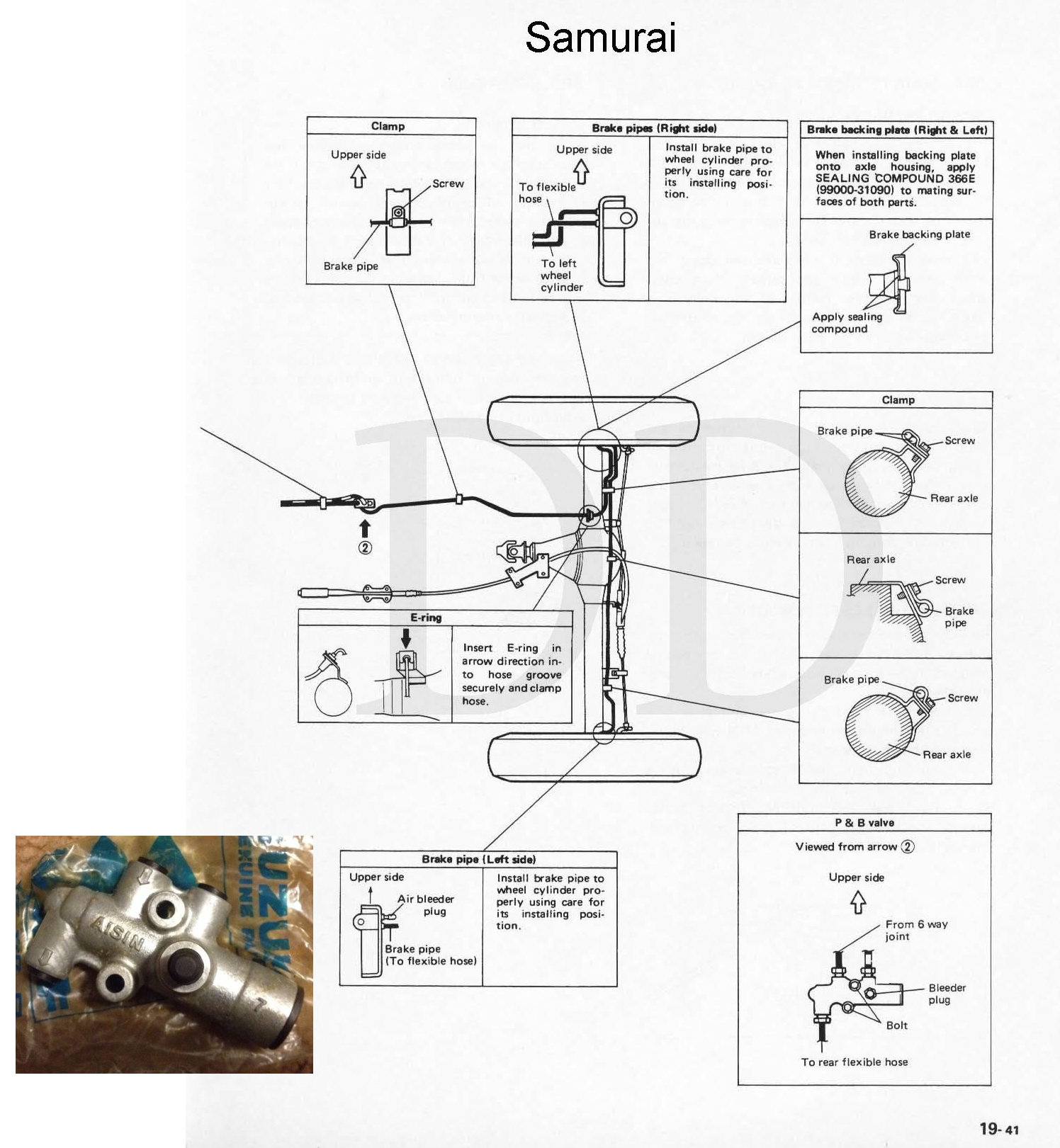

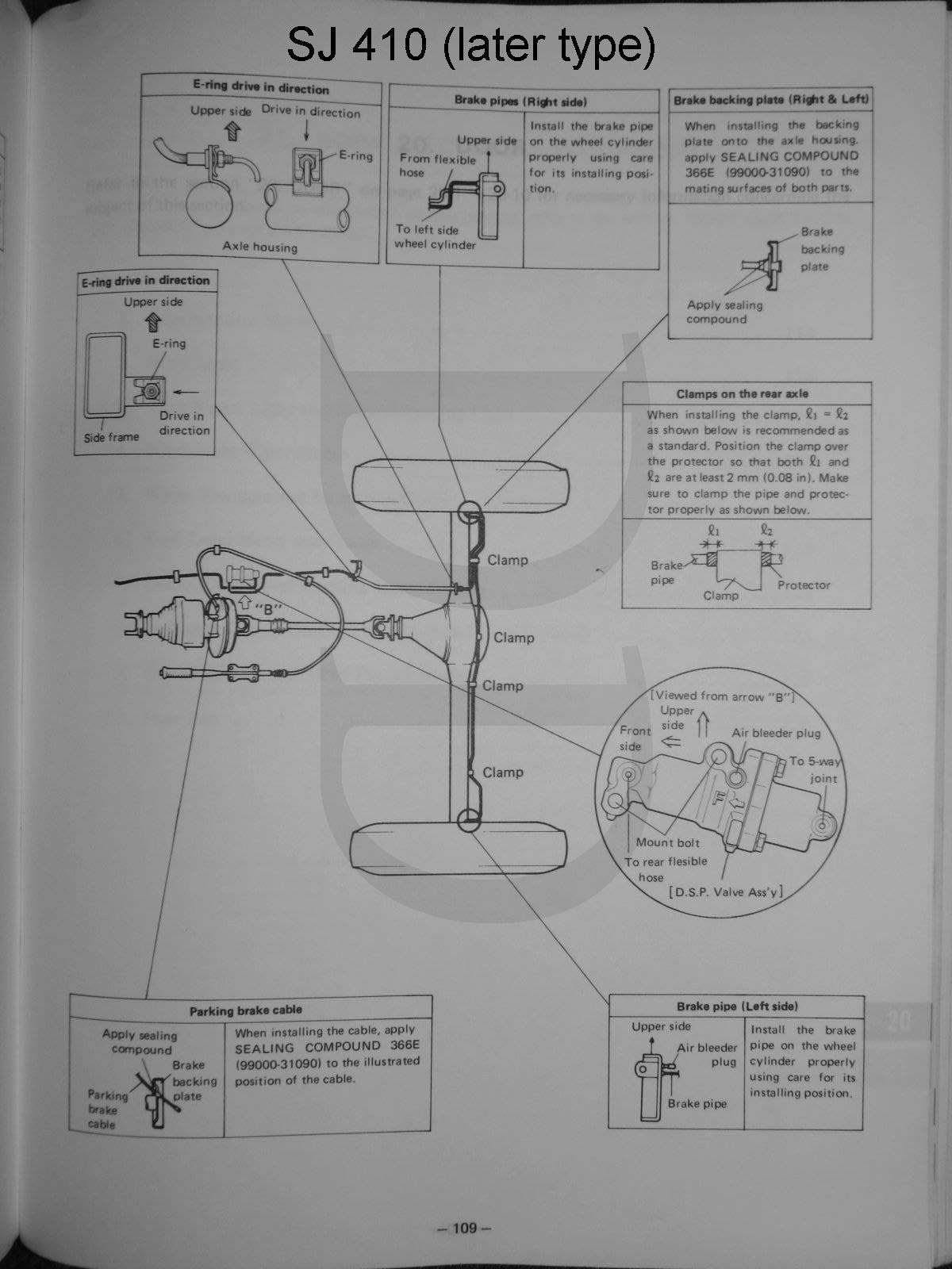

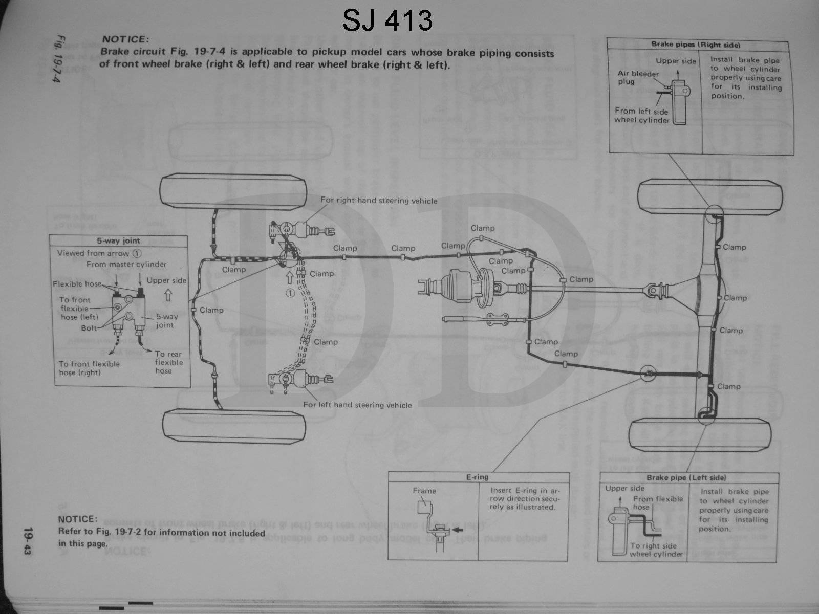

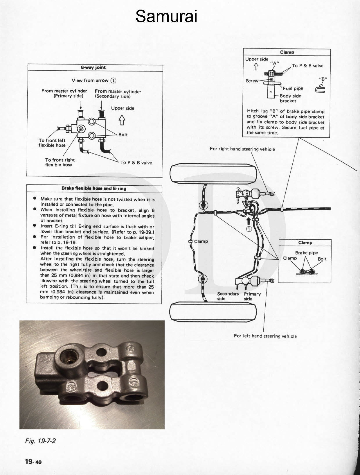

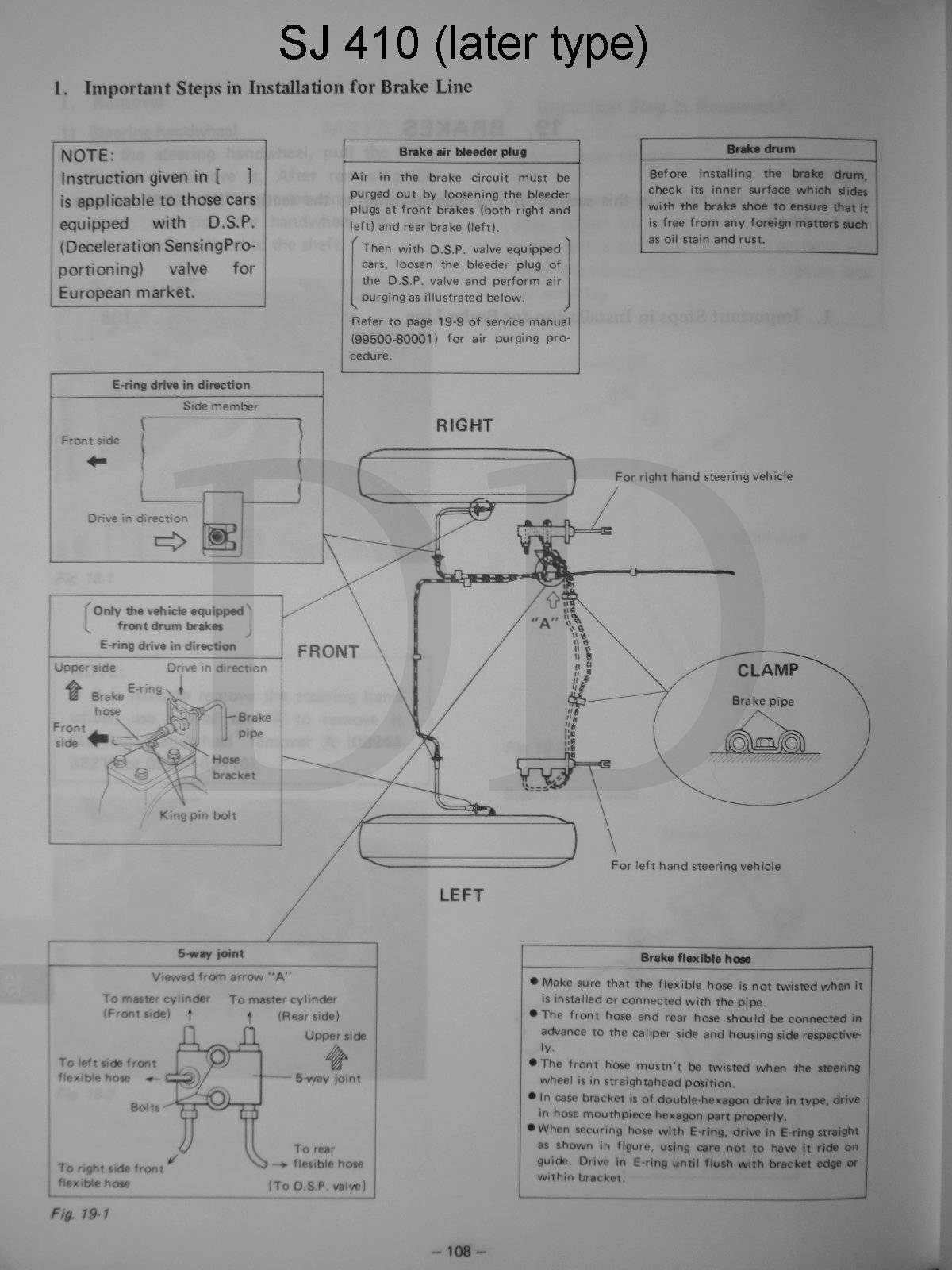

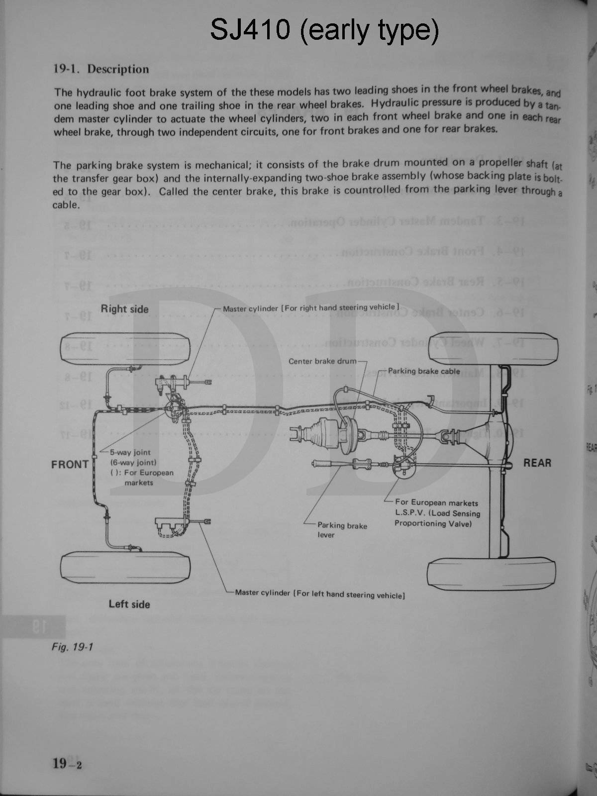

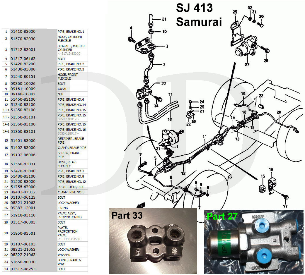

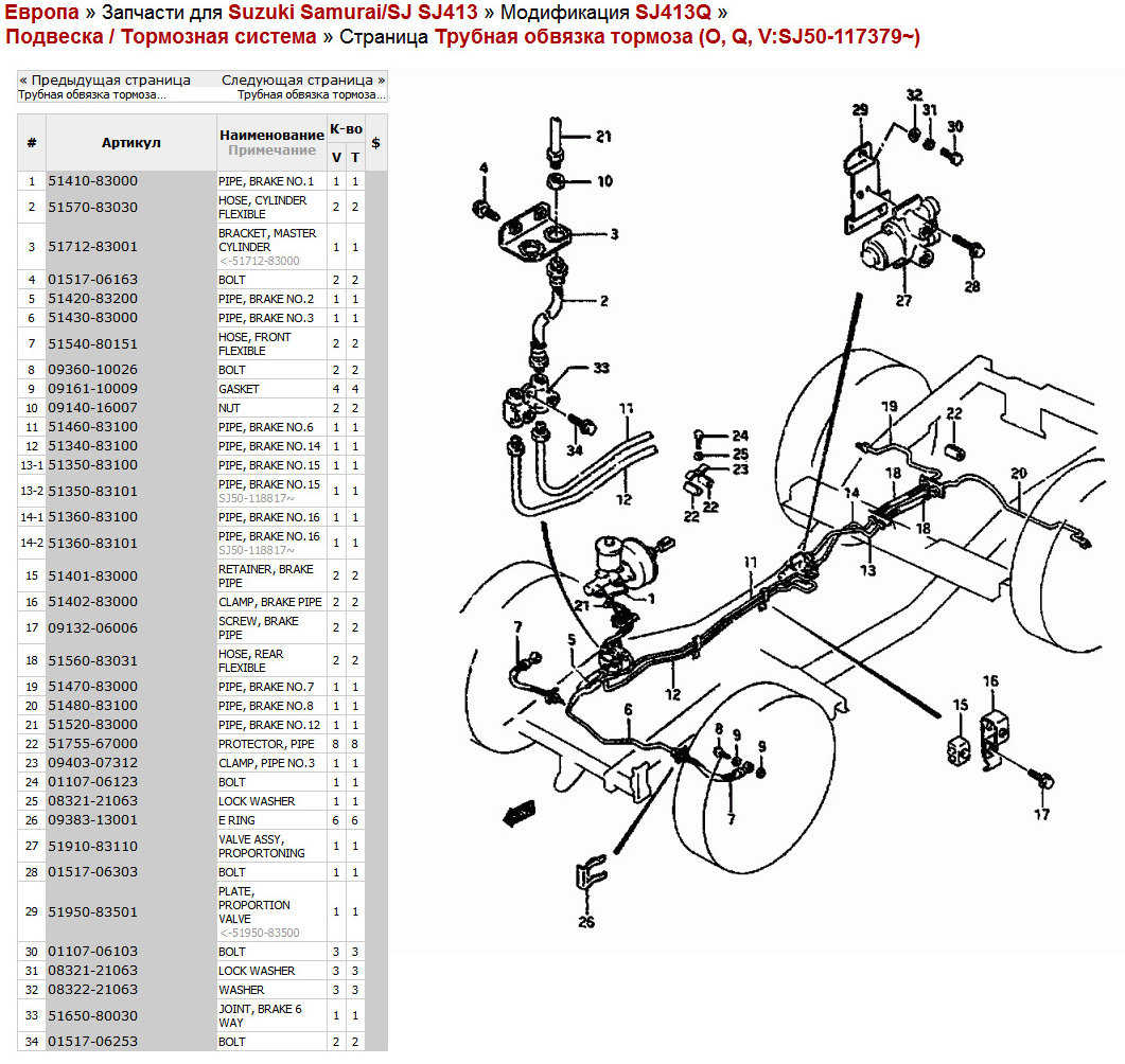

Post by Darrell » Sun Jan 12, 2014 11:27 pm
Thought this may be handy
Sam 3 (2).jpg (298.62 KiB) Viewed 51838 times
sam 2.jpg (257.49 KiB) Viewed 51838 times
sam 1.jpg (183.35 KiB) Viewed 51838 times
Prop valve.jpeg (159.36 KiB) Viewed 51838 times

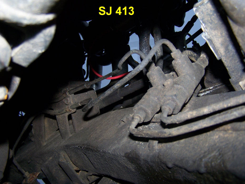

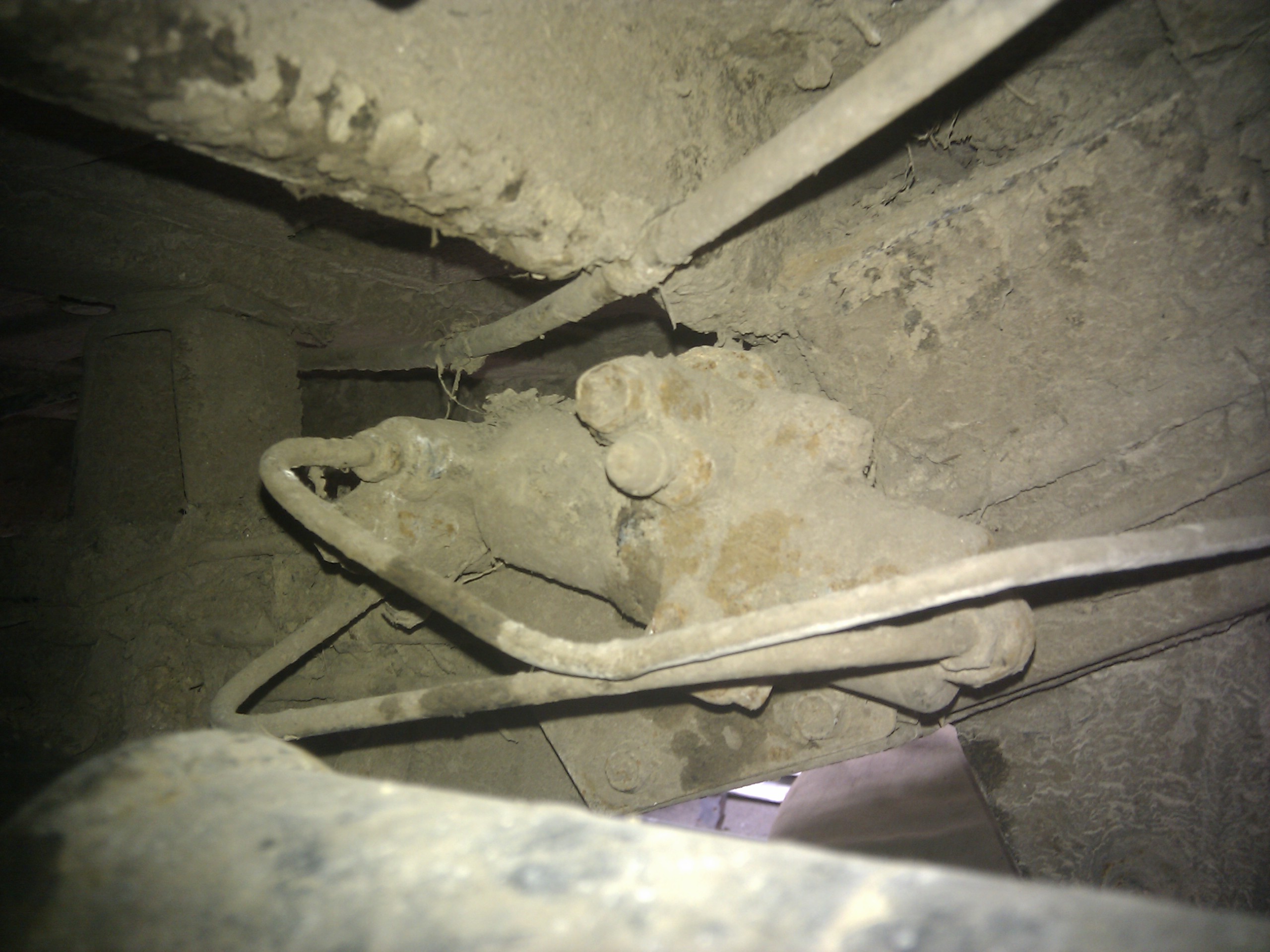

Heres the DSP valve from the SJ 413. £130 from suzuki if you ever need to replace it :shock:
Re: SJ/Samurai brake pipe layouts
Post by Darrell » Mon Jan 13, 2014 8:11 pm
Cheers Ferris, that is not on any of the diagrams above :er:
Listed as just a proportioning valve rather than the "Deceleration Sensing Proportioning " valve.
Wonder why yours has one, I can only assume your 6 way block doesn't have it built in.
Blooming Suzuki, what they gonna bung on next. This is proving not a easy as I thought..
Post by Darrell » Mon Jan 13, 2014 8:18 pm
Only photo I can find of the DSP valve is this dirty one of Tim's :thumbup:
http://forum.suzukiclubuk.co.uk/vi ... =14&t=7312
DSP valve.jpg (676.74 KiB) Viewed 51794 times

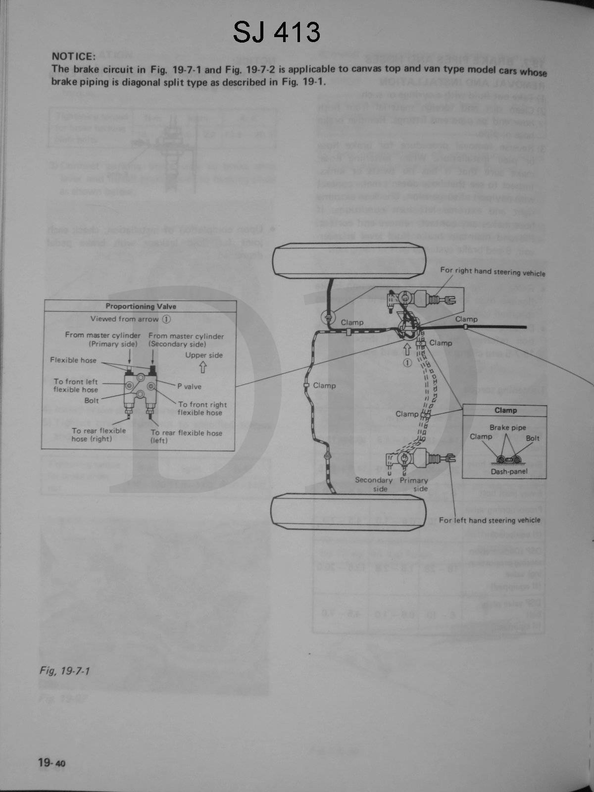

Post by Darrell » Mon Jan 13, 2014 8:56 pm
So we have this layout as well..
Proportioning valve.jpg (332.83 KiB) Viewed 51773 times
