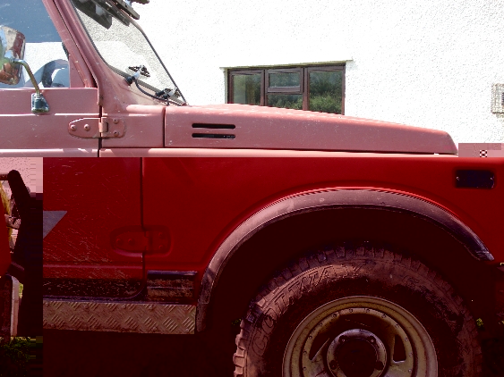

Well iv only done one panel so far. I haven't got a before picture, but it was in quite bad condition with a few rust holes in it. Here's a picture of it after, its only primed but the red oxide primer i used is nearly the same as the original colour any way.
The plan is to get rid of the rust, and prime it one panel at a time. Then hopefully borrow a compressor and spay gun, off my brothers mate and do the top coat in one go.

carnut
Posts: 361
Re: What paint
Post by carnut » Mon Aug 10, 2009 5:30 pm
l@@ks good!!
liljitjit
Posts: 169
Joined: Sat Nov 01, 2008 10:08 am
Location: stoke on trent / crewe
Re: What paint
Post by liljitjit » Mon Aug 10, 2009 8:08 pm
sweet that looks good
