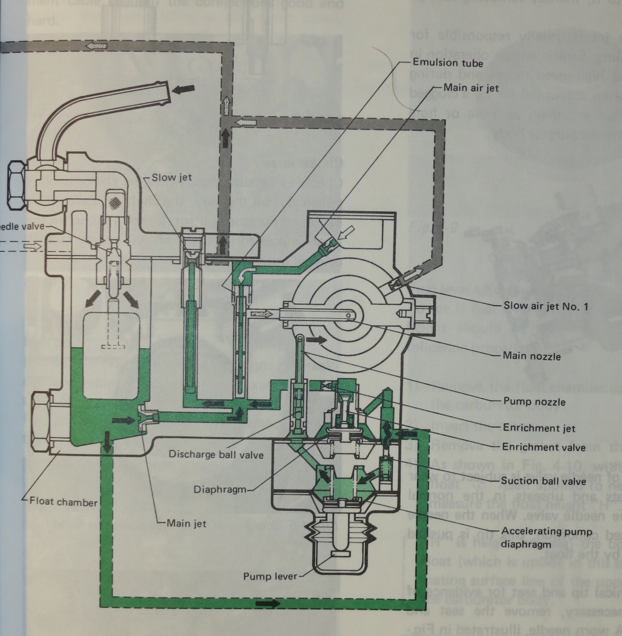

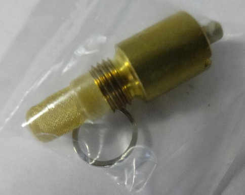

what the service manual and the internet doesn't tell you though is that there is another filter that sits above the inlet to the float chamber. Its part of the bronze fitting the float valve needle operates on.
Once I had that apart and cleaned, no problems.
As I said, its not in the suzuki service manual that I can find, so I hope this helps someone.

Armed with your info I though I'd have a shifty. Does kind of show it in the manual but no mention of it.
Cheers for the info :thumbup:
