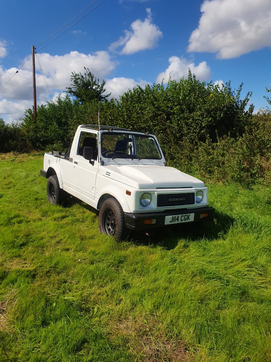

Great looking truck! Really missing my LWB!

That is very tidy.
