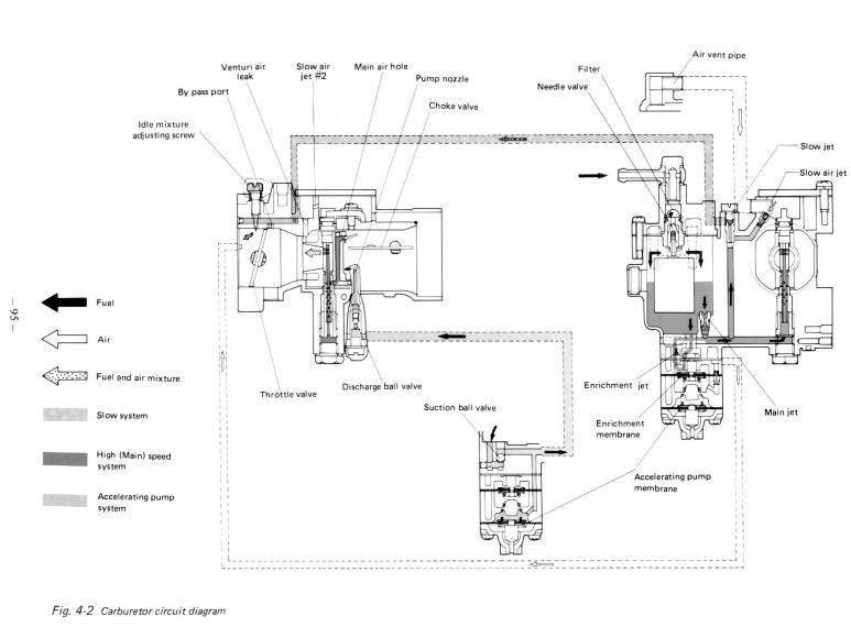

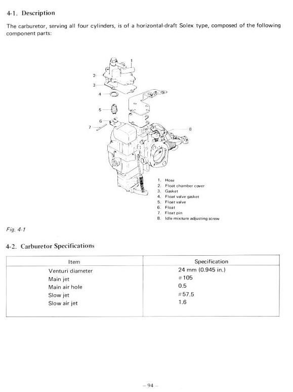

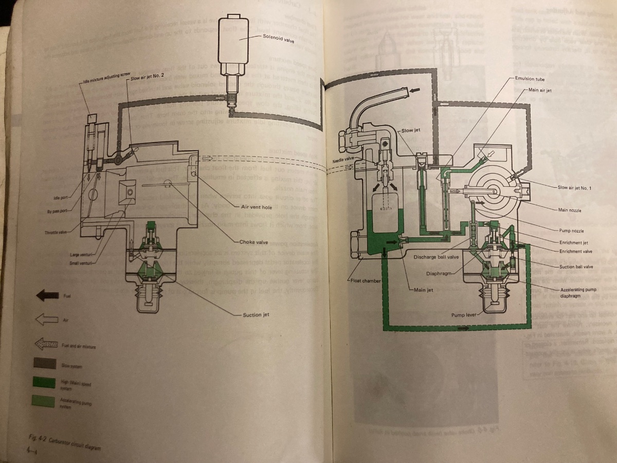

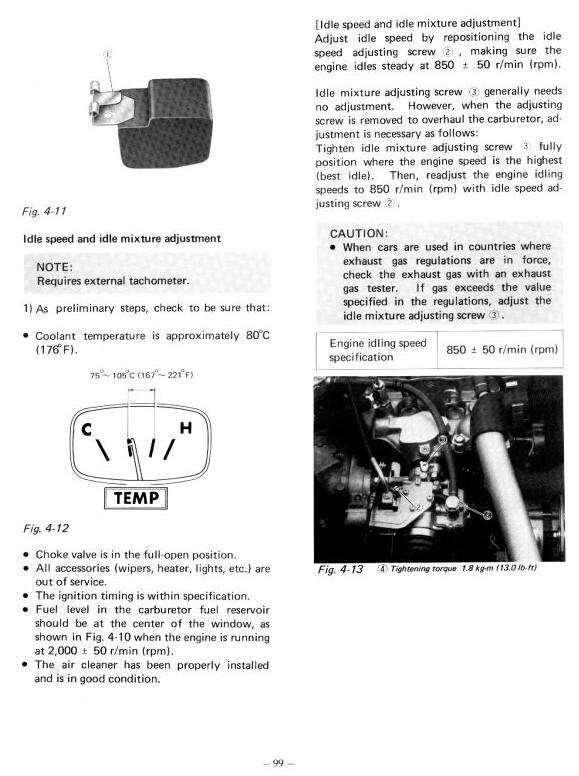

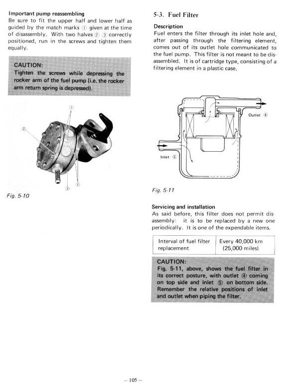

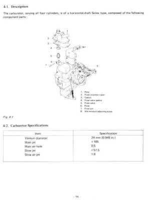

Hi from New Zealand. Unlikely to help as it's for a LJ80 but here are pages from sections 4 and 5 of a manual - Carb and Fuel related.

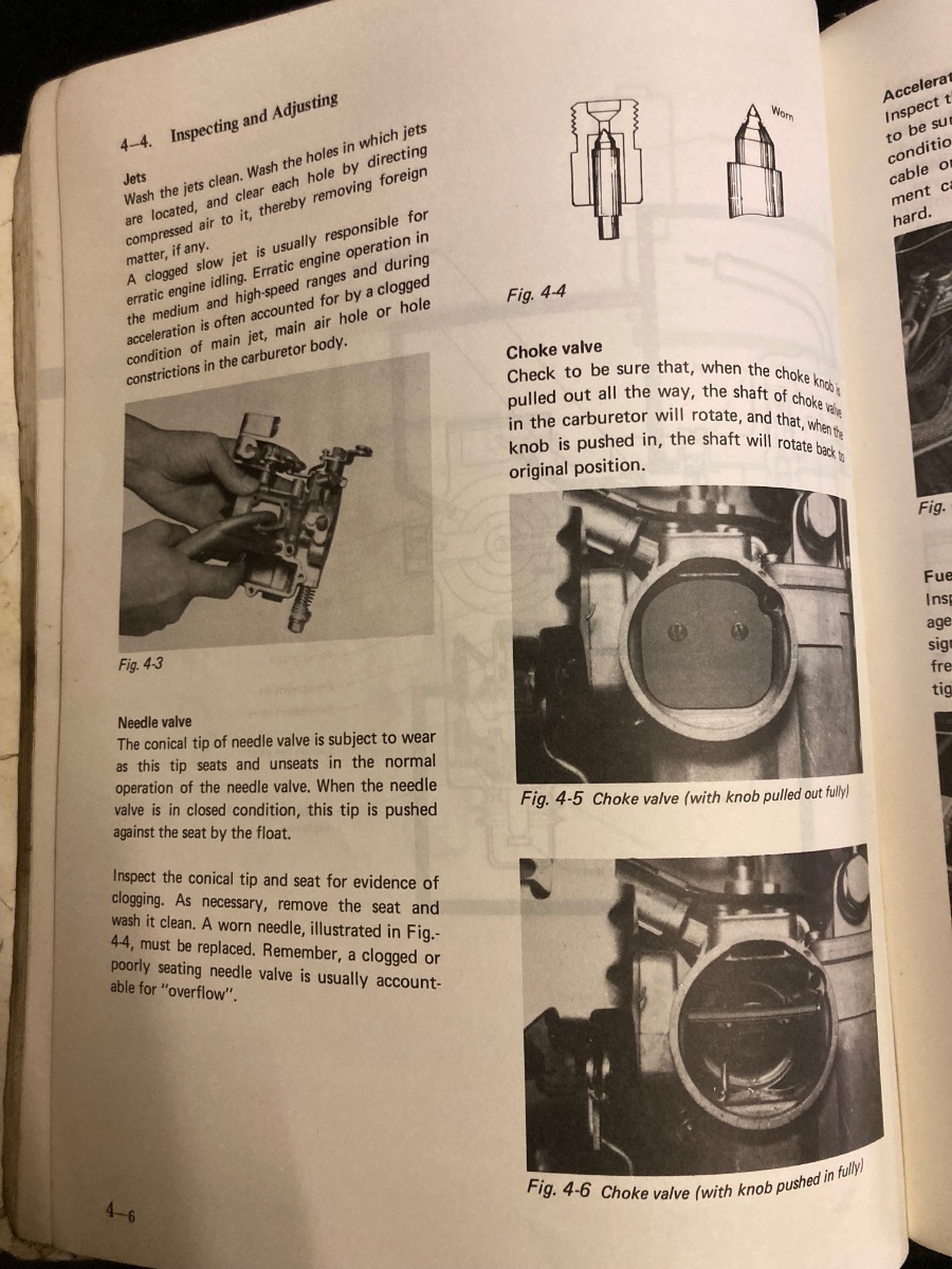

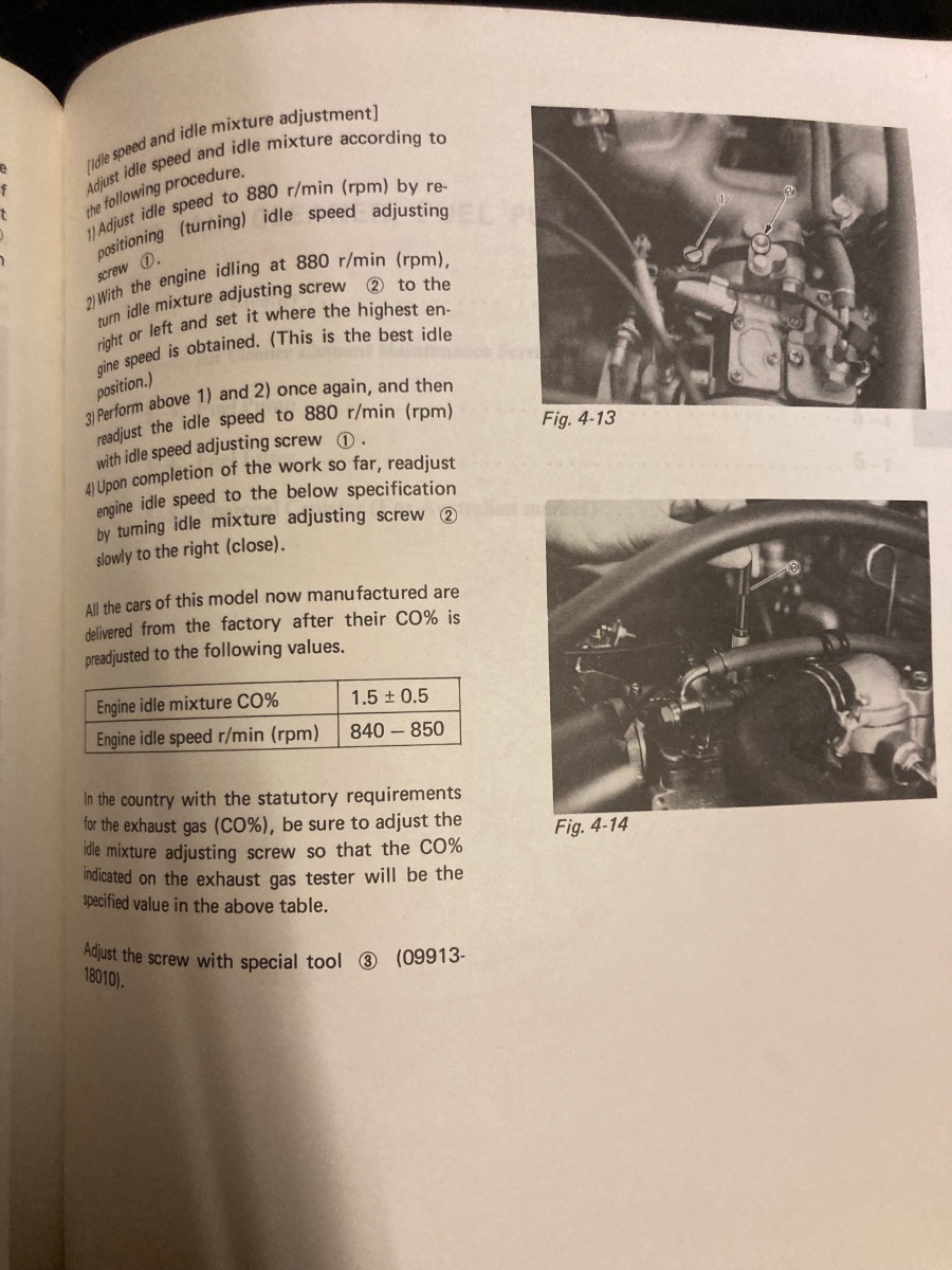

Post by ScottieJ » Fri Jan 03, 2025 3:53 pm

Thank you very much for the info. I'll have a read through
