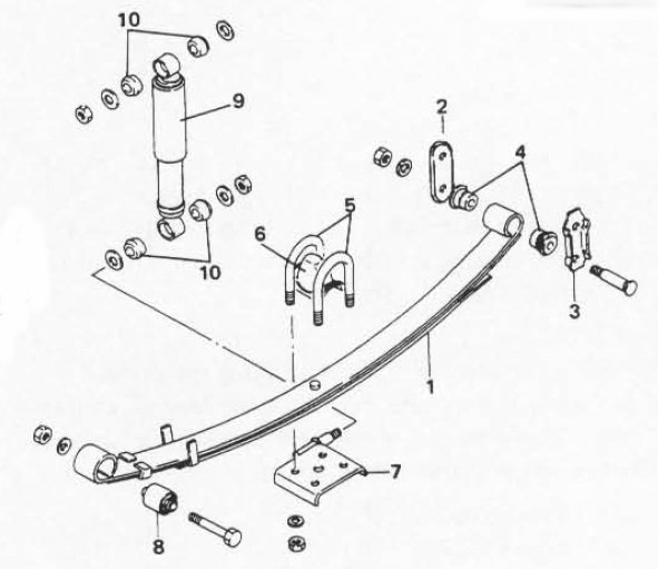

Would I be able to change the rear leaf bushings using just the jack?

You need to be able to jack under the chassis to swap the spring bush over (number 8). The problem you may have is the bolt being rusted into the bush sleeve. If this is the case normally people cut them off and use a new bolt on assembly. (does the new bush have a sleeve set into the rubber or are you fitting polybushes with a separate sleeve). If it still has the original suzuki bushes these can be difficult to remove, easy enough if you have some large sockets and threaded bar though.
- spring.jpg (36.27 KiB) Viewed 16518 times

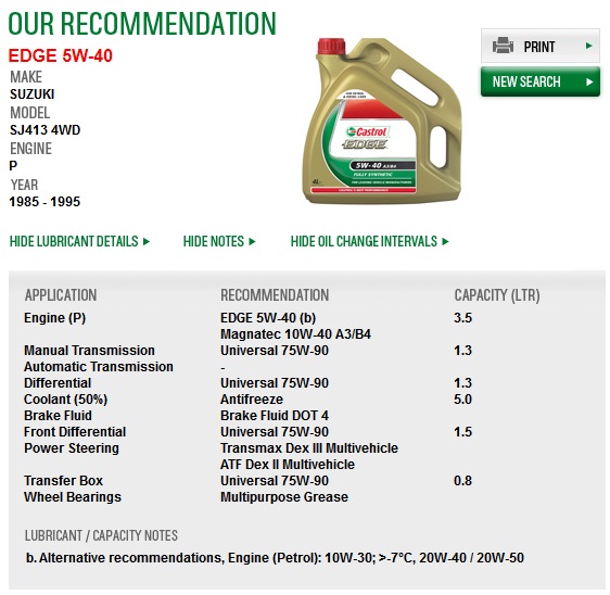

Had a look on Castrol website. Recommend 5w/40 fully synthetic (edge) or 10w/40 part synthetic (magnatec)
Not sure what to say really, lets see what other people run in there's --------
I use "Morris oil" part synthetic 10w/40 just because that's what brand my local motorist shop stocks.Not sure what to say really, lets see what other people run in there's --------

Thanks for all the pointers for these jobs ages ago. I finally got around to them last weekend and was delighted to find the belt comes over the fan. As I don't have a lift I brought the SJ round to local mechanic to do the bushings. Naturally he had major problems getting the old ones out but the issue now is that the large eye leaf spring bushings (41331-62020) I got as replacement don't fit. The body diameter is 40mm on these but the eye, with old steel sleeve still installed is a few mm tighter. So I'm faced with having to try and find a slightly smaller bushing or sand a few mm off the new one (which I presume will effect its characteristics). Just wondered had anybody this issue of 40mm bush not fitting?
