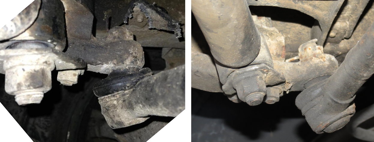

Post by Darrell » Sun Apr 06, 2014 10:58 am
Here's a piccy of mine. Looks like that bit in red is what's left of the cover that's under the radiator.
sj pitman arm.jpg (108.1 KiB) Viewed 4664 times

Re: 'Rumble' and vibration problem - FOUND THE FAULT!
Post by mmac78 » Sun Apr 06, 2014 11:03 am
ohhhhhh so it had some sort of cover then? it looks ok then... I've never had an SJ before so a complete noob with it to be honest. I presumed it had come away from the body.
Thank you for the pic to compare, appreciate it.

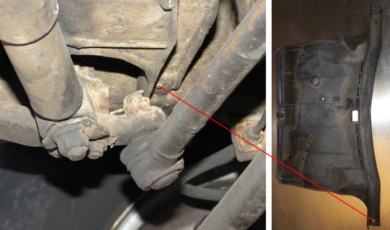

Post by Darrell » Sun Apr 06, 2014 11:59 am
I think somebody has hacked it off :D
I don't think it's worth the bother of finding another.
SJ Splash guard.jpg (182.26 KiB) Viewed 4660 times
Post by mmac78 » Sun Apr 06, 2014 12:39 pm
ah ha! ok thats that sorted then :) honestly thought I broke something lol
