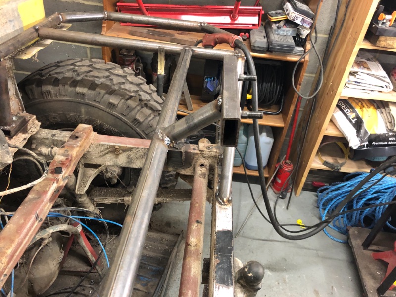

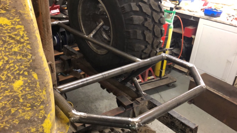

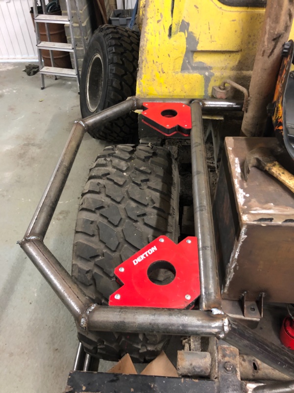

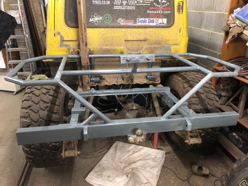

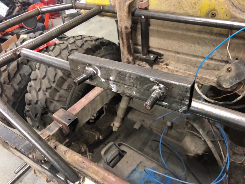

Little bit more. Added some front to back support bars for when i fit a deck to it.

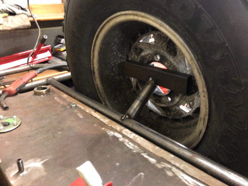

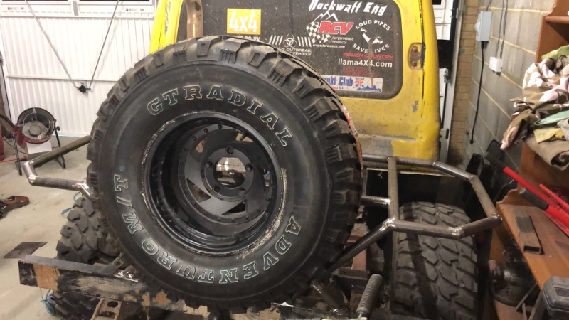

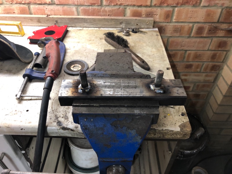

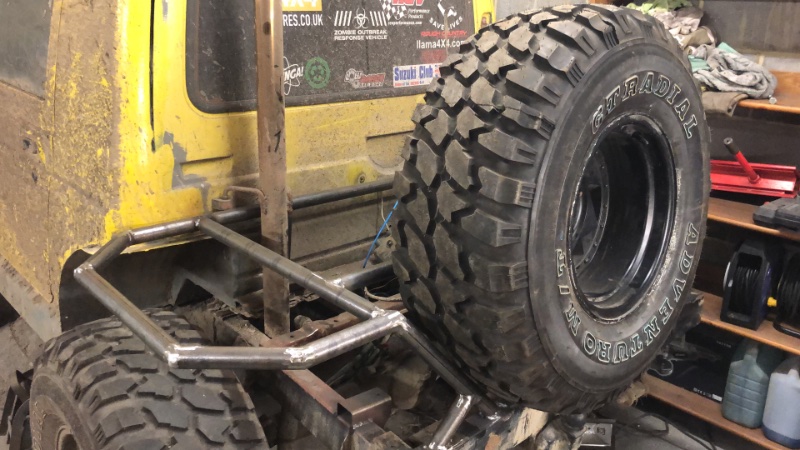

A cross bar to lean / mount the spare wheel to. Made a spare wheel mount.

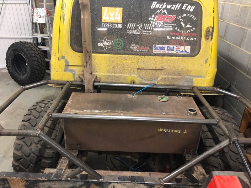

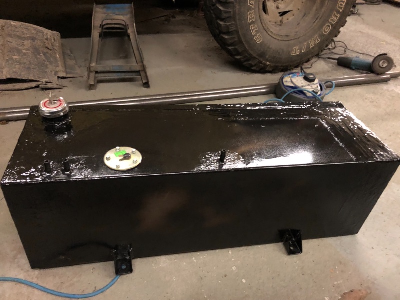

I have taken the fuel tank to be pressure tested and if needs be coated.

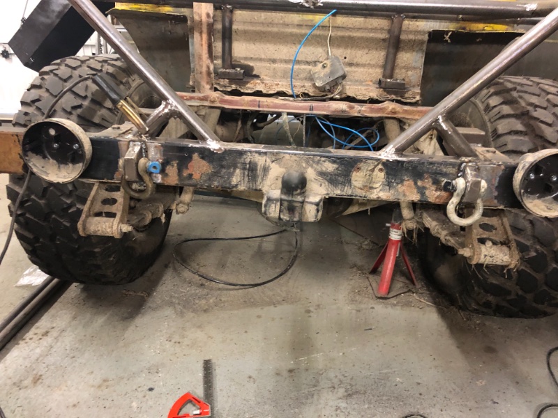

Just contemplating rear lights. To keep it nice and tidy i am very tempted to copy Scottie and get some original SJ lights and recess them into the bumper, the same as he has done into the tailgate.

Just had the call from the fuel tank people. Much to my amazement my home made tank has passed its pressure test, shot blasted and coated.
Very happy with that, had a terrible feeling as soon as it was pressurised it was just going to split at the seams.
Get that collected and soon as all the welding on the back end is done i can fit it, put some fuel in it and move onto getting it serviced and MOTd!

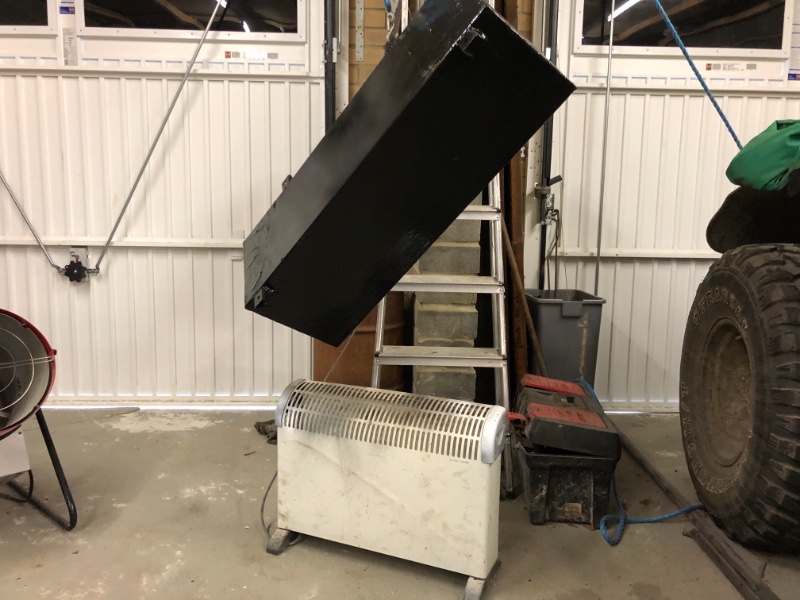

Little bit more done, finished the welding. Coat of primer and black gloss on the fuel tank.

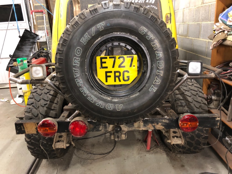

I couldn’t decide what to do, or where to put the lights. I looked at new lights and couldn’t find any i liked, or that fit where i wanted them. So i’m just fitting the lights i already have for now (or the next 10yrs maybe).

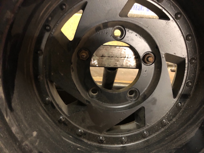

Number plate is going to be located in the spare wheel, cut the corners for a better fit, light is mounted to it.
Because it was so cold i left the tank above a heater to warm up before painting. I also had to leave the aerosol in front of a heater too, due to the cold the propellant must have contracted and it had lost all of its pressure.

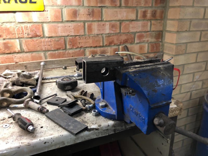

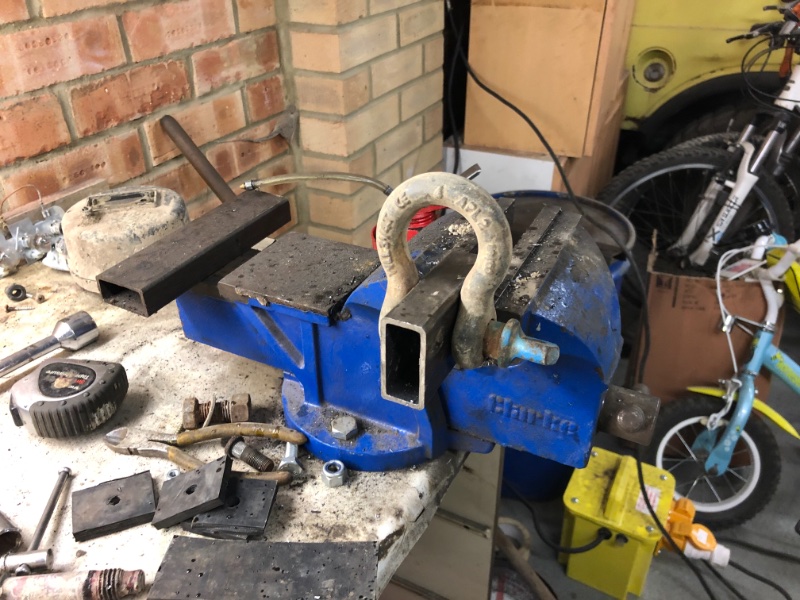

Made a start on some weld-on shackle points made from 50x25x3mm box. 19mm hole and a 3 3/4t shackle.

Recovery points welded on and one coat of primer done.
