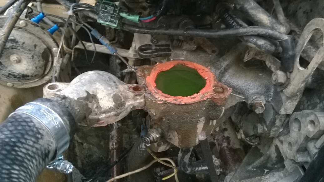

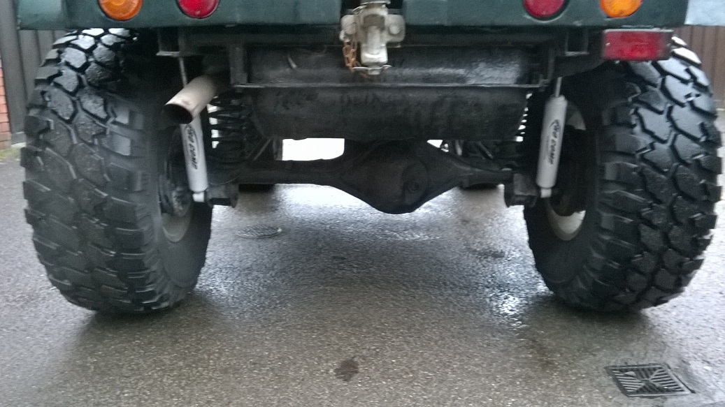

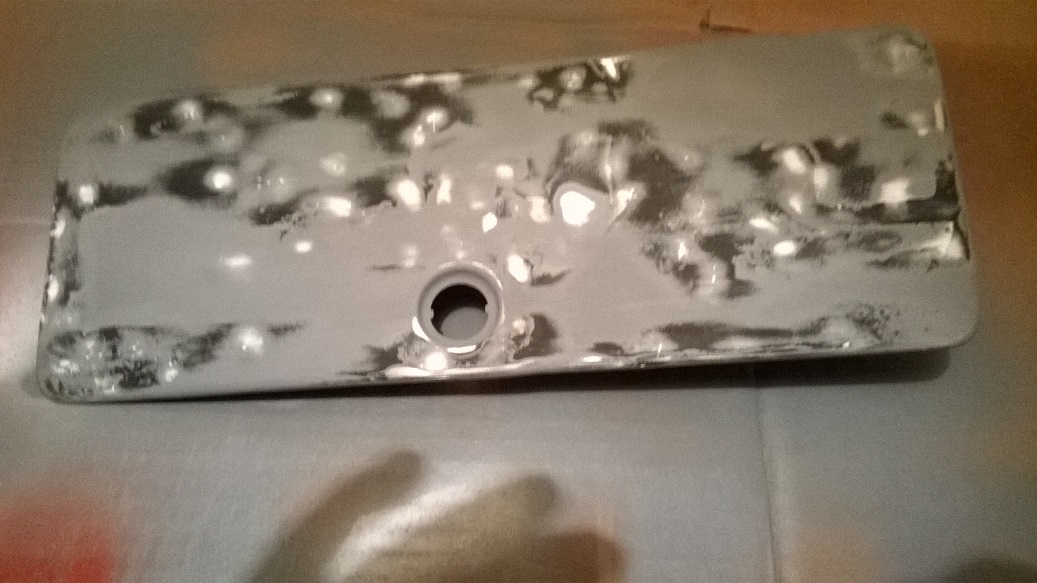

Did a few jobs today, the heater is feeble so I thought I'd put in a new thermostat...and it doesn't even have one, and the new one was too sodding big. Why is it every part I buy is wrong? Put my Pro Comp stickers on, mainly because they are PC shocks lol (honestly, not KYB). Explorer 9000. Yes one is leaking a little...put on a door lock (cheers Mike) so at least she's sorta secure now...

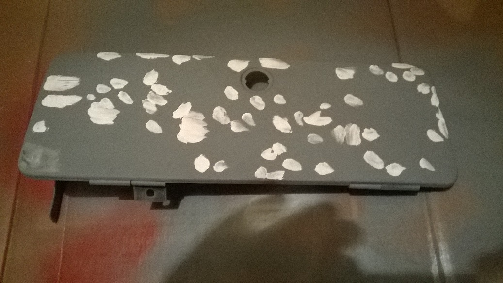

Got the glovebox lid here at home to fill and sand down, much comfier than the garage.

Es9000 are a bit stiff for a light vehicle aren't they?
1000 or 3000 are better suited to LJs and SJs

Are those actual procomps, or just generic ones with stickers on them like the vitara?

Yes it is very stiff and KYB's will be going on when funds allow.
Yes Anton REAL Pro Comps on every corner (same as the blue LJ).

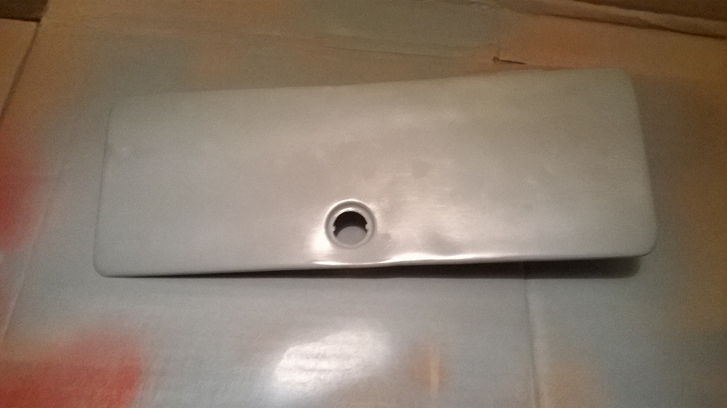

Almost finished the glovebox...

Was given yet another incorrect stat...took it back and had a look at their stock and found the right one. Bloke says it won't fit and can't understand why I am returning the one that doesn't fit! I even showed him a photo of the stat in Piglet 3 and his one side by side...still insisted he was right.
Well, he wasn't.
New thermostat in and she runs at the correct temperature now, half way up the gauge, unlike very cold before. And the heater output has doubled! Bonus!
