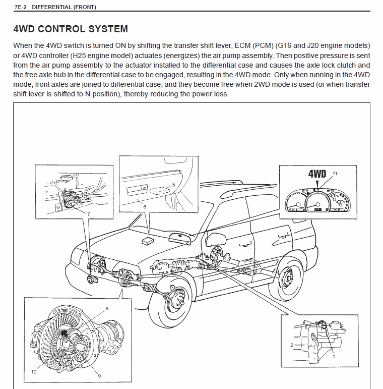

Looking at the page on the 4wd system ,got me wondering ...is the air pump vulnerable to damage from water (wading up to 2ft deep etc.)? or are the electrics well sealed?

Not sure what you mean by air pump, I use that on my bike, but 2ft of water is no bother. I would get diff breathers put on though.
Re: grand vitara 1.6 newbie
Post by Anton » Sun Nov 16, 2014 12:19 am
I *think* the vacuum comes from the same place the brake master cylinder gets it's vacuum - that is to say, the engine itself, via the intake manifold. So there's no pump.
Could very easily be wrong though.
Post by Darrell » Sun Nov 16, 2014 12:27 am

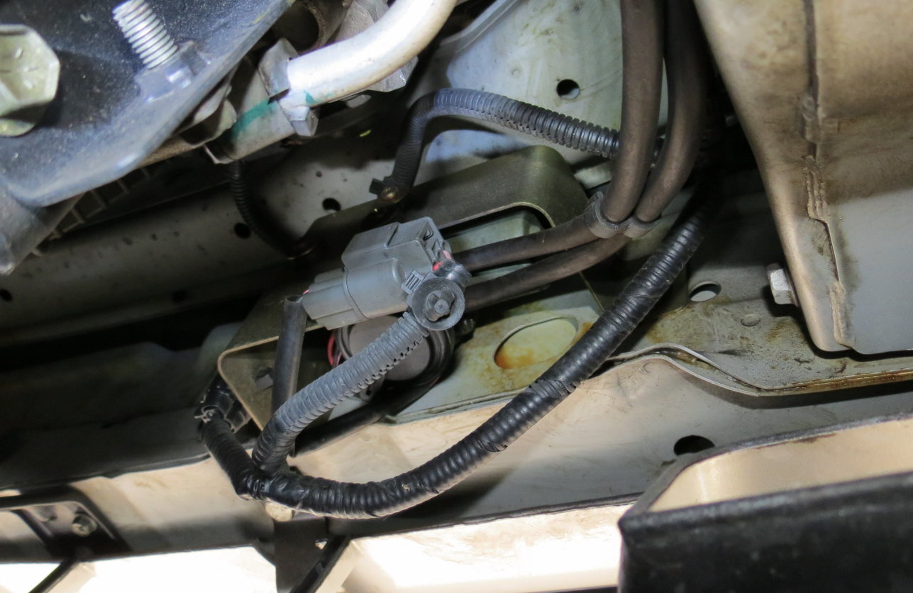

There is a pump up behind the front bumper.
I've not seen people playing in deep water in the GV's yet so can't say if there are any known problems.
