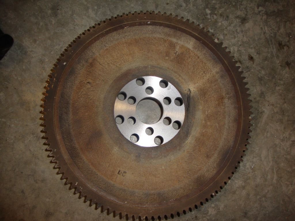

A J18 or j20 will bolt straight up to the gearbox, however you need to either source a j18 baleno flywheel or have your current flywheel machined to match the J series crank PCD.

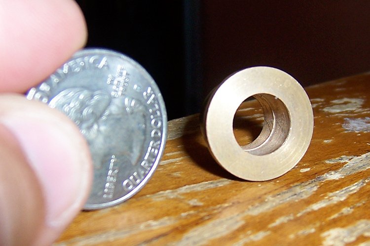

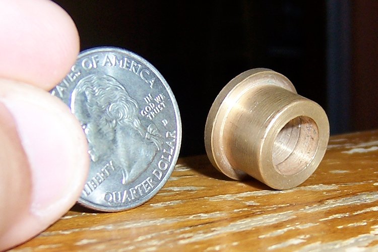

The J18 baleno flywheel is the same size as the vitara g16 flywheel but with the J series crank bolt pattern, however the spigot bearing either needs to be swapped with one to match the input shaft or a brass adapter bush made.
This is a machined g16 flywheel

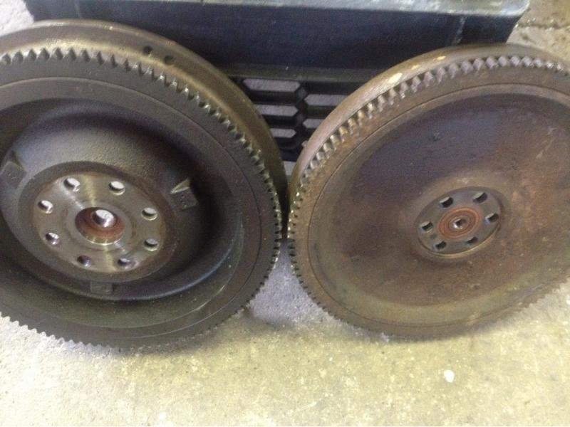

J20 GV flywheel left (too big for the 1.6 bellhousing) G16 flywheel right
